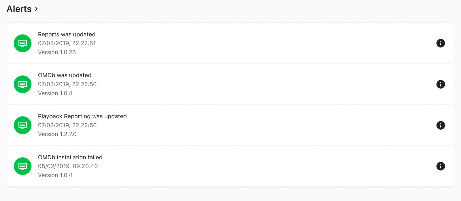

adrianwi 279 Posted February 6, 2019 Posted February 6, 2019 Any idea what might have caused this? Everything seems to be working from what I can tell.

Luke 42217 Posted February 7, 2019 Posted February 7, 2019 @@solabc16 any thoughts on this trust failure? 2019-02-05 09:20:40.214 Info HttpClient: HttpClientManager.GetTempFileResponse url: https://embydata.com/admin/service/packageFiles/OMDb.dll_1.0.4.exe 2019-02-05 09:20:40.287 Error HttpClient: Error TrustFailure getting response from *** Error Report *** Version: 4.0.1.0 Command line: /usr/local/lib/emby-server/system/EmbyServer.exe -os freebsd -ffdetect /usr/local/lib/emby-server/bin/ffdetect -ffmpeg /usr/local/lib/emby-server/bin/ffmpeg -ffprobe /usr/local/lib/emby-server/bin/ffprobe -programdata /var/db/emby-server -updatepackage emby-server-freebsd_{version}_amd64.txz Operating system: Unix 11.2.0.0 64-Bit OS: True 64-Bit Process: True User Interactive: False Mono: 5.10.1.57 (5.10.1.57 Thu Dec 6 09:41:30 UTC 2018) Processor count: 8 Program data path: /var/db/emby-server Application directory: /usr/local/lib/emby-server/system System.Net.WebException: System.Net.WebException: Error: TrustFailure (One or more errors occurred.) ---> System.AggregateException: One or more errors occurred. ---> System.Security.Authentication.AuthenticationException: A call to SSPI failed, see inner exception. ---> Mono.Btls.MonoBtlsException: Syscall error:02000018:system library:OPENSSL_internal:Too many open files at /wrkdirs/usr/ports/lang/mono/work/mono-5.10.1.57/external/boringssl/crypto/bio/file.c:225 at Mono.Btls.MonoBtlsContext.ProcessHandshake () [0x00038] in <b3922b7d60404fa9ae645f1fb97f5b6b>:0 at Mono.Net.Security.MobileAuthenticatedStream.ProcessHandshake (Mono.Net.Security.AsyncOperationStatus status) [0x0003e] in <b3922b7d60404fa9ae645f1fb97f5b6b>:0 at (wrapper remoting-invoke-with-check) Mono.Net.Security.MobileAuthenticatedStream.ProcessHandshake(Mono.Net.Security.AsyncOperationStatus) at Mono.Net.Security.AsyncHandshakeRequest.Run (Mono.Net.Security.AsyncOperationStatus status) [0x00006] in <b3922b7d60404fa9ae645f1fb97f5b6b>:0 at Mono.Net.Security.AsyncProtocolRequest+<ProcessOperation>d__24.MoveNext () [0x000ff] in <b3922b7d60404fa9ae645f1fb97f5b6b>:0 --- End of stack trace from previous location where exception was thrown --- at System.Runtime.ExceptionServices.ExceptionDispatchInfo.Throw () [0x0000c] in <0e06830de9a44394a7e366951eabca52>:0 at System.Runtime.CompilerServices.TaskAwaiter.ThrowForNonSuccess (System.Threading.Tasks.Task task) [0x0003e] in <0e06830de9a44394a7e366951eabca52>:0 at System.Runtime.CompilerServices.TaskAwaiter.HandleNonSuccessAndDebuggerNotification (System.Threading.Tasks.Task task) [0x00028] in <0e06830de9a44394a7e366951eabca52>:0 at System.Runtime.CompilerServices.TaskAwaiter.ValidateEnd (System.Threading.Tasks.Task task) [0x00008] in <0e06830de9a44394a7e366951eabca52>:0 at System.Runtime.CompilerServices.ConfiguredTaskAwaitable+ConfiguredTaskAwaiter.GetResult () [0x00000] in <0e06830de9a44394a7e366951eabca52>:0 at Mono.Net.Security.AsyncProtocolRequest+<StartOperation>d__23.MoveNext () [0x0008b] in <b3922b7d60404fa9ae645f1fb97f5b6b>:0 --- End of inner exception stack trace --- at System.Runtime.ExceptionServices.ExceptionDispatchInfo.Throw () [0x0000c] in <0e06830de9a44394a7e366951eabca52>:0 at Mono.Net.Security.MobileAuthenticatedStream+<ProcessAuthentication>d__47.MoveNext () [0x00254] in <b3922b7d60404fa9ae645f1fb97f5b6b>:0 --- End of inner exception stack trace --- at System.Threading.Tasks.Task.ThrowIfExceptional (System.Boolean includeTaskCanceledExceptions) [0x00011] in <0e06830de9a44394a7e366951eabca52>:0 at System.Threading.Tasks.Task.Wait (System.Int32 millisecondsTimeout, System.Threading.CancellationToken cancellationToken) [0x00043] in <0e06830de9a44394a7e366951eabca52>:0 at System.Threading.Tasks.Task.Wait () [0x00000] in <0e06830de9a44394a7e366951eabca52>:0 at Mono.Net.Security.MobileAuthenticatedStream.AuthenticateAsClient (System.String targetHost, System.Security.Cryptography.X509Certificates.X509CertificateCollection clientCertificates, System.Security.Authentication.SslProtocols enabledSslProtocols, System.Boolean checkCertificateRevocation) [0x0000d] in <b3922b7d60404fa9ae645f1fb97f5b6b>:0 at Mono.Net.Security.MonoTlsStream.CreateStream (System.Byte[] buffer) [0x0007b] in <b3922b7d60404fa9ae645f1fb97f5b6b>:0 at System.Net.WebConnection.CreateStream (System.Net.HttpWebRequest request) [0x00073] in <b3922b7d60404fa9ae645f1fb97f5b6b>:0 --- End of inner exception stack trace --- at System.Net.HttpWebRequest.EndGetResponse (System.IAsyncResult asyncResult) [0x00058] in <b3922b7d60404fa9ae645f1fb97f5b6b>:0 at System.Threading.Tasks.TaskFactory`1[TResult].FromAsyncCoreLogic (System.IAsyncResult iar, System.Func`2[T,TResult] endFunction, System.Action`1[T] endAction, System.Threading.Tasks.Task`1[TResult] promise, System.Boolean requiresSynchronization) [0x0000f] in <0e06830de9a44394a7e366951eabca52>:0 --- End of stack trace from previous location where exception was thrown --- at System.Runtime.ExceptionServices.ExceptionDispatchInfo.Throw () [0x0000c] in <0e06830de9a44394a7e366951eabca52>:0 at System.Runtime.CompilerServices.TaskAwaiter.ThrowForNonSuccess (System.Threading.Tasks.Task task) [0x0003e] in <0e06830de9a44394a7e366951eabca52>:0 at System.Runtime.CompilerServices.TaskAwaiter.HandleNonSuccessAndDebuggerNotification (System.Threading.Tasks.Task task) [0x00028] in <0e06830de9a44394a7e366951eabca52>:0 at System.Runtime.CompilerServices.TaskAwaiter.ValidateEnd (System.Threading.Tasks.Task task) [0x00008] in <0e06830de9a44394a7e366951eabca52>:0 at System.Runtime.CompilerServices.ConfiguredTaskAwaitable`1+ConfiguredTaskAwaiter[TResult].GetResult () [0x00000] in <0e06830de9a44394a7e366951eabca52>:0 at Emby.Server.Implementations.HttpClientManager.HttpClientManager+<GetTempFileResponse>d__25.MoveNext () [0x001e4] in <8c99ead7fd9c44cab05a9d44c2163ecc>:0 Source: mscorlib TargetSite: Void Throw() at System.Net.HttpWebRequest.EndGetResponse (System.IAsyncResult asyncResult) [0x00058] in <b3922b7d60404fa9ae645f1fb97f5b6b>:0 at System.Threading.Tasks.TaskFactory`1[TResult].FromAsyncCoreLogic (System.IAsyncResult iar, System.Func`2[T,TResult] endFunction, System.Action`1[T] endAction, System.Threading.Tasks.Task`1[TResult] promise, System.Boolean requiresSynchronization) [0x0000f] in <0e06830de9a44394a7e366951eabca52>:0 --- End of stack trace from previous location where exception was thrown --- at System.Runtime.ExceptionServices.ExceptionDispatchInfo.Throw () [0x0000c] in <0e06830de9a44394a7e366951eabca52>:0 at System.Runtime.CompilerServices.TaskAwaiter.ThrowForNonSuccess (System.Threading.Tasks.Task task) [0x0003e] in <0e06830de9a44394a7e366951eabca52>:0 at System.Runtime.CompilerServices.TaskAwaiter.HandleNonSuccessAndDebuggerNotification (System.Threading.Tasks.Task task) [0x00028] in <0e06830de9a44394a7e366951eabca52>:0 at System.Runtime.CompilerServices.TaskAwaiter.ValidateEnd (System.Threading.Tasks.Task task) [0x00008] in <0e06830de9a44394a7e366951eabca52>:0 at System.Runtime.CompilerServices.ConfiguredTaskAwaitable`1+ConfiguredTaskAwaiter[TResult].GetResult () [0x00000] in <0e06830de9a44394a7e366951eabca52>:0 at Emby.Server.Implementations.HttpClientManager.HttpClientManager+<GetTempFileResponse>d__25.MoveNext () [0x001e4] in <8c99ead7fd9c44cab05a9d44c2163ecc>:0 InnerException: System.AggregateException: One or more errors occurred. Source: mscorlib TargetSite: Void ThrowIfExceptional(Boolean) at System.Threading.Tasks.Task.ThrowIfExceptional (System.Boolean includeTaskCanceledExceptions) [0x00011] in <0e06830de9a44394a7e366951eabca52>:0 at System.Threading.Tasks.Task.Wait (System.Int32 millisecondsTimeout, System.Threading.CancellationToken cancellationToken) [0x00043] in <0e06830de9a44394a7e366951eabca52>:0 at System.Threading.Tasks.Task.Wait () [0x00000] in <0e06830de9a44394a7e366951eabca52>:0 at Mono.Net.Security.MobileAuthenticatedStream.AuthenticateAsClient (System.String targetHost, System.Security.Cryptography.X509Certificates.X509CertificateCollection clientCertificates, System.Security.Authentication.SslProtocols enabledSslProtocols, System.Boolean checkCertificateRevocation) [0x0000d] in <b3922b7d60404fa9ae645f1fb97f5b6b>:0 at Mono.Net.Security.MonoTlsStream.CreateStream (System.Byte[] buffer) [0x0007b] in <b3922b7d60404fa9ae645f1fb97f5b6b>:0 at System.Net.WebConnection.CreateStream (System.Net.HttpWebRequest request) [0x00073] in <b3922b7d60404fa9ae645f1fb97f5b6b>:0 InnerException: System.Security.Authentication.AuthenticationException: A call to SSPI failed, see inner exception. Source: mscorlib TargetSite: Void Throw() at System.Runtime.ExceptionServices.ExceptionDispatchInfo.Throw () [0x0000c] in <0e06830de9a44394a7e366951eabca52>:0 at Mono.Net.Security.MobileAuthenticatedStream+<ProcessAuthentication>d__47.MoveNext () [0x00254] in <b3922b7d60404fa9ae645f1fb97f5b6b>:0 InnerException: Mono.Btls.MonoBtlsException: Syscall error:02000018:system library:OPENSSL_internal:Too many open files at /wrkdirs/usr/ports/lang/mono/work/mono-5.10.1.57/external/boringssl/crypto/bio/file.c:225 Source: mscorlib TargetSite: Void Throw() at Mono.Btls.MonoBtlsContext.ProcessHandshake () [0x00038] in <b3922b7d60404fa9ae645f1fb97f5b6b>:0 at Mono.Net.Security.MobileAuthenticatedStream.ProcessHandshake (Mono.Net.Security.AsyncOperationStatus status) [0x0003e] in <b3922b7d60404fa9ae645f1fb97f5b6b>:0 at (wrapper remoting-invoke-with-check) Mono.Net.Security.MobileAuthenticatedStream.ProcessHandshake(Mono.Net.Security.AsyncOperationStatus) at Mono.Net.Security.AsyncHandshakeRequest.Run (Mono.Net.Security.AsyncOperationStatus status) [0x00006] in <b3922b7d60404fa9ae645f1fb97f5b6b>:0 at Mono.Net.Security.AsyncProtocolRequest+<ProcessOperation>d__24.MoveNext () [0x000ff] in <b3922b7d60404fa9ae645f1fb97f5b6b>:0 --- End of stack trace from previous location where exception was thrown --- at System.Runtime.ExceptionServices.ExceptionDispatchInfo.Throw () [0x0000c] in <0e06830de9a44394a7e366951eabca52>:0 at System.Runtime.CompilerServices.TaskAwaiter.ThrowForNonSuccess (System.Threading.Tasks.Task task) [0x0003e] in <0e06830de9a44394a7e366951eabca52>:0 at System.Runtime.CompilerServices.TaskAwaiter.HandleNonSuccessAndDebuggerNotification (System.Threading.Tasks.Task task) [0x00028] in <0e06830de9a44394a7e366951eabca52>:0 at System.Runtime.CompilerServices.TaskAwaiter.ValidateEnd (System.Threading.Tasks.Task task) [0x00008] in <0e06830de9a44394a7e366951eabca52>:0 at System.Runtime.CompilerServices.ConfiguredTaskAwaitable+ConfiguredTaskAwaiter.GetResult () [0x00000] in <0e06830de9a44394a7e366951eabca52>:0 at Mono.Net.Security.AsyncProtocolRequest+<StartOperation>d__23.MoveNext () [0x0008b] in <b3922b7d60404fa9ae645f1fb97f5b6b>:0
solabc16 379 Posted February 7, 2019 Posted February 7, 2019 Hello @ This isn't one of the typical errors we see... System.Security.Authentication.AuthenticationException: A call to SSPI failed, see inner exception. ---> Mono.Btls.MonoBtlsException: Syscall error:02000018:system library:OPENSSL_internal:Too many open files ...but I notice you're running quite an old version of Mono (5.10.1.57), is there a newer version available for FreeBSD? You could also use a tool such as 'lsof' to dig a little deeper and confirm this is genuine. Best - James

adrianwi 279 Posted February 8, 2019 Author Posted February 8, 2019 Yep, updating the jail packages seems to have removed the errors and I now get I'd just been updating emby through the 3.6 betas, and forgotten about updating the jail. Thanks
