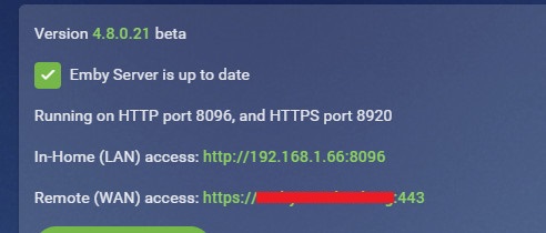

PeteLocky 22 Posted February 5, 2019 Posted February 5, 2019 so my emby server is behind a reverse proxy (this also handles the SSL stuff) so i want it like so, https://domain/emby however the thing keeps adding the port number after, https://domain/emby:xxxx and there seems to be no way to fix this in the settings ? i do NOT want the port bound to the domain, how is this achieved ? i have added a screenshot for reference

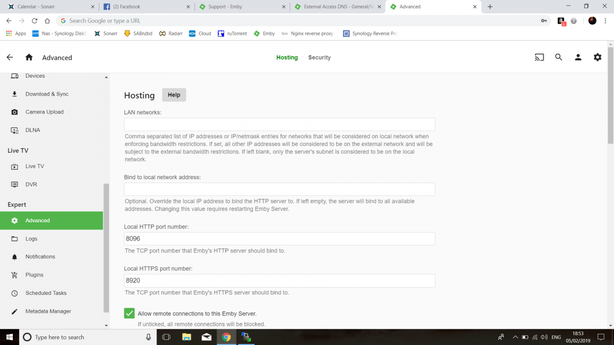

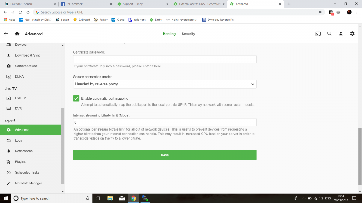

PeteLocky 22 Posted February 5, 2019 Author Posted February 5, 2019 (edited) thanks for the reply Luke, i have attached screenshots (3 of them) showing the advanced settings, cheers Edited February 5, 2019 by PeteLocky
feerlessleadr 173 Posted February 5, 2019 Posted February 5, 2019 (edited) thanks for the reply Luke, i have attached screenshots (3 of them) showing the advanced settings, cheers That second screenshot has your full domain name - might want to take that down, blank it out, and re-attach. It looks like you need to modify your public http & https port in your advanced settings to be 80 (default port for http traffic) and 443 (default port for https traffic). This way, when you go to http://yourdomain.com/emby, you will be automatically going over port 80 or 443. This also assumes that your reverse proxy is not already set up to handle this incoming traffic, which would then route to your local emby install. Edited February 5, 2019 by feerlessleadr

PeteLocky 22 Posted February 5, 2019 Author Posted February 5, 2019 (edited) no problem - I edited my post, but what happens when you go to https://yourdomain.com/emby in your browser? Does your reverse proxy route you to emby correctly? the reverse proxy is absolutely fine it is just where on the server dashboard it shows the remote wan access it auto adds the port number AFTER the dns, e.g https://domain.uk/emby:1234 i cant simply remove the wan port from the config as it will not save the page, everytime i click the wan link i have to manually remove the port number from the url bar manually go to domain.uk/emby it works fine, it is jsut annoying from within the server dash i have to keep changing the url bar Edited February 5, 2019 by PeteLocky
feerlessleadr 173 Posted February 5, 2019 Posted February 5, 2019 the reverse proxy is absolutely fine it is just where on the server dashboard it shows the remote wan access it auto adds the port number AFTER the dns, e.g https://domain.uk/emby:1234 i cant simply remove the wan port from the config as it will not save the page, everytime i click the wan link i have to manually remove the port number from the url bar manually go to domain.uk/emby it works fine, it is jsut annoying from within the server dash i have to keep changing the url bar ah ok - I don't believe you can remove it, but you can change the public http & https ports to 80 & 443 respectively, then your address on the dashboard it would be https://domain.uk/emby:443 I don't believe that you can have the port removed on the dashboard (Luke can correct me if I'm wrong there).
PeteLocky 22 Posted February 5, 2019 Author Posted February 5, 2019 ah ok - I don't believe you can remove it, but you can change the public http & https ports to 80 & 443 respectively, then your address on the dashboard it would be https://domain.uk/emby:443 I don't believe that you can have the port removed on the dashboard (Luke can correct me if I'm wrong there). if that is the case i guess it is what it is, i know it might seem so small, maybe a simple tick-box could be applied to make the wan access bit reverse proxy compatible (e.g tick the box for reverse proxy and it simply removes the port from that particular link?)

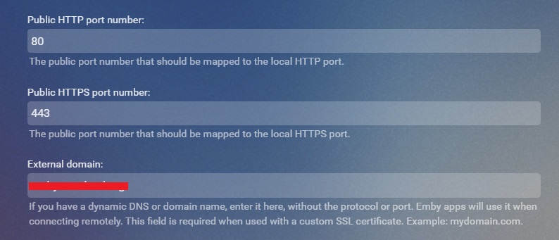

pwhodges 2024 Posted December 18, 2022 Posted December 18, 2022 (edited) 1 hour ago, Riddler84 said: I mean, you say you're using Emby's default port (8096). So, your dashboard URL must be: https://yourdomain.com:8096. Right? So you have to configure Caddy in a way, that it accepts that URL with this port, because otherwise you get an error. Wrong. Here is my dashboard: And here are the settings in Network which give that: My Caddyfile contains (for this site - there are many others) just: xxxx.xxxxxxxx.xxx { header Accept-Ranges "none" reverse_proxy http://yyyyyyy.yyyy.yyy:8096 } I can't think of anything else to say... Paul Edited December 18, 2022 by GrimReaper Hid domains
rbjtech 5335 Posted December 19, 2022 Posted December 19, 2022 Got a little lost in the thread - but as I'm sure you are aware, a reverse proxy terminates the WAN connection and forwards the request internally on whatever port you specify. Like Paul - I connect using 443 (thus no need for any port to be specified) and then nginx forwards using 8096 (http) - thus like Paul's - my dashboard WAN url says :443 after it - but it has no reason to. Note emby IS listening internally (locally/lan) on port 8920 for https - so the dashboard could be a little clearer on that imo. It's your RP that is listening on (80) 443 not emby. 1

Riddler84 54 Posted December 19, 2022 Posted December 19, 2022 20 hours ago, pwhodges said: And here are the settings in Network which give that: That's what I said above about the two solutions. You have chosen to set the public HTTPS port to 443 to make the URL that Emby is producing work. Because your screenshot clearly shows the port at the end of your remote (WAN) access URL. The one you manually set. But there is still no way to remove the port at all from the produced URL. That's the single thing I want! I'm coming from Plex and there you can just enter a remote URL, which is used by Plex, and you're done. There's no need for automatically building the URL out of 3 components. I don't really see a reason for Emby to do this, but maybe someone can explain to me, why this is a good idea. In my case and environment, it produces a URL, which is not usable, unless I change the port to 443.
pwhodges 2024 Posted December 19, 2022 Posted December 19, 2022 If you remove the port from the URL it will default to 80 or 443 for thhp/https, so having the port or not is not an issue. The issue is that Emby doesn't put it at the end of the domain, but at the end of the URL - which produces nonsense. You have the choice of waiting until the developers decide to change this (grumbling meanwhile) or simply changing your URL setup to one that works without an issue (presumably being happier when it works). Paul 1
