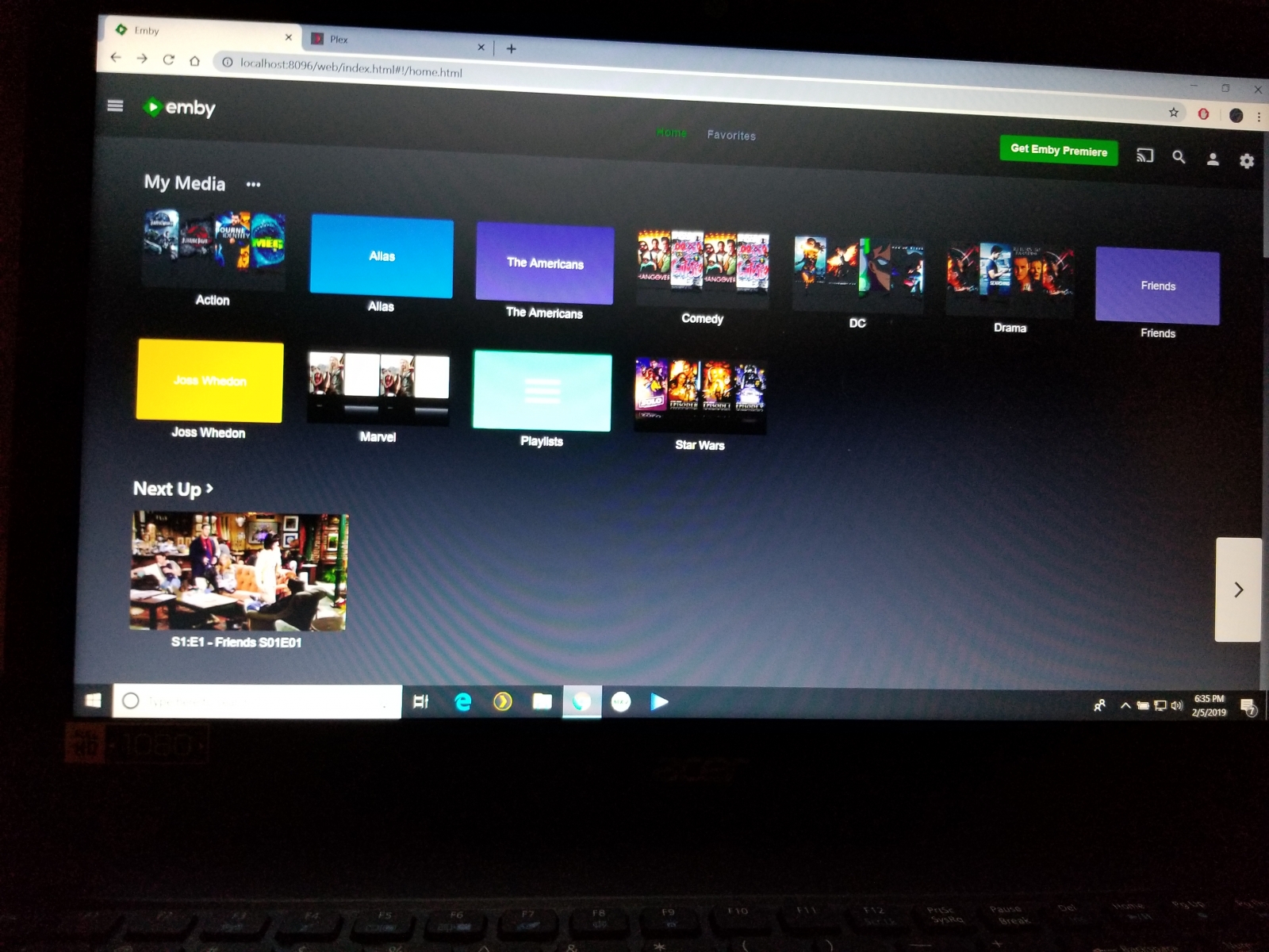

KalEl770 1 Posted February 5, 2019 Author Posted February 5, 2019 even though an episode of friends is set up to play next, I can't load any other shows and can't select which episode of friends will play. I see no listings. If I hit the 3 dots on another show to play that one, the episode of friends still plays
Happy2Play 9806 Posted February 5, 2019 Posted February 5, 2019 (edited) Look like you are adding series folders as a library path. You need to add the parent folder for the series as your library path. TV Shows (Library folder) Friends Episodes from various seasons. https://github.com/MediaBrowser/Wiki/wiki/TV-naming If this is not the case, please show a screenshot of Library folders. Edited February 5, 2019 by Happy2Play

ebr 16313 Posted February 6, 2019 Posted February 6, 2019 I assume you pointed the library to "TV Shows". Yes, that is correct Are you sure? It does look like you've pointed libraries to individual series instead of a containing parent folder. Alias, Friends, etc. should not be showing up in "My Media".

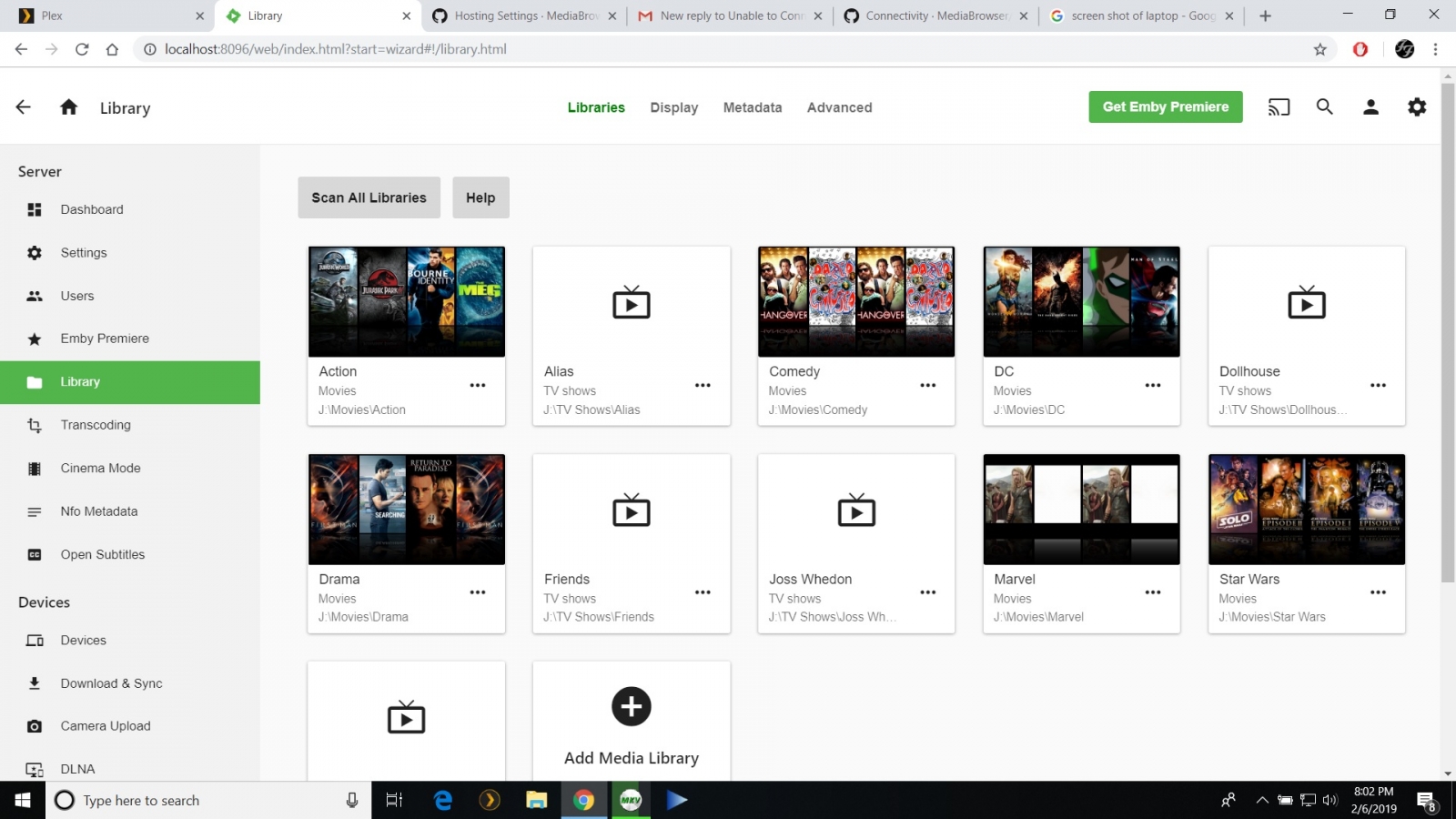

ebr 16313 Posted February 6, 2019 Posted February 6, 2019 We need to see this screen from your dashboard:

Solution Happy2Play 9806 Posted February 7, 2019 Solution Posted February 7, 2019 (edited) here is my screen shot You need to remove all the Shows libraries and point one library to "J:\TV Shows". Same with Movies, unless you want individual libraries like that. All you need is "J:\Movies". All depends on the presentation you want. Edited February 7, 2019 by Happy2Play 1
