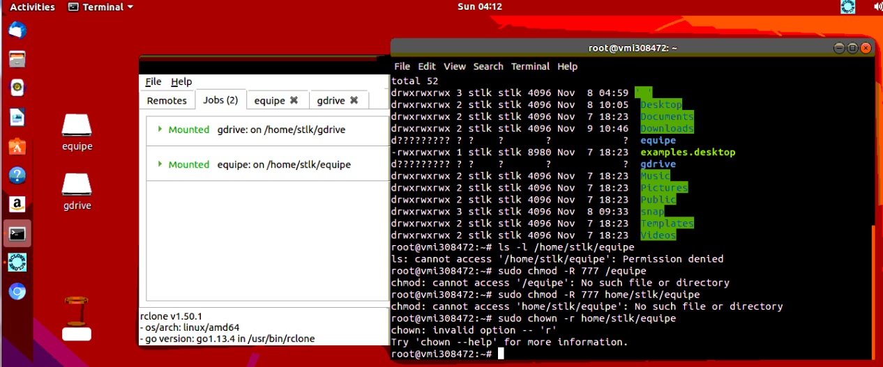

Stlk filmes 1 Posted November 10, 2019 Posted November 10, 2019 Good morning, see in this photo that the disk is mounted, and in the terminal all the commands I execute do not change anything, and why is that (d ????????) in the team folder and gdrive If you can help thank you, because of this I can not put the movies in the emby library
Luke 42246 Posted November 10, 2019 Posted November 10, 2019 Good morning, see in this photo that the disk is mounted, and in the terminal all the commands I execute do not change anything, and why is that (d ????????) in the team folder and gdrive If you can help thank you, because of this I can not put the movies in the emby library Duplicate posting: https://emby.media/community/index.php?/topic/32218-file-permissions-guide-for-new-linux-users/&do=findComment&comment=805020
