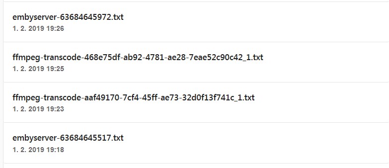

JanKol 2 Posted February 1, 2019 Author Posted February 1, 2019 Hello, here are my logs created when I attempted to play video with HW acceleration enabled. I have also enabled detailed logging. With each attempt, the new log has been created automatically. After my tests, I have rolled log file. In the picture, you can see original names of logs. First one is Log006.txt etc... I have also tried to play video from another computer in LAN but without luck. Same as on localhost. BTW, Is there any way how to download logs directly including their original filenames? Thank you in advance. Jan Log006.txt Log007.txt Log008.txt Log009.txt

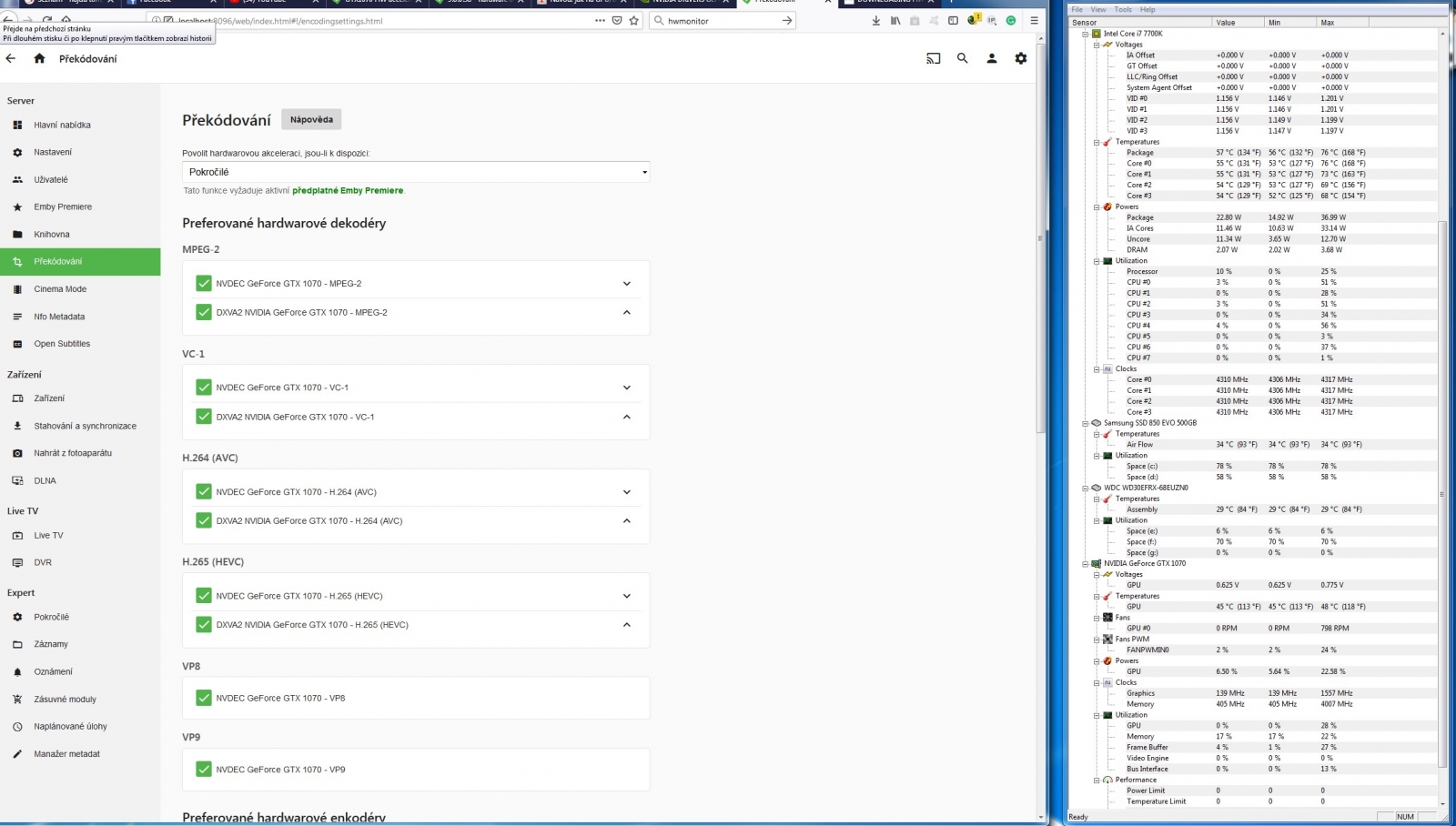

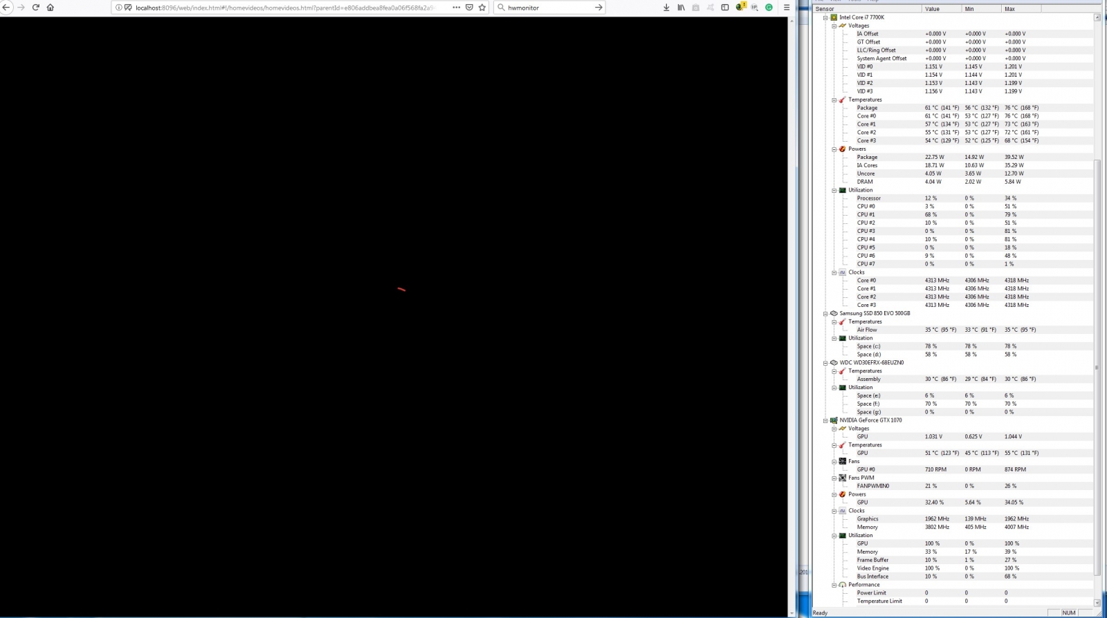

JanKol 2 Posted February 2, 2019 Author Posted February 2, 2019 (edited) Luke Posted Today, 08:15 AM Can you try installing the latest nvidia graphics drivers, and then reboot your system? Please let me know if this changes anything. thanks. Hi I have the latest drivers "GeForce Game Ready Driver" version 417.71 from 01/15/2019. I was also trying if there are any more drivers needed for HW acceleration, but I did not find anything. I downloaded monitor no monitor GPU usage during video loading and idle. I have found out there is standby usage 6%, and 30% usage when loading video. I have also trying to set priority for encoders. see pictures: NVDEC first, idle NVDEC first loading video DXVA first, idle DXVA2 first, loading video Jan Edited February 2, 2019 by JanKol
Luke 42217 Posted February 3, 2019 Posted February 3, 2019 and the ffmpeg log from the dxva attempt? thanks.
JanKol 2 Posted February 3, 2019 Author Posted February 3, 2019 and the ffmpeg log from the dxva attempt? thanks. Sorry for that I did not realize that changing priority will have an influence on logs. Original names: And logs: Log010.txt Log011.txt Log012.txt Log013.txt From my last post is visible that GPU is doing something. but I have no idea why video is not started even also few minutes. I hope this help. I was wondering if there is some general guide for HW acceleration, so I could check If I did all needed steps required for HW acceleration. Or is it only about owning GPU, latest drivers, Emby premiere and HW acceleration enabled? Thank you for your support, Jan
