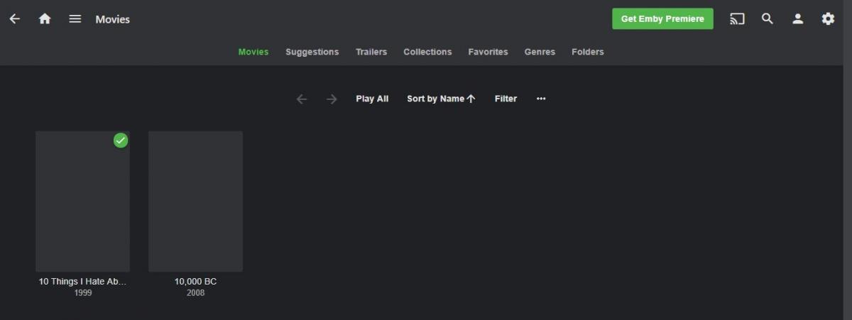

Mirage1981 0 Posted January 31, 2019 Posted January 31, 2019 Hello, I'm new to emby ... I installed emby on my Synology DS918+ I tried to add some movie to a new library, but only the meta data is downloading, not pictures so far. Anybody ideas? BR, Mirage embyLog.txt

Mirage1981 0 Posted January 31, 2019 Author Posted January 31, 2019 Hi solabc16, thanks for your answer ...I switched IPv6 off, restarted the Diskstation, created a new library, refreshed the metadata on the old one, but no change so far. Still get no pictures :-( Attached the new log file: embyLog.txt
