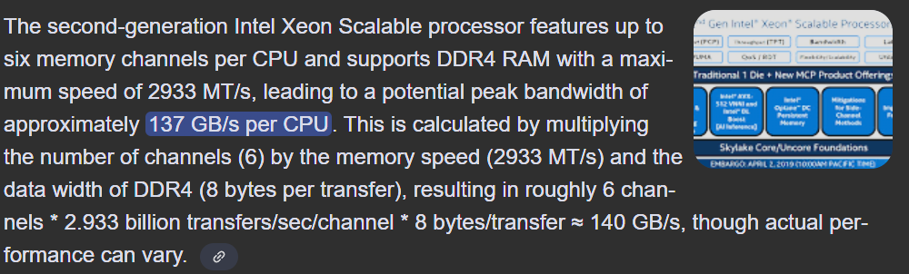

bandit8623 226 Posted September 27, 2025 Posted September 27, 2025 (edited) 14 minutes ago, softworkz said: You need to view it from a different angle: In case of heavy transcoding, the bandwidth of your memory gets often maxed out. So why do you want to add something that takes additional memory bandwidth on top of that when you could read/write the data elsewhere (a HD/SSD) which allows some part of the data take a different path than the one to memory (RAM)? on slow ram sure. 6 channel ddr4 i highly doubt is getting MAXed out. ive ran benchmarks on the ram disk its absolutley insane on speed. and cpu never jumps much at all. again though i have system with enterprise cpu ram edit 6 channels Edited September 27, 2025 by bandit8623 1
softworkz 5133 Posted September 27, 2025 Posted September 27, 2025 6 minutes ago, bandit8623 said: on slow ram sure. triple channel ddr4 i highly doubt is getting MAXed out. ive ran benchmarks on the ram disk its absolutley insane on speed. and cpu never jumps much at all. again though i have system with enterprise cpu ram It depends on your goal. When you have such a high-end system, you might be aiming to be able to do 20 simultaneous 4k HDR transcodes with subtitle burn-in (uncompressed video frames copied back and forth bertween GPU mem and system mem. The subject of this topic is that people want a smaller transcoding temp in order to use a RAM disk. But that's just nonsense. It doesn't give you any advantage - even when you have a system where it "doesn't hurt". The nature and requirement for transcoding-temp is: average performance + large size It is not: high-performance + small/average size That's the bottom line. 1
