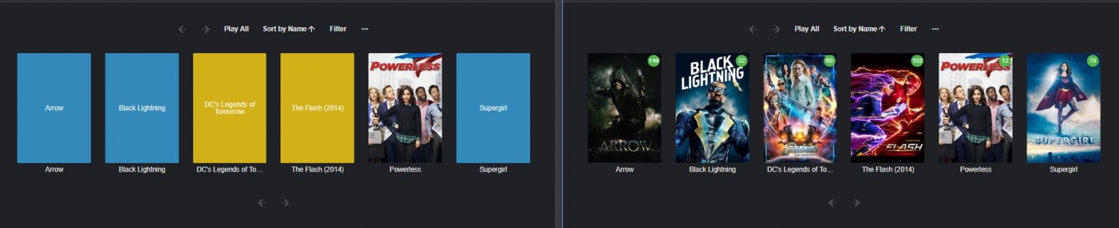

wickedlemon 6 Posted January 29, 2019 Posted January 29, 2019 I did start another post about slow scanning, but this was Raspberry Pi specific, so I though I'd post here. After installing Emby on Raspbian I discovered it was incredibly slow scanning compared to my Windows PC. In an effort to rule out the Pi, I decided to install Ubuntu on to my laptop and run Emby there too and compare. After about six hours scanning both Linux scans are slow and pretty much neck and neck. Although it lists the series, I still only have two playable scanned episodes. In desperation I wiped my Windows library. Deleted all cache, metadata and library files restarted a scan. Within 2 minutes Windows had achieved more than Linux had all day. I now have well over 300 episodes available in maybe 15 minutes. So has anyone else noticed this issue? I'd be interested if anyone else can compare Windows vs Linux scanning speed to see how it compares. All three Emby installs are set up with identical settings, running 4.0.1.0.
PenkethBoy 2068 Posted January 29, 2019 Posted January 29, 2019 Nope both work approx the same for me for the same media (copy) windows (2012r2 with i7 pooled disks) 1 min 29 secs for scan qnap (celeron raid5) 1 min 38 secs for scan This is with 4.1 beta but this is consistent with what i have seen for months I would post (attach) your logs from the scans so Luke etc can have a look as sounds like something is up Also describe you library setup and the machine hardware (windows and linux machine you used) as that could add variability More info the better - the odd screenshot would help as well
wickedlemon 6 Posted January 29, 2019 Author Posted January 29, 2019 Interesting to know. I posted lots of logs for Luke in my other post. TBH the Windows machine is faster, but not by much. Not enough for the difference shown. I think I'll install Emby on the laptop running Win8/Ubuntu dual boot and see what happens.
wickedlemon 6 Posted January 29, 2019 Author Posted January 29, 2019 (edited) Just started running a scan from my laptop under Windows 8 and it's adding stuff as fast as on my desktop, so Ubuntu and Windows on the same hardware are miles apart in scanning speed. I'll add logs once the scan has finished. Windows 8 scan finished in 4m46s. Linux still at 86.4% and doesn't even have 1 episode viewable yet. Edited January 29, 2019 by wickedlemon
wickedlemon 6 Posted January 29, 2019 Author Posted January 29, 2019 These two scans started at the same time. Linux on the left, Windows on the right.

wickedlemon 6 Posted January 29, 2019 Author Posted January 29, 2019 So one is a desktop PC and the other is Raspberry Pi? That's a pretty significant gap in horsepower, no? Hi Luke Yes one was a Pi and one a desktop. So I installed Ubuntu on my laptop and compared it against the Pi. Neck and neck. I ran Emby on Windows on my laptop and it is lightning fast. Exactly the same hardware and network connection. So no, this is not a horsepower issue. It is Windows vs Linux in my environment. Please stop with 'it's only a pi' responses. The Pi isn't even breaking a sweat when it's scanning.

wickedlemon 6 Posted January 31, 2019 Author Posted January 31, 2019 (edited) I've installed 4.1.0.5. Tried scanning again and it's still seems slow. I'll post a log up later once it's been running a bit longer. What I did try in the meantime was copying some files to a USB stick and scanning. That was really fast. 12 episodes done in seconds. So: Ubuntu > Nas = very slow Raspbian > Nas = very slow Raspbian > USB = very fast Windows 8 > Nas = fast Windows 10 > Nas = fast I have no issues copying files or playing media from the NAS on Linux devices, so what could be going on? We're not talking a bit slower but 100s of times slower. As I've mentioned earlier Kodi native library scan speeds running on Windows vs Linux are pretty similar. Edited January 31, 2019 by wickedlemon
wickedlemon 6 Posted January 31, 2019 Author Posted January 31, 2019 Progress! Decided to try mounting my box using cifs instead of nfs and it's now much much faster scanning. There's obviously still an issue with Emby as there is no speed issue using nfs mounts in the OS and nfs should in theory be quicker. I'll post up the cifs vs nfs logs later.
