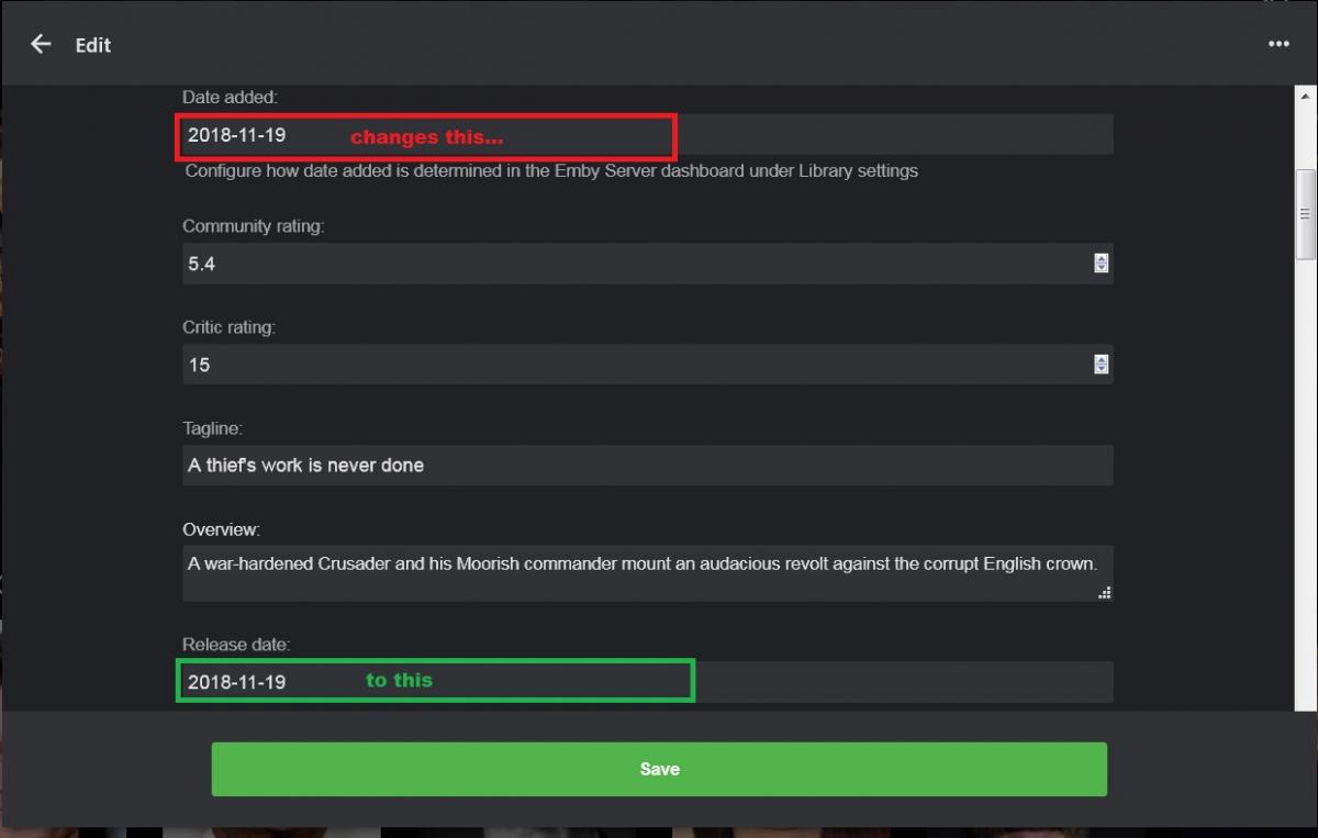

1971camaroguy 32 Posted February 7, 2019 Posted February 7, 2019 Hopping onto this post I had a question about TimeLord I have the plugin installed for movies and created the libraries (horror, comedy action) after the fact. I already have existing metadata in my media folders. Ran a scan but in the latest movies they are still showing up by date added and not the actual release date I know I am doing something wrong, but unsure. Any ideas? Thanks in advance
d00zah 152 Posted February 7, 2019 Posted February 7, 2019 Hopping onto this post I had a question about TimeLord I have the plugin installed for movies and created the libraries (horror, comedy action) after the fact. I already have existing metadata in my media folders. Ran a scan but in the latest movies they are still showing up by date added and not the actual release date I know I am doing something wrong, but unsure. Any ideas? Thanks in advance Run the last item in the 'Scheduled Tasks' list... 'Time Lord Movies'.

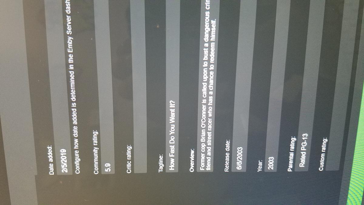

1971camaroguy 32 Posted February 7, 2019 Posted February 7, 2019 (edited) Ah ok, I checked a movie (2 fast 2 furious) and it's not modified I use Media Center Master when I rename my movie files and move them and it creates an xml document that is placed in the media folder. I wonder if that is messing with TimeLord Edited February 7, 2019 by 1971camaroguy
d00zah 152 Posted February 7, 2019 Posted February 7, 2019 (edited) Ah ok, I checked a movie (2 fast 2 furious) and it's not modified I use Media Center Master when I rename my movie files and move them and it creates an xml document that is placed in the media folder. I wonder if that is messing with TimeLord I THINK the problem may be that emby doesn't write db changes to the .xml. If it re-reads the original .xml,, the date gets reverted. I have emby configured to save metadata with media, so date changes are written to the .nfo & are consistent even if re-read. Make sense? edit: a script could be written to emulate what Time Lord does to the emby db... read the .xml & change the 'date added' field to the same value as the 'release date' field? still, use of native .nfos would be sooo much easier. Edited February 7, 2019 by d00zah

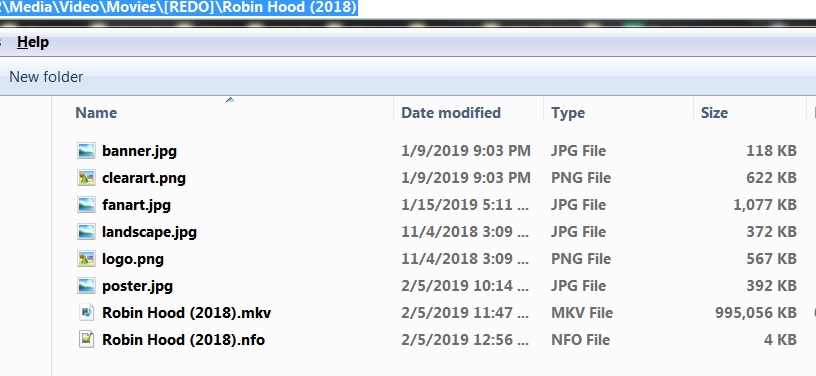

1971camaroguy 32 Posted February 7, 2019 Posted February 7, 2019 (edited) Yeah I think so, there's not any reason I need to have these XML files so I am thinking I will delete those and quit creating them with Media Center Master That will at least take that out of the picture and I can see what i have. I know emby is reading the xml first because I have made changes in the xml and the changes show up immediately in the interface Where's the setting to save metadata with media? I'm trying to comb this and I think I am overlooking it lol Edited February 7, 2019 by 1971camaroguy
d00zah 152 Posted February 7, 2019 Posted February 7, 2019 (edited) Where's the setting to save metadata with media? I'm trying to comb this and I think I am overlooking it lol It's a 'per library' setting... look for the 'Save artwork into media folders' check box in the management settings of ANY/EACH library. Sadly, it'll only do this for new additions, so you might want to NOT delete the .xmls just yet. Try this under library management: - Delete the library. - Run scan. - Re-create the library with 'Save artwork into media folders' checked. - Emby will re-scan the library, reading the existing .xmls & saving new metadata with media. - THEN, you can delete the existing .xmls & run the Time Lord scheduled task. All it takes is some time... Edited February 7, 2019 by d00zah
