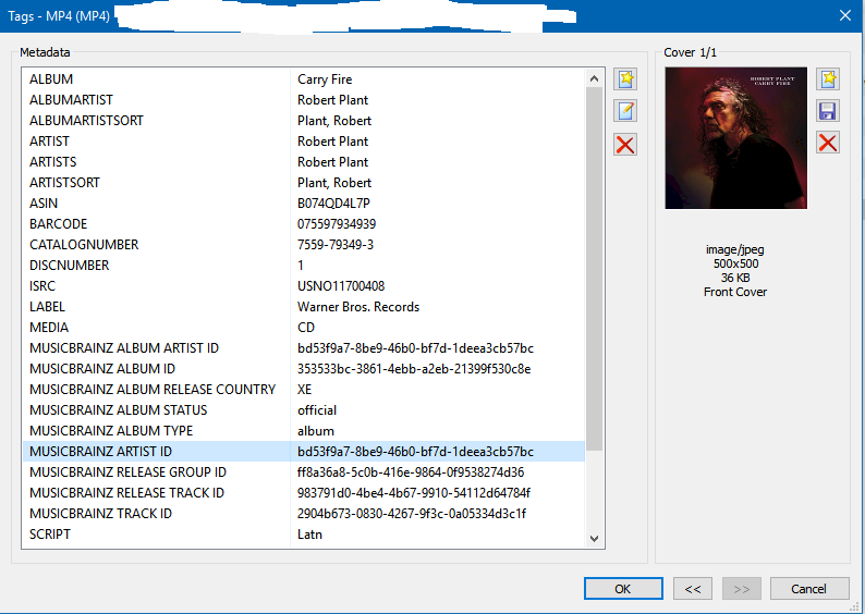

JXL2112 7 Posted February 5, 2019 Posted February 5, 2019 Had this same problem with Emby and it was additional tags that I overlooked...mp3tag has extended tags which are easy to change:

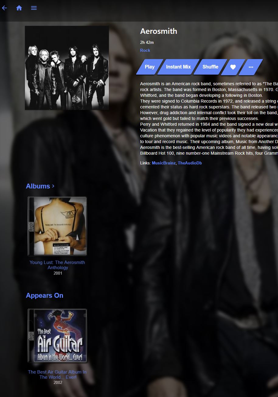

PenkethBoy 2068 Posted February 7, 2019 Posted February 7, 2019 Does do that for me As an example i have Aerosmith with an album and they appear in a compilation CD and Emby only has them once the "additional" track is shown like this - see "appears on"
TheExterminator 1 Posted February 7, 2019 Author Posted February 7, 2019 It doesn't look like that for me because in my phantom artist issue, it doesnt show any albums by the artist. Yours does
