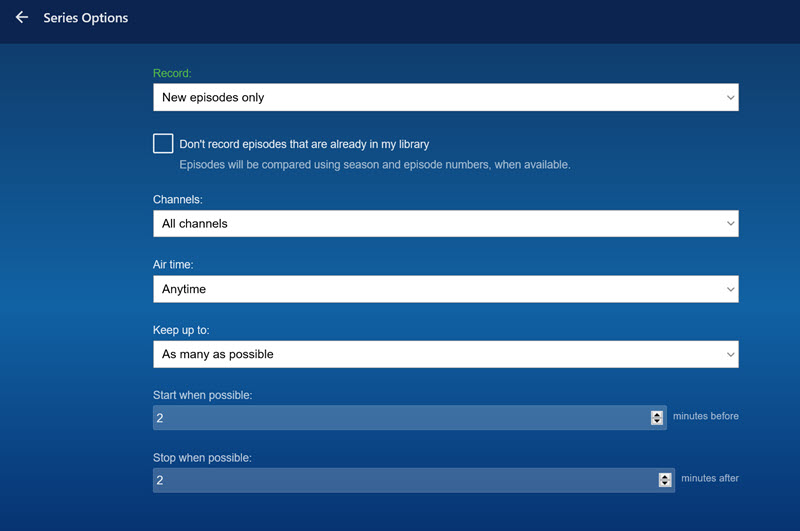

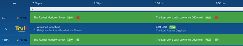

dcol 176 Posted January 26, 2019 Posted January 26, 2019 (edited) If I have multiple streams with the same shows, Emby only allows me to record one series even if I uncheck the 'Don't record episodes that are already in my library' option. You can see from the pic below that the second recording does not record. It will work setting it to record manually, but there is no way to setup that channel to record all shows (series) when you already have the same show(series) on a different channel set to record. I may want to do this for insurance in case one stream goes down. I can still get the show. Edited January 26, 2019 by dcol

Spaceboy 2573 Posted January 26, 2019 Posted January 26, 2019 In the series details there’s a drop down to choose between one specific channel and all channels. Doesn’t that work here? I haven’t tried it
dcol 176 Posted January 26, 2019 Author Posted January 26, 2019 (edited) That doesn't work either. Edited January 26, 2019 by dcol
Luke 42216 Posted January 26, 2019 Posted January 26, 2019 Right just set all channels. Just tested and this worked fine. How to report a problem. Thanks.
dcol 176 Posted January 26, 2019 Author Posted January 26, 2019 (edited) Check future recordings and you will see it didn't stick. When you initially set it, both turn red, but it is not real. Do a refresh. I tried deleting both channels, then setting one and it did not do both. Do a refresh. The second one is not set to record. And the schedule only shows one recording per show. How do I set it to record both channels automatically every day (Series)? In Live TV I have one m3u (xTeve) and one XML (Emby) Both channels are set this way embyserver.txt Edited January 26, 2019 by dcol
Luke 42216 Posted January 28, 2019 Posted January 28, 2019 They must have the exact same show id's, in which case Emby thinks they're the same program and it will not scheduled duplicates. You should be able to manually schedule them though.
