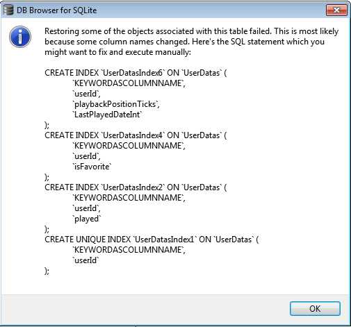

revengineer 142 Posted January 26, 2019 Posted January 26, 2019 I am working on an emby server reinstall and followed the instructions at https://github.com/MediaBrowser/Wiki/wiki/Backup to migrate the userdatas table in the database. However, the instructions are incomplete so I need extra help. When I execute the command REPLACE INTO NewDB.userdatas SELECT * FROM userdatas I get the error table NewDB.userdatas has 10 columns but 11 values were supplied: REPLACE INTO NewDB.userdatas SELECT * FROM userdatas because the old database contains a field "lastPlayedDate" of type "datetime" which is not present in the new database created by emby server v4. When I delete this field in the old database, I get the error message below. Can I ignore this message? Or do I need to do this differently? Please advise. Thank you.

revengineer 142 Posted January 26, 2019 Author Posted January 26, 2019 It might be better to migrate 3.5 to 3.5, then upgrade to 4.0 The current database is already updated to v4, and my understanding is that I can no longer go back. So this field is left over from a past migration. The database was created a few years ago, so I am not sure whether the switch to the newer field that saves the last played date occurred with the v4 release or earlier. In any case, it seems that your suggestion does no longer work.

revengineer 142 Posted January 27, 2019 Author Posted January 27, 2019 (edited) It is backed up, as I've used the plugin to restore watched status many times over the years. I completed the emby server rebuild yesterday and you are correct in that favorites and watched status is retained on restore of the backup. The library.db is now a lot smaller (100 MB vs 1 GB). So all seems well. I still do not know what I am missing by not moving the "userdatas" field from the old library. If not significant I rather leave the library as is because I am not sure about any issues arising from the deviation of the wiki procedure mentioned in the OP. @@Luke seemed to not be sure either. Edited January 27, 2019 by revengineer 1
