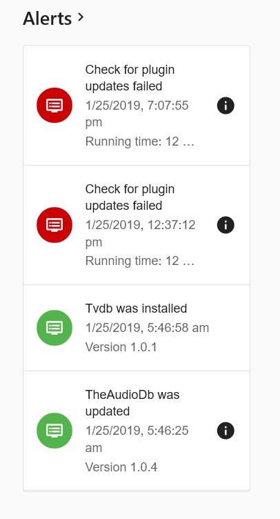

gestep48 1 Posted January 25, 2019 Posted January 25, 2019 On the dashboard, I received a Check for plugin updates failed. I only have the plugins that came with the downloaded copy of Emby. I looked at all of the plugins that came with Emby and reinstalled each one. Is there a way I can see which plugin(s) failed? Is there a way I can trigger an update manually? I am using version 4.0.1.0. Windows server 2016 Essentials. Emby is running as a service. Thanks. Gene

Luke 42219 Posted January 25, 2019 Posted January 25, 2019 It looks like outgoing http requests are failing to a variety of domains. Not just ours but metadata providers as well. Do you have security settings on the machine that might be causing this? That's what it looks like to me. Thanks.

gestep48 1 Posted February 5, 2019 Author Posted February 5, 2019 I did turn the firewall off and still received the error (yes, I did remember to turn it back on ). In looking at the windows firewall on the server, I did a couple of screen shots to see if there is anything that stands out to anyone. I will be out of state for a couple of days (driving from sunny Florida to cold, snowy Michigan) but my Emby server will be up and I will be checking in from time to time. Hopefully, someone will figure out I am having an issue with plugins. I will say that one plugin was updated yesterday but you can still see from the attachments that there are still failures. Thanks. 1

gestep48 1 Posted February 6, 2019 Author Posted February 6, 2019 So, I did have a successful plugin update on 2/4/19 (OMDb). On 2/6/19, I received the Check for plugin updates failed notice. Is there any way to see which update(s) is/are failing?
