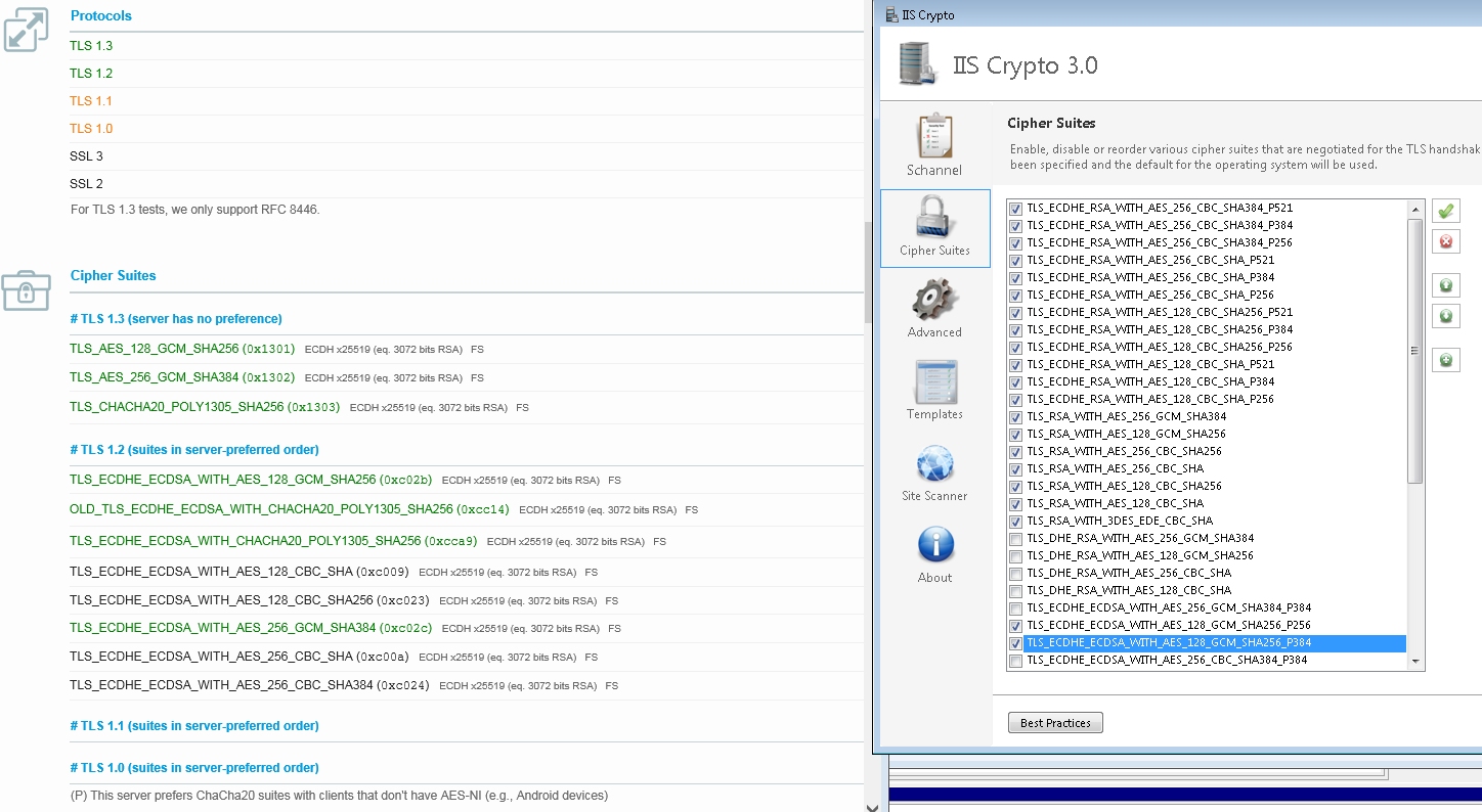

BrettDioson 5 Posted February 2, 2019 Author Posted February 2, 2019 So, I did copy the directory over to my workstation and it does appear that it works and is able to get to the plugins (which incidentally is located at https://embydata.com for those that were wondering). from the windows 2012r2 server that it is not working on, I am able to ping both addresses that are tied to that dns record successfully so it's not firewall. When I try to browse to https://embydata.com from my workstation (which is where I copied the files to and it worked from) I am able to get the embydata splash page. When I try to browse to https:///embydata.com from the server I get this TLS error message: This page can’t be displayed Turn on TLS 1.0, TLS 1.1, and TLS 1.2 in Advanced settings and try connecting to again. If this error persists, it is possible that this site uses an unsupported protocol or cipher suite such as RC4 (link for the details), which is not considered secure. Please contact your site administrator. Anyone have any idea what kind of setting on windows server would cause this problem? It's not looking like an issue with Emby at this point, but I'm wondering if there is some setting with the SSL connection to the hosted site my server just doesn't seem to like. Is there some sort of restrictive settings in some .net configuration I would need to look at? (by the way I was able to copy the MBBackup.dll from the workstation to the server and my backups seem to be working again so thanks for the idea of testing that) 1

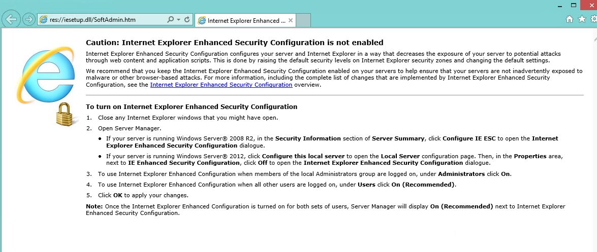

PenkethBoy 2068 Posted February 2, 2019 Posted February 2, 2019 Have you got Internet Explorer Enhanced Security On or Off? Its the first thing I turn off on 2012r2
BrettDioson 5 Posted February 3, 2019 Author Posted February 3, 2019 I've tried it both on and off with no difference between the two. I've also added https://embydata.com as a trusted site but get the same error.
Solution Triton57 1 Posted February 15, 2019 Solution Posted February 15, 2019 (edited) So, I did copy the directory over to my workstation and it does appear that it works and is able to get to the plugins (which incidentally is located at https://embydata.com for those that were wondering). from the windows 2012r2 server that it is not working on, I am able to ping both addresses that are tied to that dns record successfully so it's not firewall. When I try to browse to https://embydata.com from my workstation (which is where I copied the files to and it worked from) I am able to get the embydata splash page. When I try to browse to https:///embydata.com from the server I get this TLS error message: This page can’t be displayed Turn on TLS 1.0, TLS 1.1, and TLS 1.2 in Advanced settings and try connecting to again. If this error persists, it is possible that this site uses an unsupported protocol or cipher suite such as RC4 (link for the details), which is not considered secure. Please contact your site administrator. Anyone have any idea what kind of setting on windows server would cause this problem? It's not looking like an issue with Emby at this point, but I'm wondering if there is some setting with the SSL connection to the hosted site my server just doesn't seem to like. Is there some sort of restrictive settings in some .net configuration I would need to look at? Finally! Brett, your post pointed me in the right direction and I was able to resolve my issue. The key was having the right address to check on the Qualys site to get the list of cipher suites used by their web server. As it turns out, it's pretty restrictive and my 2008 R2 server (yes I need to upgrade) was not configured with any of the matching cipher suites. To resolve the issue, I downloaded IIS Crypto to my server and ran the GUI version to see what cipher suites were in use on my server. That's the simplest way to add the appropriate cipher suites. As it turns out, none of the ones the website used were listed on my server. This isn't surprising on a 2008 R2 server and apparently not on 2012 R2 either. Anyway, if the server and client don't have matching cipher suites enabled, you'll get the error you were getting to turn on TLS because it can't negotiate with the server. If you look at the results for the the server under cipher suites you'll see in green the ones you want to enable. You only need one that matches, but I picked a couple. This requires a reboot of the server for the new cipher suites to become active. Once I rebooted, my plugins all updated like a charm and I no longer was getting SSL errors. Hope this helps anyone else running into this issue. Edited February 15, 2019 by Triton57 1
BrettDioson 5 Posted February 16, 2019 Author Posted February 16, 2019 Finally! Brett, your post pointed me in the right direction and I was able to resolve my issue. The key was having the right address to check on the Qualys site to get the list of cipher suites used by their web server. As it turns out, it's pretty restrictive and my 2008 R2 server (yes I need to upgrade) was not configured with any of the matching cipher suites. To resolve the issue, I downloaded IIS Crypto to my server and ran the GUI version to see what cipher suites were in use on my server. That's the simplest way to add the appropriate cipher suites. As it turns out, none of the ones the website used were listed on my server. This isn't surprising on a 2008 R2 server and apparently not on 2012 R2 either. Anyway, if the server and client don't have matching cipher suites enabled, you'll get the error you were getting to turn on TLS because it can't negotiate with the server. If you look at the results for the the server under cipher suites you'll see in green the ones you want to enable. You only need one that matches, but I picked a couple. This requires a reboot of the server for the new cipher suites to become active. Once I rebooted, my plugins all updated like a charm and I no longer was getting SSL errors. Hope this helps anyone else running into this issue. Dude, you are awesome. just used this and it fixed the issue of Emby connecting to get the plugins. All my plugins are now up to date. FYI I clicked on "Best Practices" on the utility and bumped the TLS_ECDHE_ECDSA_WITH_AES_128_GCM_SHA256 cyphers to the top of the list. After reboot Emby seems to be working to get the plugins. Well done!
Triton57 1 Posted February 16, 2019 Posted February 16, 2019 Dude, you are awesome. just used this and it fixed the issue of Emby connecting to get the plugins. All my plugins are now up to date. FYI I clicked on "Best Practices" on the utility and bumped the TLS_ECDHE_ECDSA_WITH_AES_128_GCM_SHA256 cyphers to the top of the list. After reboot Emby seems to be working to get the plugins. Well done! Awesome! Glad that fixed it for you too, it's been frustrating me for a while now.
