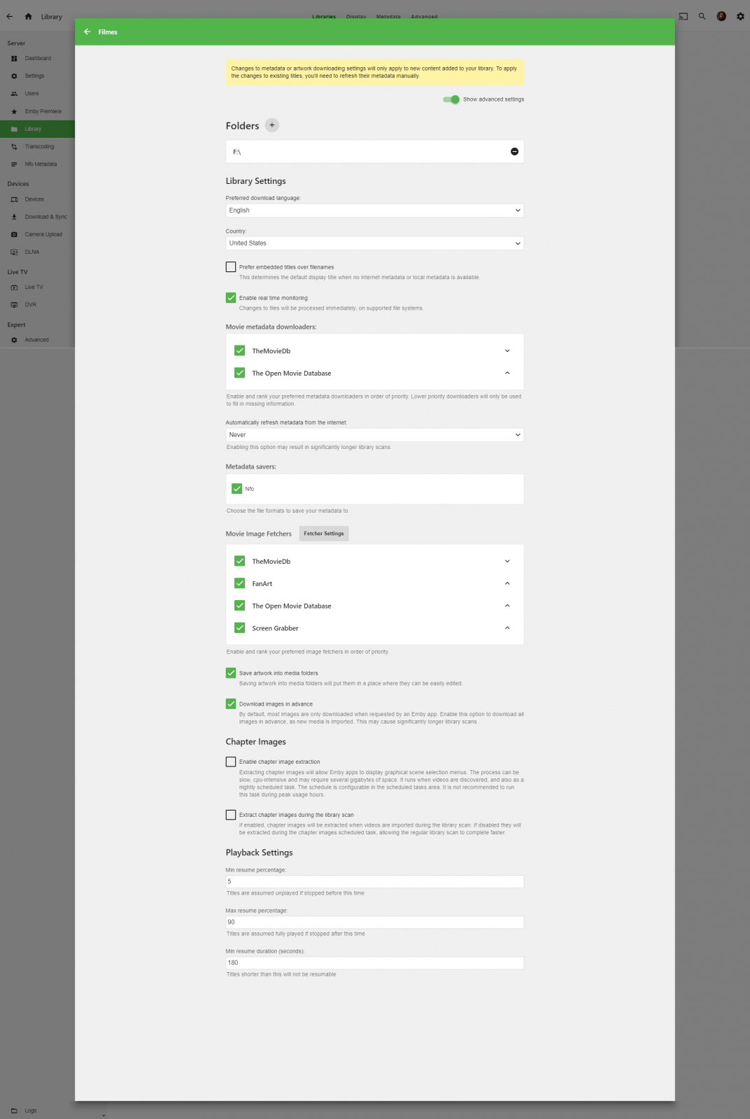

bernardotraad 0 Posted January 25, 2019 Posted January 25, 2019 Hello, I'm using Emby Server v4.0.1.0 on Windows 10 x64, and after the last update I've added a new movie to my library: Bohemian Rhapsody (2018) The folder structure is: F:\Bohemian Rhapsody (2018) [1080p]\ And the files are: Bohemian Rhapsody (2018).mp4 Bohemian Rhapsody (2018).srt All my movies on the library are like the example above, and it always worked fine. But this movie is not detected and the nfo and image files are not downloaded. My settings for the library are in the screenshot. If you need more info, please let me know. Thanks
