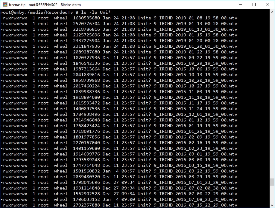

eraser8 55 Posted January 27, 2019 Author Posted January 27, 2019 (edited) Here is a screenshot in my bitvise console. As you can see, the first 7 episode don't have the "é" because I manually renamed them and those now appear in emby. Thanks Edited January 27, 2019 by eraser8
ebr 16314 Posted January 27, 2019 Posted January 27, 2019 Based on how it is displaying there, it doesn't look like your OS supports that character. I think if you can get the OS showing the file name properly, Emby will work too.
eraser8 55 Posted January 27, 2019 Author Posted January 27, 2019 Based on how it is displaying there, it doesn't look like your OS supports that character. I think if you can get the OS showing the file name properly, Emby will work too. Thanks EBR, I'm currently running FREENAS. Is there a way to do that?

eraser8 55 Posted January 29, 2019 Author Posted January 29, 2019 Hi Makarai, Here is what I got using locale command in my Freenas root@freenas[...cage/jails/emby/root/media/RecordedTv]# locale LANG=en_US.UTF-8 LC_CTYPE="en_US.UTF-8" LC_COLLATE="en_US.UTF-8" LC_TIME="en_US.UTF-8" LC_NUMERIC="en_US.UTF-8" LC_MONETARY="en_US.UTF-8" LC_MESSAGES="en_US.UTF-8" LC_ALL= root@freenas[...cage/jails/emby/root/media/RecordedTv]# And now, I attached a screenshot of when I do a ls -la.... same result here. the "é" is not displayed correctly

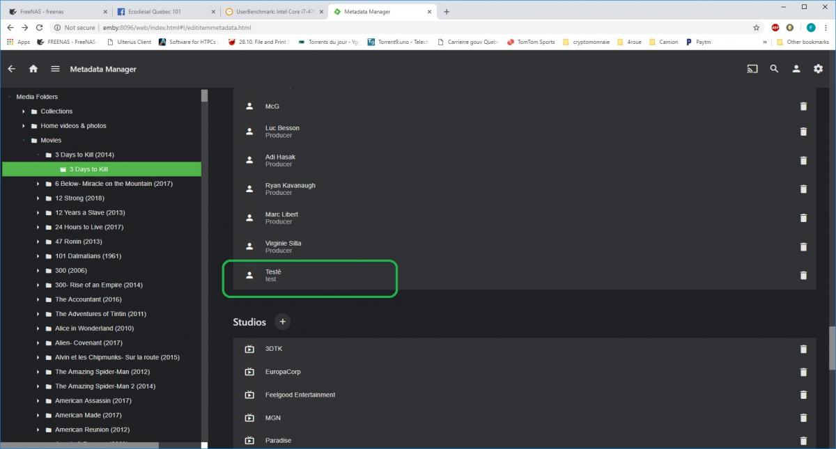

Luke 42221 Posted January 30, 2019 Posted January 30, 2019 Are you able to create actor names using these characters?
eraser8 55 Posted January 30, 2019 Author Posted January 30, 2019 Are you able to create actor names using these characters? Hi Luke, Apparently, yes!
ebr 16314 Posted January 30, 2019 Posted January 30, 2019 Does that actor show up properly in the interface? Can you supply an image for them?
eraser8 55 Posted January 30, 2019 Author Posted January 30, 2019 (edited) Does that actor show up properly in the interface? Can you supply an image for them? Hi EBR, I was not able to find the the actor I added in the cast & crew list. But, if it can help, I found an already existing person with a special character "Sébastien Inizan" in the cast and crew and I was able to add picture to it. EDIT: Sorry, I think I did mistake by not clicking on savong button. Finally, yes, I can see my new actor with special character and also I can add a photo to it. Edited January 30, 2019 by eraser8
