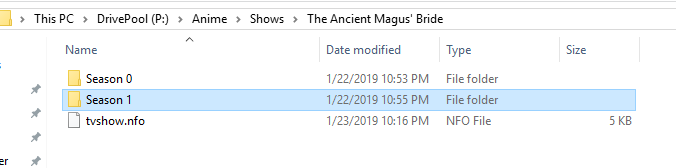

Luke 42289 Posted January 24, 2019 Posted January 24, 2019 Hi there, can you show us what the folder structure looks like? thanks.
Luke 42289 Posted January 24, 2019 Posted January 24, 2019 And how did you set it up in emby library setup?

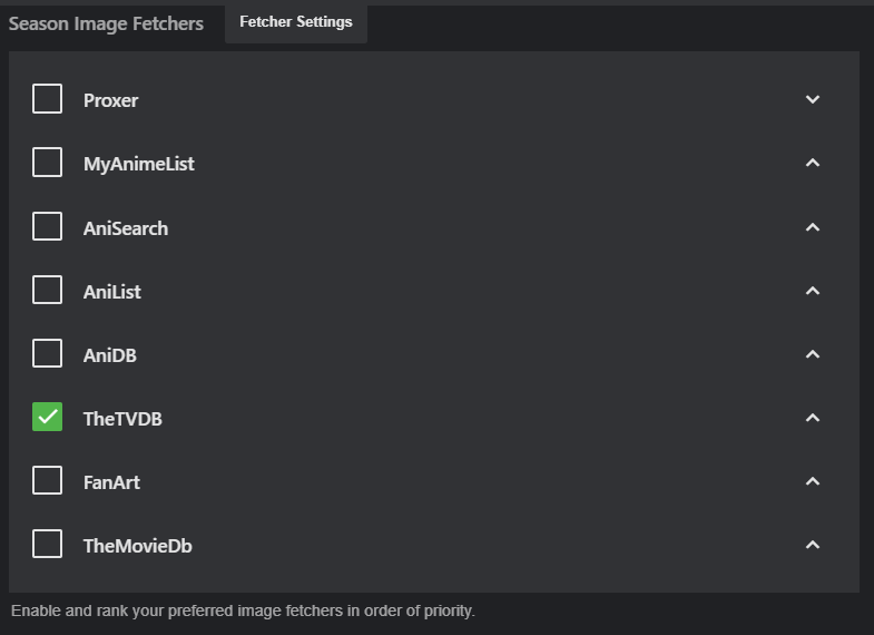

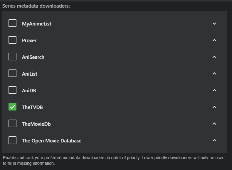

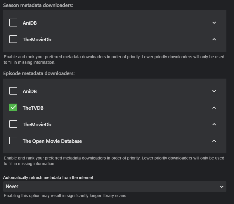

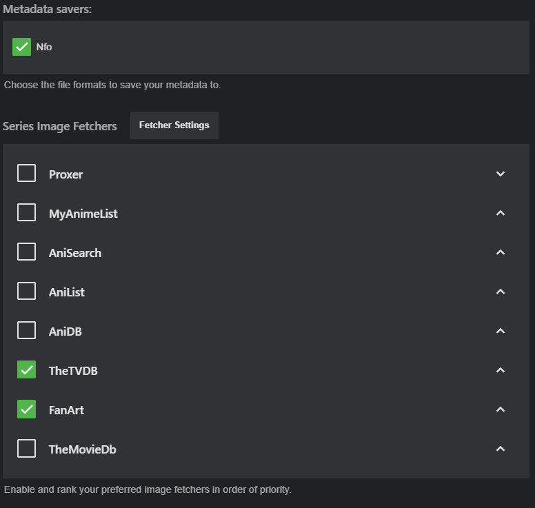

hstamas 180 Posted February 10, 2019 Posted February 10, 2019 (edited) This just happened to me as well. I re-identified a series because one of the episodes was not picking up what the TVDB listed thinking it would refresh the series and now I have no season identifiers. Mines a bit different as I have season thumbnails but no season labels. If I browse into one of the unidentified seasoned and hit the 3 dots and go to edit metadata, the correct season IS listed there. Here’s what my metadata manager looks like. Edited February 10, 2019 by hstamas

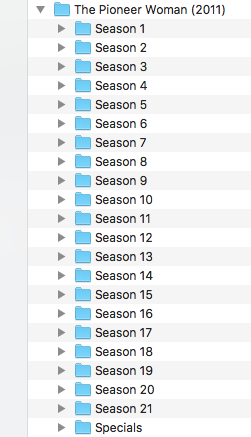

Luke 42289 Posted February 11, 2019 Posted February 11, 2019 This just happened to me as well. I re-identified a series because one of the episodes was not picking up what the TVDB listed thinking it would refresh the series and now I have no season identifiers. Mines a bit different as I have season thumbnails but no season labels. If I browse into one of the unidentified seasoned and hit the 3 dots and go to edit metadata, the correct season IS listed there. Here’s what my metadata manager looks like. Hi, what is the folder structure of this?
hstamas 180 Posted February 11, 2019 Posted February 11, 2019 Hi, what is the folder structure of this? Folder structure is per the guidelines for sure @@Luke. It was fine before I did the identify. I just ended up removing the series, moving the actual folder to somewhere not scanned by Emby, updating then putting it back in and let Emby scan again and the season labels were restored. Just in case it helps here is my folder structure:
hstamas 180 Posted February 13, 2019 Posted February 13, 2019 What did you Identify it as? I filled in the show name - release year and TVDB number. It identified it correctly but I lost all the season numbers. Just doing a rescan as mentioned above fixed it.
