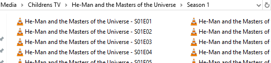

scarfoots 0 Posted January 22, 2019 Posted January 22, 2019 (edited) I have my tv shows added to my emby server, and have scanned and re scanned for meta data. It finds the show, the cover art and the episode count which are all correct, but no seasons. if i open the shop I have only the option to play one episode and nothing else even though it sees all the episodes in the library view. I had similar problems with my anime directory and solved it by renaming all my files to this file structure, but it does not seem to be the case with regular tv shows. most of my series in television are suffering from this issue. here are some views for clarification here is the poster showing 130 episodes available As you can see there is only 1 episode available to play and no Seasons My file structure Edited January 23, 2019 by scarfoots

Luke 42216 Posted January 23, 2019 Posted January 23, 2019 Can you show a screenshot of the Childrens TV folder? Thanks.

scarfoots 0 Posted January 23, 2019 Author Posted January 23, 2019 (edited) Here is a complete directory tree. I have also since enabled all metadata services and still have the same results. 19 out of the 25 in this directory no not have seasons, but all of them have the proper episode count. The same goes for my other TV directory but i am focusing on this one due to its small size. i appreciate your help I would prefer not to post the contents of the children's TV folder, but as you can see in the address bar of the following screenshot all of the media is place in folders of the series name. Edited January 23, 2019 by scarfoots

Luke 42216 Posted January 23, 2019 Posted January 23, 2019 We can't see the contents of the Children's TV folder? You can always PM it to me. Thanks.
