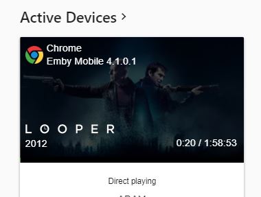

evilmatchbox 0 Posted January 22, 2019 Author Posted January 22, 2019 (edited) I don't know if this is helpful, but while trying to show a buddy at work who has a little knowledge of linux, I noticed in the server manager it is showing that the stream is playing however, all I still get is the spinning logo. Ive noticed the playtime on the server manager will count me as viewing from 0 to around 15 to 20 seconds. Then it will start over again at 0 like im constantly restarting the stream. It will eventually stop after 2-5 minutes in and report: Playback Error: No compatible streams are currently available. Please try again later or contact your system administrator for details Edited January 22, 2019 by evilmatchbox

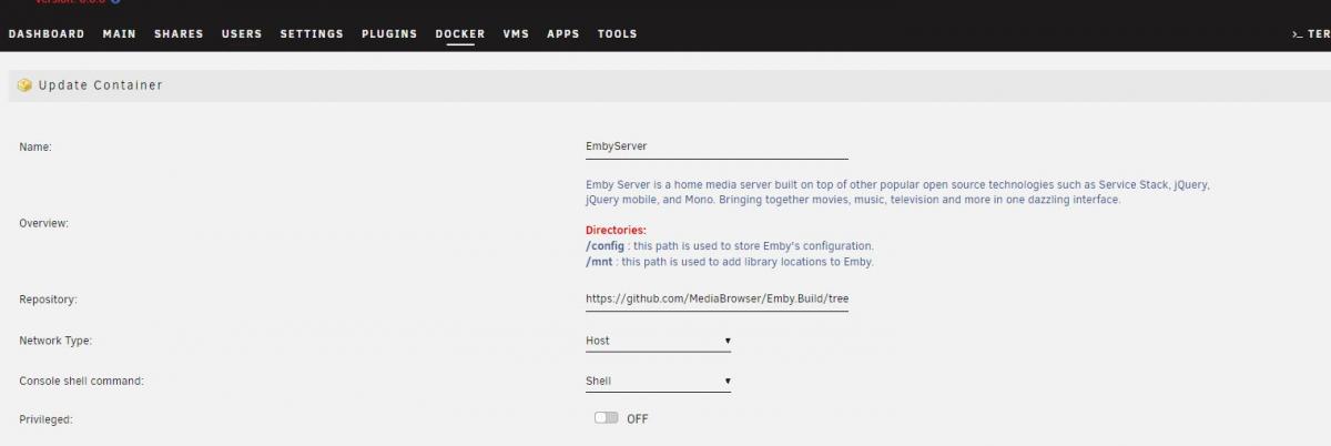

evilmatchbox 0 Posted January 23, 2019 Author Posted January 23, 2019 Hi, could this be the problem? System.IO.DirectoryNotFoundException: Could not find a part of the path '/mnt/TV Shows'. Is this mount just no longer available? Good call, I was sure i checked, but apparently after trying to update host path 2 was set to /mnt instead of /mnt/user/Media. Forgot to change it back from after my failed upgrade.
evilmatchbox 0 Posted January 23, 2019 Author Posted January 23, 2019 I just wanted to say thanks Luke. After getting some sleep, I tried Putty into the server and running docker pull emby/embyserver:latest. Ran like a charm. As stated I don't know much about unraid,linux, or emby... yet. But i think I was having some sort of permissions issue. I guess since with putty I am forced to login with credentials I was finally able to run the pull the update. That's my best guess at least.
