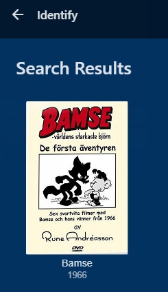

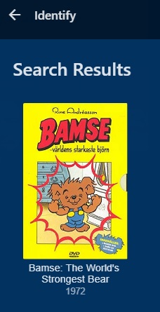

Ametz 9 Posted January 18, 2019 Posted January 18, 2019 (edited) Sometimes i have a reaaly hard time to identify with imdb. But this time i can't identify with anyone on a mixed content. I want to identify with this instead:https://www.imdb.com/title/tt0235912/?ref_=ttep_ep_tt But it identifies with this instead: https://www.imdb.com/title/tt1309085/ And it should identify with this:https://www.themoviedb.org/tv/55645-bamse-the-world-strongest-bear?language=en-US But finds only this: https://www.themoviedb.org/tv/82011-bamse?language=en-US So when i try to fix it by running identify i get zero results, i have tested: * imdb id * imdb id + name * imdb id + name + date * themoviedb * themoviedb + name * themoviedb + name + date And a mix of both above like: * themoviedb + name + date + imdb id + name etc No results at all. Edited January 19, 2019 by Ametz
Happy2Play 9806 Posted January 19, 2019 Posted January 19, 2019 (edited) Please post a server log.What metadata downloaders do you have enabled for the library?I entered imdbid "tt0235912" and got this. tt1309085 Sorry yes this appears to be a issue in Mixed Content. Edited January 19, 2019 by Happy2Play

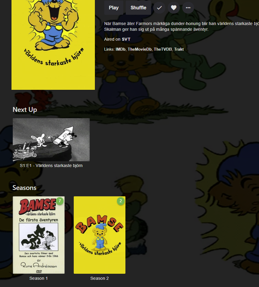

Ametz 9 Posted January 19, 2019 Author Posted January 19, 2019 (edited) Yes i got that one too, on some search, but then the season's is still wrong. All meta downloaders is enabled Season 1 is still wrong after that identify: Edited January 19, 2019 by Ametz
