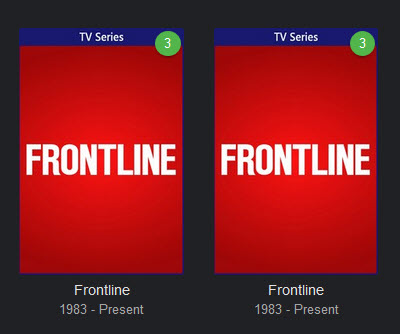

kevinw 8 Posted January 18, 2019 Posted January 18, 2019 Will Emby cope with a TV series spread across more than one folder? It obviously handles individual season folders but I'm asking about different root folders. The reason I'm asking is I have two roots - one holding programmes I want to keep and the other has programmes that can be deleted after watching. Very occasionally programmes from a series can be in either root and I'm asking the question as it doesn't seem to be working - the single episode in the Keep folder (...Keep\TV Series Name) is mis-identifed and I can't seem to persuade Emby to identify it correctly; the non-keep folder of the series has been correctly identified. Thanks. Kevin

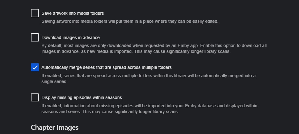

Solution Luke 42203 Posted January 18, 2019 Solution Posted January 18, 2019 Hi, yes, if they are in the same Emby library they will be joined together. 2
blade005 185 Posted January 18, 2019 Posted January 18, 2019 (edited) Will Emby cope with a TV series spread across more than one folder? It obviously handles individual season folders but I'm asking about different root folders. The reason I'm asking is I have two roots - one holding programmes I want to keep and the other has programmes that can be deleted after watching. Very occasionally programmes from a series can be in either root and I'm asking the question as it doesn't seem to be working - the single episode in the Keep folder (...Keep\TV Series Name) is mis-identifed and I can't seem to persuade Emby to identify it correctly; the non-keep folder of the series has been correctly identified. Thanks. Kevin I don't know if the option to MERGE TV series is on by default in the library settings, but perhaps yours was turned OFF at some point. If both root folders are included in your LIBRARY you can enable this option by going to into the EMBY DASHBOARD and select LIBRARY and then click the 3-Dot selection for the LIBRARY you want to manage and select MANAGE LIBRARY. Once in the LIBRARY select SHOW ADVANCED SETTINGS. Scroll down and you should find an option to AUTOMATICALLY MERGE SERIES THAT ARE SPREAD ACROSS MULTIPLE FOLDERS. It might take awhile for the MERGE to show up in your library and you may need to scan the library after the change. Edited January 18, 2019 by blade005 1
kevinw 8 Posted January 18, 2019 Author Posted January 18, 2019 (edited) I ought to have mentioned this is a Mixed Content library. I've just set another library up using the same folders with type TV Shows and it exhibits similar behaviour except it no longer displays anything that isn't a TV series, including the TV episode in the Keep root. Part of the problem may be that Emby decided the single episode in the Keep root is a DVD so when I try to identify it there's no option to give it a TVDB id. I don't know why it's been identified like that as the folder structure and naming is exactly the same format as that in the Not Keep structure. I've searched through the settings, including the Metadata Manager, and I can't see any way to tell Emby that it's a TV series. Is it possible? (I have the reverse problem with at least one other which has been identified as a TV series when it is in fact a DVD documentary). [later] I tried copying the tvshow.nfo file from the folder that had been identified as a TV show to the one I hadn't. Rescanned and now they've both been identified as a TV show. In the TV Shows version of the library the show is being displayed correctly - the two folders have been correctly merged. In the Mixed Content version I see what's in the attached screen grab which is a bit peculiar; both show the merged content. I'm reminded of what you said to me in another topic Luke - "The mixed content type has some limitations. I would suggest using one of the dedicated types.". I think that's a real shame as the availability of Mixed Content libraries is a definite advantage over Plex. That begs another question (sorry, I really like Emby but the deeper I get into it the more questions I seem to have) - is it possible to get Emby to display content that isn't a TV show in a library set up for TV shows? (Thanks for the suggestion blade005. I did look for the Merge Series option in the settings for both the Mixed Content and TV Shows versions of the library, just in case, but couldn't see it there at all even with Advanced Options selected.) Kevin Edited January 19, 2019 by kevinw
Happy2Play 9802 Posted January 19, 2019 Posted January 19, 2019 @@kevinw Mixed content does not have this option but TV Shows does. 1
kevinw 8 Posted January 19, 2019 Author Posted January 19, 2019 Got it thanks. I've no idea how I didn't see that before but I can't miss it now you've shown me where it is! Kevin

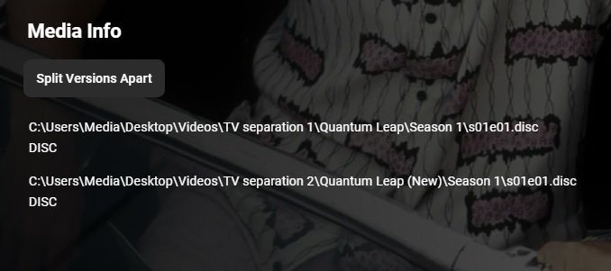

Happy2Play 9802 Posted April 10, 2021 Posted April 10, 2021 I can do more testing but have no issue with seriename and seriesname (new) being merged properly. I used different paths but get the same results using different drives. Each season on different drives/folders get show for the Series also. If you are having issues then can you go over specific steps to reproduce the issue. Images always help understand the issue also.

Luke 42203 Posted April 12, 2021 Posted April 12, 2021 They get merged when the external ids of the series are the same, and the metadata language value of the series are the same.
