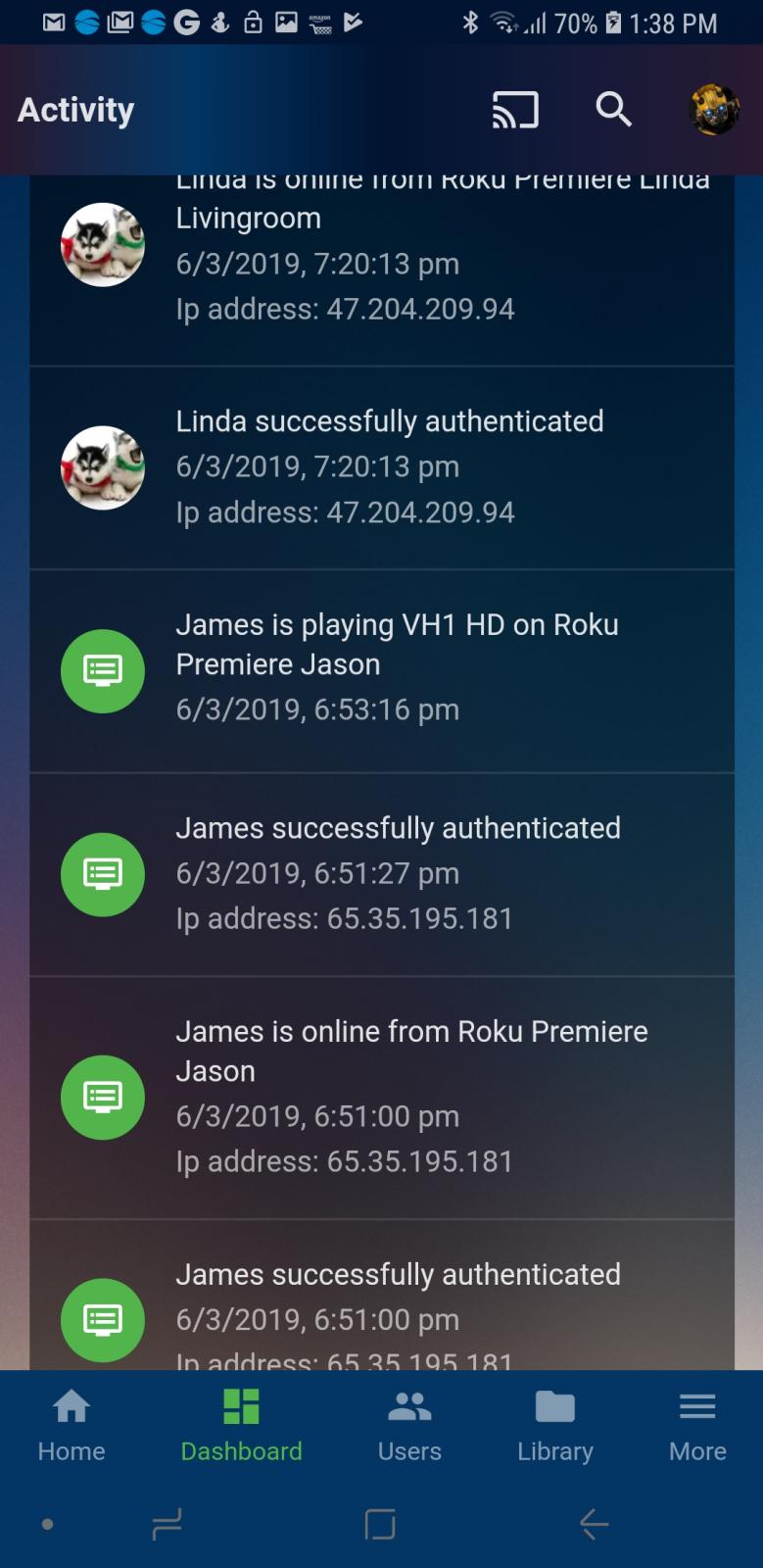

Jason'sEmby 29 Posted June 4, 2019 Posted June 4, 2019 Hi @@Luke I'm also having a tuner release issue on remote Roku users. The user according to activity started playing on VH1 on 6/3 at 6:53pm. It shows activity but there was no log created. Then on 6/4 at at 8:18am James finished and then again at 8:28am. There was no logs generated on any of those. But it kept the tuner locked until I unplugged the hdhomerun Prime and plugged it back in at 1pm on 6/4. Also by the way thank you Emby team for the beta update today:).
ebr 16314 Posted June 4, 2019 Posted June 4, 2019 Hi. Are you sure the user(s) stopped playing live TV? Or did they, perhaps, just turn off the TV? 1
Jason'sEmby 29 Posted June 4, 2019 Posted June 4, 2019 I have it set up to where if they turn the TV off it Powers the Roku down as the USB wire is plugged directly into the TV:) I tell them to push the back button before they shut the TV off. If they don't I still have the are you still watching prompt selected. 1
ebr 16314 Posted June 4, 2019 Posted June 4, 2019 I have it set up to where if they turn the TV off it Powers the Roku down Okay, well that is going to be an issue as well since the app has no opportunity to tell the server it is stopping. The server should eventually realize the app is no longer there though.
Jason'sEmby 29 Posted June 4, 2019 Posted June 4, 2019 @@ebr I think one of you guys are working on improving the system on realizing when no one's watching TV anymore. You think that will correct it? It's for my handicapped brother so getting him to push the back button every time is not a guarantee:(
