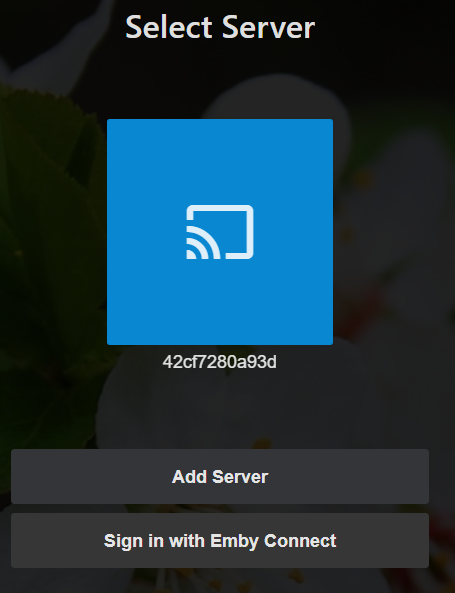

My issue is trying to connect to the server either with the Roku client or Android client via LAN.  Once I click Sign In With Emby Connect, nothing happens and the app just spins, never connecting.

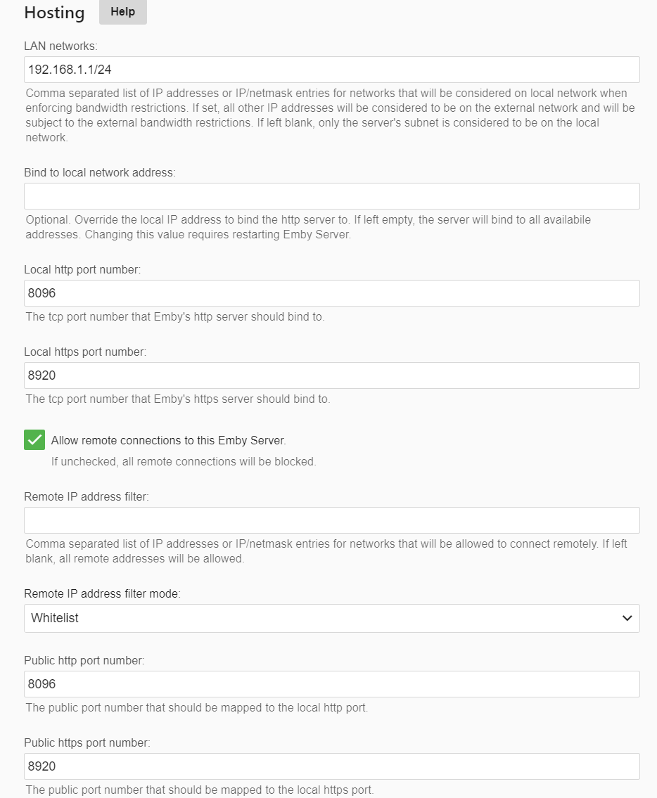

I have my user profile connected (in the server) to my Emby Connect username.  In Expert > Advanced settings Allow Remote Connections To This Server is checked.
From the Roku/Android client, my server is shown but when I click on it to connect, nothing happens and just spins - same behavior as trying to connect via Emby Connect.

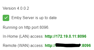

Does the server dashboard display the correct local and remote addresses? You could try removing the Lan networks filter.
Local address displays as Traefik proxy address, which I guess is correct, and remote displays correctly, as far as i can tell.
I will try removing Lan and report back.
