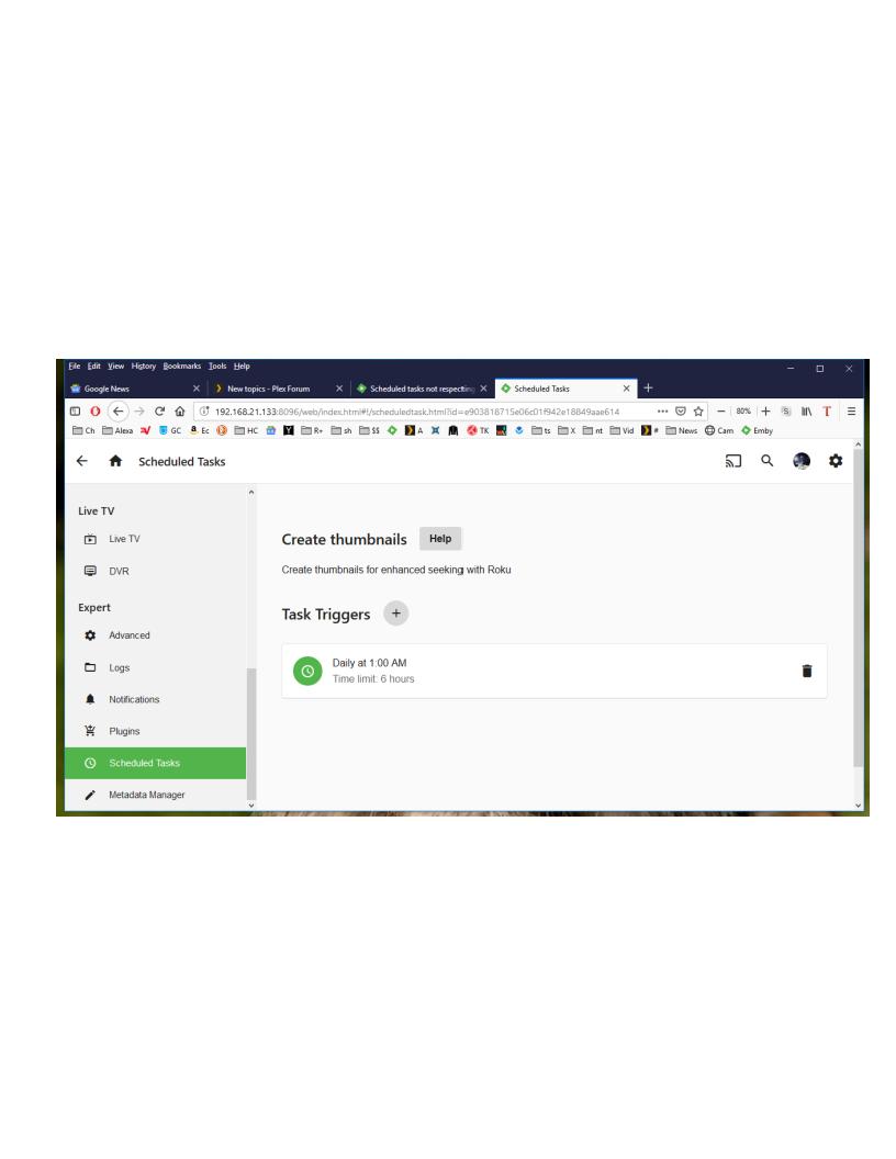

Luke 42216 Posted January 18, 2019 Posted January 18, 2019 Can you show a screenshot of your roku scheduled task triggers? thanks.
Gilgamesh_48 1243 Posted January 18, 2019 Author Posted January 18, 2019 Can you show a screenshot of your roku scheduled task triggers? thanks. I only have the one task trigger.

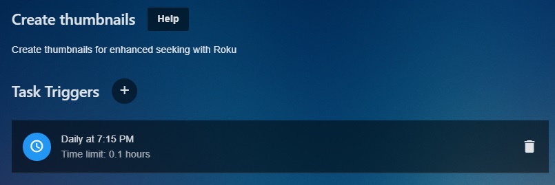

Happy2Play 9806 Posted January 21, 2019 Posted January 21, 2019 (edited) Yep. It started and I never stopped it. I did not start the task manually it just runs from whenever It starts until I stop it manually. Of course once it finally processes my entire library I am quite sure it will run more normally. As I believe I said earlier my server system is plenty powerful enough so that it runs fine even with the task running. If I am correct in post 8, your time limit is 60hrs not 6hrs. I guess as a manual test you change the custom trigger in \programdata\config\ScheduledTasks\thetaskid and drop a zero from "MaxRuntimeTicks". You will need to restart the server and the scheduled task trigger will display a decimal time (something you can't set via the UI). Mine current shows ".1hr" and am testing. Edited January 21, 2019 by Happy2Play
Gilgamesh_48 1243 Posted January 21, 2019 Author Posted January 21, 2019 If I am correct in post 8, your time limit is 60hrs not 6hrs. I guess as a manual test you change the custom trigger in \programdata\config\ScheduledTasks\thetaskid and drop a zero from "MaxRuntimeTicks". I "Think" you meant post #7. But no, the screen shot shows a time limit of 6 hours. It seems that what you are implying is that the scheduled task time limit is adding an extra zero. If that is the case I wonder if the error is in the way the server sets up time limits or there is an error in the plugin. It should be noted that other plugins seem to be working correctly.
Happy2Play 9806 Posted January 21, 2019 Posted January 21, 2019 (edited) I "Think" you meant post #7. But no, the screen shot shows a time limit of 6 hours. It seems that what you are implying is that the scheduled task time limit is adding an extra zero. If that is the case I wonder if the error is in the way the server sets up time limits or there is an error in the plugin. It should be noted that other plugins seem to be working correctly. Sorry I missed a number, post 18. Yes, I have not been able to convert (36000000000) to equal 1 hour. So I dropped a zero and the test is running now, I will know in a hour if it works. As noted in the other post you can only set whole number in the UI, but you can manipulate the file directly and restart the server. Edited January 21, 2019 by Happy2Play
Happy2Play 9806 Posted January 21, 2019 Posted January 21, 2019 My theory is correct and it is the trigger time itself as my modified trigger stopped after 1 hour.
