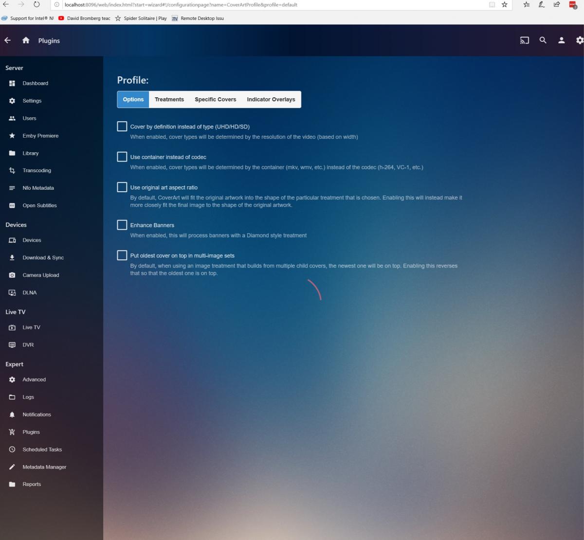

TomTiddler 39 Posted January 16, 2019 Posted January 16, 2019 Everything went smooth with a fresh, clean install until I got to CoverArt 4.0. CA installed fine, but when I go to settings, I simply get the spinning circle. Log attached. embyserver.txt

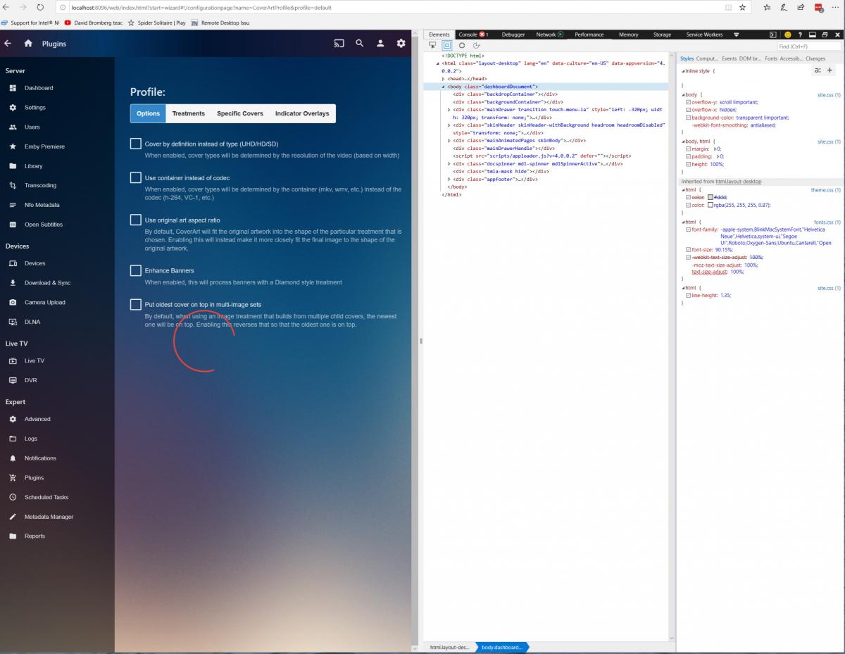

ebr 16313 Posted January 16, 2019 Posted January 16, 2019 Hi. First, ensure there is not an update for CA available. Then, do this in Chrome and bring up the console (ctrl-shift-J). Are there errors there?
TomTiddler 39 Posted January 16, 2019 Author Posted January 16, 2019 i'd need to install Chrome - any way to get same info in Edge or IE?
ebr 16313 Posted January 16, 2019 Posted January 16, 2019 I'm sure. Just look up the way to bring up the debug console.
Happy2Play 9806 Posted January 16, 2019 Posted January 16, 2019 i'd need to install Chrome - any way to get same info in Edge or IE? Hit F12.
TomTiddler 39 Posted January 16, 2019 Author Posted January 16, 2019 Should have said, but I have an almost identical configuration running beta server 4.0.0.2. Same version of CoverArt works just fine there, same release of Windows 10. Also, if you need it, I'll install Chrome. What I'm seeing is the ConfigureEmby management screen in Windows Edge
Happy2Play 9806 Posted January 16, 2019 Posted January 16, 2019 What appears in the Console tab during this process?

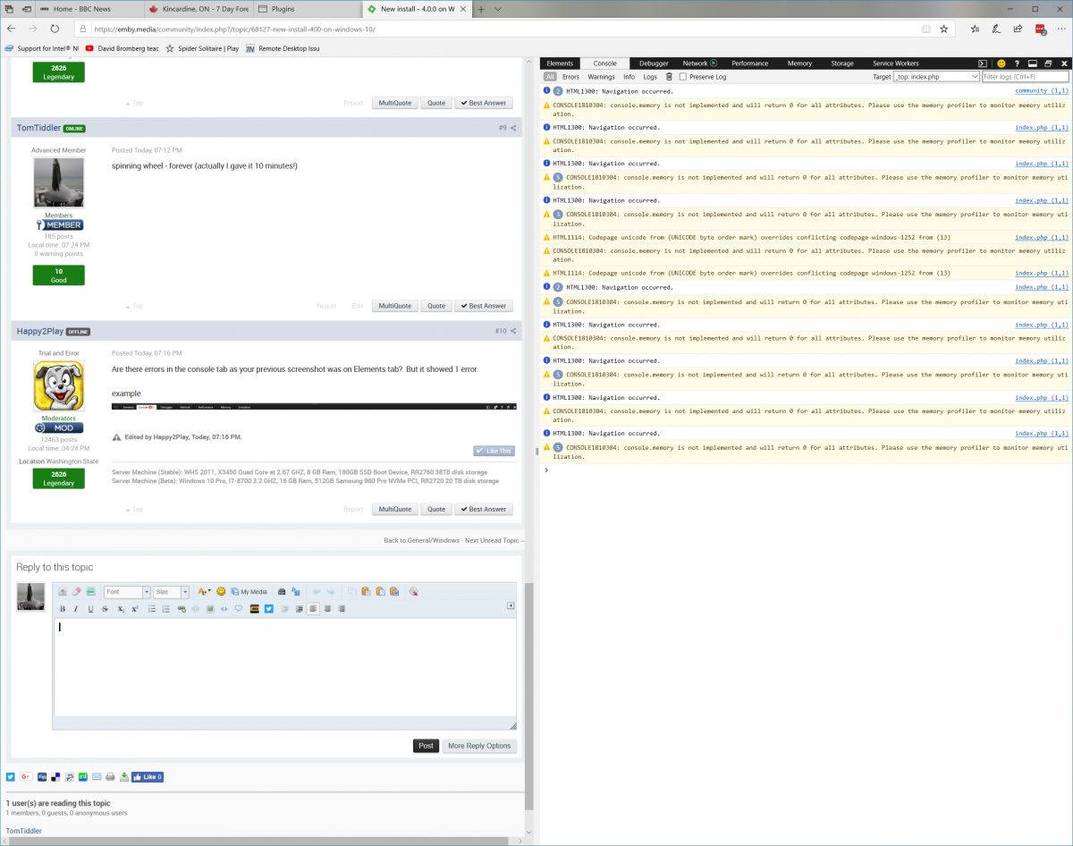

TomTiddler 39 Posted January 17, 2019 Author Posted January 17, 2019 spinning wheel - forever (actually I gave it 10 minutes!)
Happy2Play 9806 Posted January 17, 2019 Posted January 17, 2019 (edited) Are there errors in the console tab as your previous screenshot was on Elements tab? But it showed 1 error. example Edited January 17, 2019 by Happy2Play

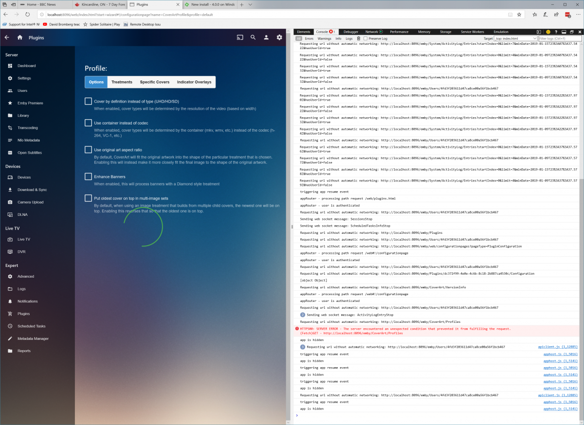

TomTiddler 39 Posted January 17, 2019 Author Posted January 17, 2019 … znd now here it really is - sorry, don't use this shit everyday
Happy2Play 9806 Posted January 17, 2019 Posted January 17, 2019 Can you scroll to the item that has the red x error.
Happy2Play 9806 Posted January 17, 2019 Posted January 17, 2019 @@Luke @@ebr HTTP500 Server error I don't get this in any browser though.
