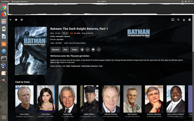

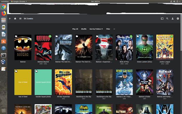

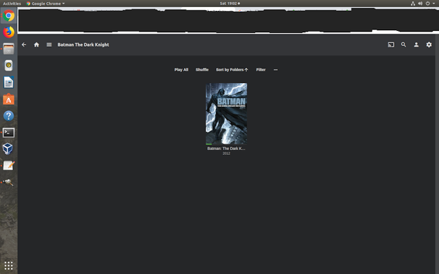

cycochuck 0 Posted January 20, 2019 Posted January 20, 2019 I'm not sure this is the correct area to post this, so forgive if it is in the wrong area. I'm having a few of issues from upgrading to 4.0.0.2 on Ubuntu 18.04. The first issue is I had several movies/shows that I had to manually identify before, and the upgrade has ignored the previous metadata info. Not a big deal, just time consuming when dealing with about 80 files to fix. One major thing I'm having issues is that the media library scan is detecting only the backdrop files and not the media files and every folder that has backdrops except for tv shows. My file structure is: tv | |_show | |_season | | | |_episode.mkv | |_backdrops | |_theme.mkv movies | |_movie_title | |_movie.mkv | |_backdrops | |_theme.mkv anime | |_show | |_season | | | |_episode.mkv | |_backdrops | |_theme.mkv Each one is its own library. TV is set up as tv shows, movies is set up as movies, and anime is set up as mixed content. I'm also having an issue with some that have a backdrop subdirectory and theme.mp3 and "show.mkv" in the main directory; the frontend will treat it like a folder. Any idea on how to fix this?
Luke 42246 Posted January 20, 2019 Posted January 20, 2019 Hi, we'll be getting an update out to resolve this, thanks !
