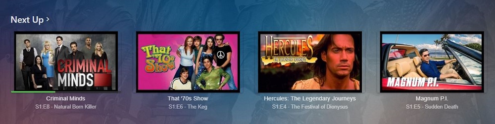

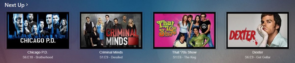

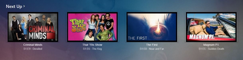

elsker 8 Posted February 4, 2019 Posted February 4, 2019 Hi, I have a weird random item in my next up display since my server updated to Version 4.0.1.0. One entry picks a show and episode completely at random, completely ignoring watched status. The show that is selected persists through a library can and reboot. However it changes to a new show when I finish watching any other episode of any other show. It also moves alone in the queue as you would expect being pushed back by new shows I have watched, until randomly getting reset to the first position again. At first I ignored it as I thought it would just get pushed out of the way but 4 times now it has been reset to the first position. These pictures show the progress. In the first instance it is the 3rd episode showing, for Hercules, a series that is indeed in my library but I have not watched any episodes through emby, not even for a second. I have checked and all episodes are marked unwatched. In the next instance I have finished watching Criminals Minds S1:E8 and the randomly shown episode updates from Hercules to an episode of The First, another show I have yet to watch at all. In the third instance I watch an episode of Chicago PD and the random episode gets changed to Dexter, and pushed to the right. Another show with all episodes unwatched. In this fourth instance I watched an episode of Law and order UK which was the last I had and the random show updated to Legacies, I have also started to watch an episode of fuller house before I remembered to take the screen shot. After I finished the episode of Fuller house it updated to an episode of Breaking Bad. Usually after it gets off screen for a little while to the right it resets back to the first position. It also occasionally picks a show already in next up. It seems completely random. It is very bizarre, Any Insight would be appreciated. Log.txt
