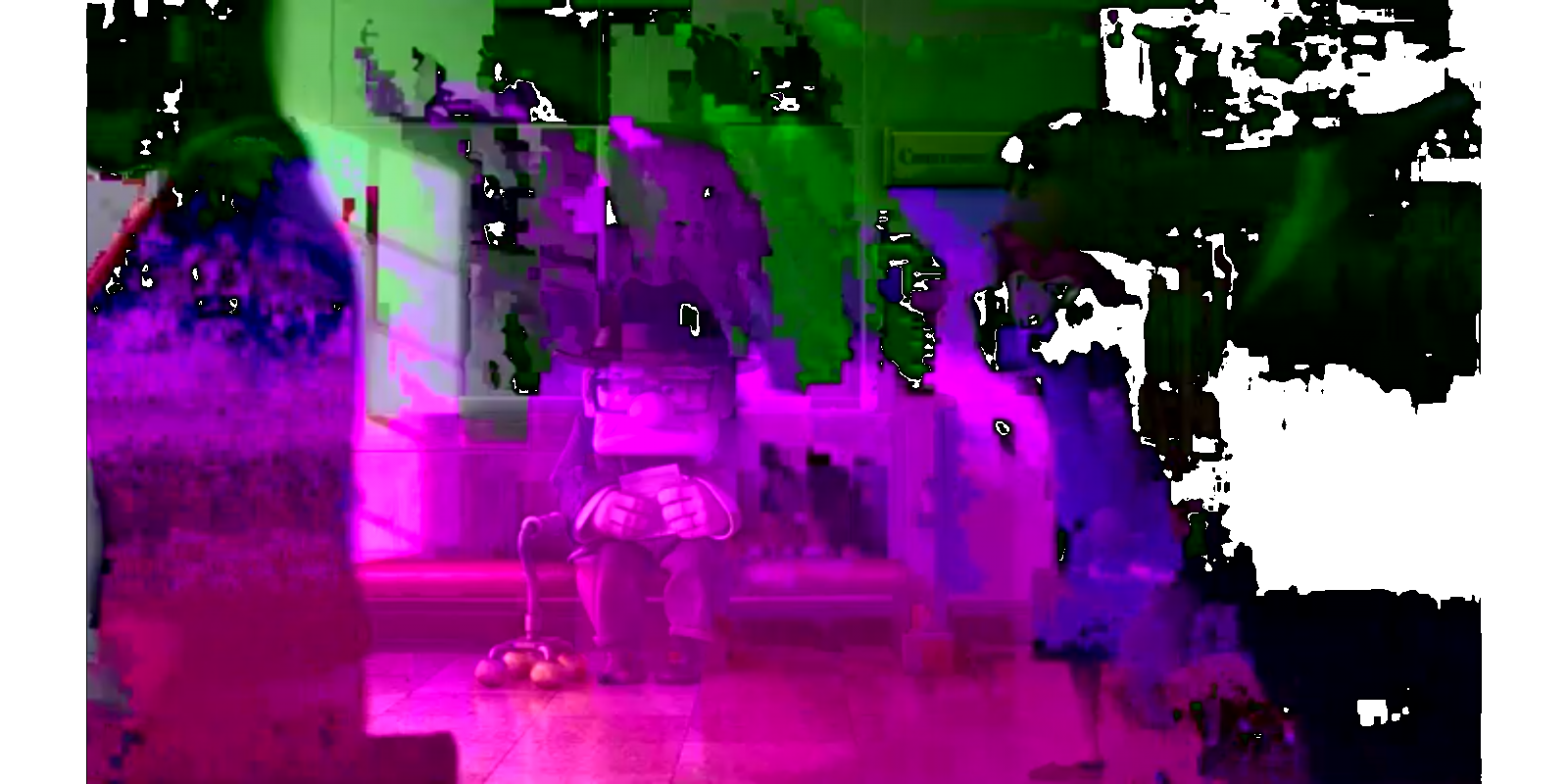

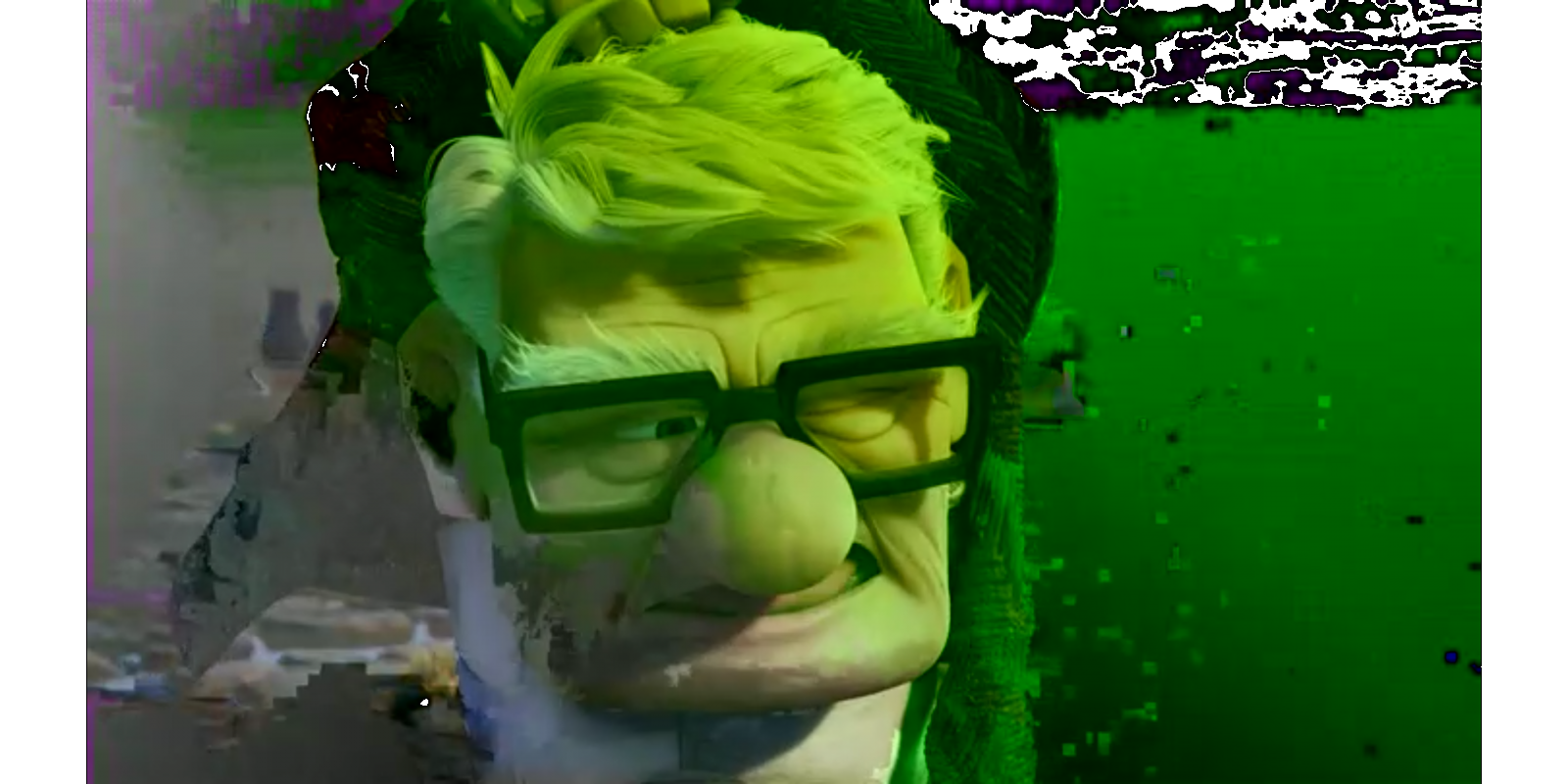

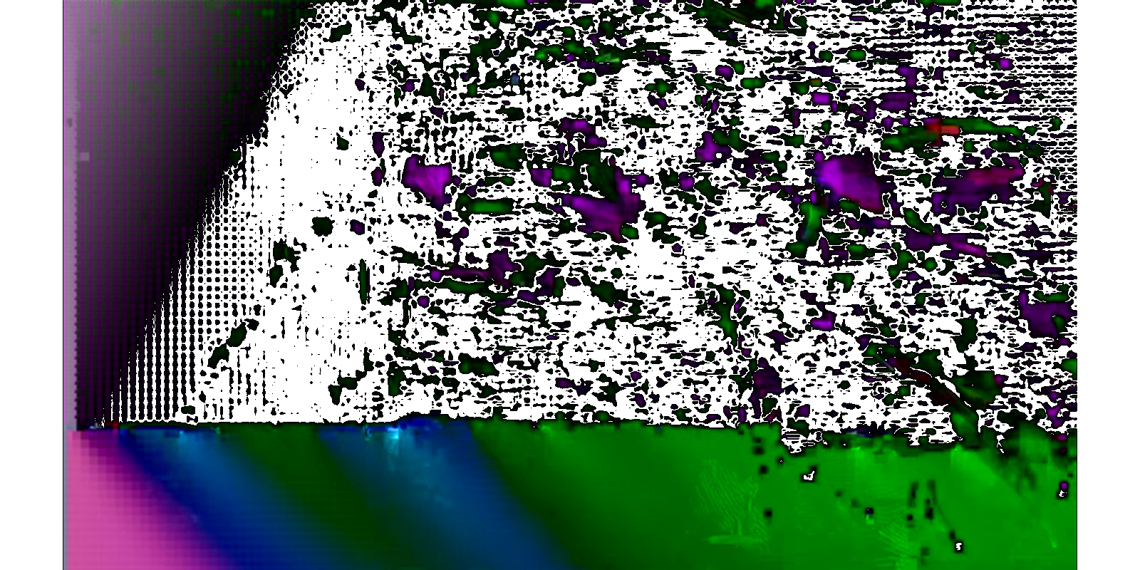

troyhough 61 Posted January 16, 2019 Posted January 16, 2019 (edited) First off, hats off to the Emby team for bringing out the new update. Lots of work has went in to making this be as smooth of a transition/upgrade as possible! I haven't used Emby enough since the Server upgraded to 4.0.0.2 to know if this happens all the time or maybe just after/during a seek. Happens for just a second or 2 then back to normal. (Intel Graphics HD 4000, Windows 10 64-Bit) (Tested on Pixel 2 XL) Edited January 18, 2019 by troyhough
Happy2Play 9806 Posted January 16, 2019 Posted January 16, 2019 Does this only happen with hardware acceleration?
troyhough 61 Posted January 16, 2019 Author Posted January 16, 2019 (edited) It's enabled now (by default I think) but has never been in the past. I can disable and test again in the morning! Have you had a chance to figure this one out by chance? https://emby.media/community/index.php?/topic/67870-cant-direct-play-and-transcode-the-same-channel-hdhomerun/ Edited January 16, 2019 by troyhough
troyhough 61 Posted January 16, 2019 Author Posted January 16, 2019 (edited) Ok so I disabled Hardware Acceleration and couldn't get the pixelated/blurry images like I was getting above. Wow does the CPU take a pretty huge hit while transcoding with Hardware Acceleration disabled! Much more so with pre-recorded material versus Live TV. With H.A. disabled, the CPU would hit 90-100% at times with 2-3 transcoded streams (pre-recorded compressed material), while only 15-20% with 3 streams (pre-recorded compressed material) and H.A. enabled. So, for now, I will deal with the goofy image issue in exchange for the major CPU reduction of having H.A. enabled! Edited Jan 17 - I have disabled Hardware Acceleration. Couldn't stand the constant skipping/sputtering with Live TV. Performance (for me) is night & day better with H.A. disabled. (Server Version 4.0.0.2) Edited January 18, 2019 by troyhough
