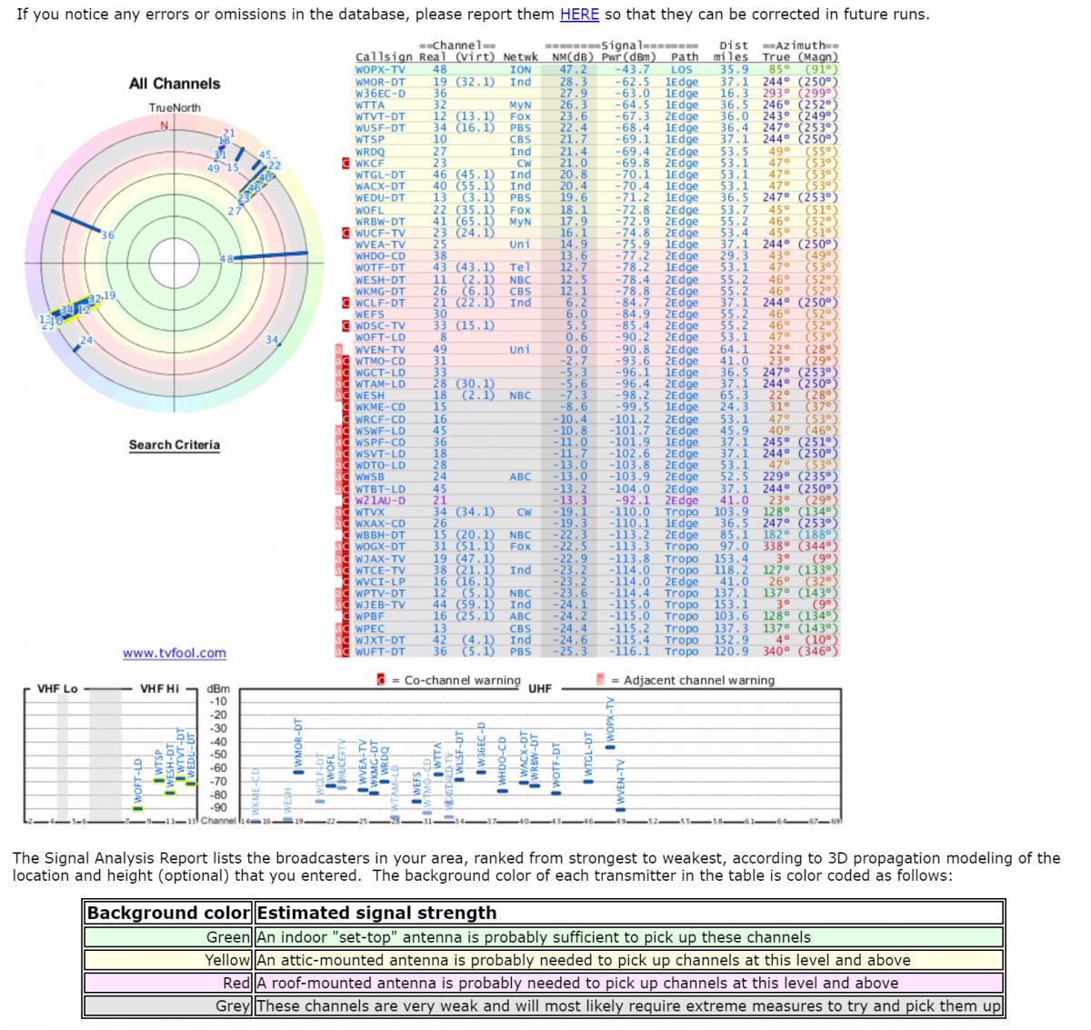

Carlo 4561 Posted January 18, 2019 Posted January 18, 2019 If you're in the USA, send me a PM with your zipcode and I'll check out your area for for to get an idea of what antenna you will need. Can you do an outdoor antenna? They work much better if you aren't in close proximity to the towers. Also the tower arrangement matters. By this I mean you can't use a highly directional antenna if you have towers in multiple directions. That's what I'll check for you. BTW, 80 to 100 miles isn't likely unless it's over water. However those antennas are usually good for 40 to 50 miles of real terrain if mounted at the proper height. I'm picking up channels from 43 miles to 84 miles in different directions using multiple antennas. I get 3 markets this way which I use for sports. If you are handy with tools and can follow building directions you can make your own outside antenna that is better then anything you can purchase and better made as well. BTW, you can start with one Quatro to get going and add the 2nd later when you actually need it and confirm everything is working as expected.
LqHnyBear 24 Posted January 18, 2019 Author Posted January 18, 2019 Thank you. I already checked on www.fcc.gov/media/engineering/dtvmaps for my exact address. I was thinking about this one as I’ll have to do an indoor antenna but I’m in the boonies surrounded by nothing but lakes so it should be good I hope.

Carlo 4561 Posted January 20, 2019 Posted January 20, 2019 Thank you. I already checked on www.fcc.gov/media/engineering/dtvmaps for my exact address. I was thinking about this one as I’ll have to do an indoor antenna but I’m in the boonies surrounded by nothing but lakes so it should be good I hope. Probably a lot of the channels you will want (NBC, FOX, PBS, CBS) are VHF-Hi channels which is likely going to require a different antenna then what you'll find commonly available. At least you don't have any VHF-Lo channels which require the large antennas you see mounted on towers. That graph doesn't really give you much useful information as you don't know the direction of the towers. For example they could all be north of you, half north and half south, etc. Nor does it take obstacles or terrain into account which are big factors. This will be a bit better: http://www.tvfool.com/index.php?option=com_wrapper&Itemid=29 put your exact address in and it will give you a result page. Post the URL back here in the forums which will hide you address but give us most of the info we need to help you with antenna selection. Also, why do you have to use an indoor antenna? The same antenna mounted indoor vs outdoor will be attenuated about 10 to 15 dB. Every 3 dB is 1/2 the signal, so 6 dB is 1/4 the signal, 9 dB is 1/8 the signal and 12 dB is 1/16 the signal. So essentially you give up over 10 dB just mounting the antenna indoors so you can remove 10 dB right off the bat from any true antenna gain figures. I said "true" there because a lot of antennas come with an amp but that doesn't make up for antenna gain. You can't improve what you don't get. You can "boost" the signal with an amp however so you can have longer cable runs. So it's important to know the direction of the different towers you'll need for the channels you want, the spectrum they use (VHF-Lo, VHF-Hi, UHF), the power or NM of the station at your location with an antenna directly pointing at it as well as obstacles that block or could reflect the signal such as hills, mountains, buildings and even trees!
LqHnyBear 24 Posted January 20, 2019 Author Posted January 20, 2019 hmm it's as I thought most chans are NE and SW of me and I'll be forced to mount the indoor antenna on the SE corner of my home. I bet my pickup is going to be spotty at best.
Carlo 4561 Posted January 21, 2019 Posted January 21, 2019 hmm it's as I thought most chans are NE and SW of me and I'll be forced to mount the indoor antenna on the SE corner of my home. I bet my pickup is going to be spotty at best. Can you post the URL link for that vs the screen shot?
Carlo 4561 Posted January 21, 2019 Posted January 21, 2019 Never mind, don't need the URL as I know this territory and where you are located. One antenna isn't going to do it for you inside as almost all of your channels are 1 and 2 edge reception. Your SW channels are going to be your best bet at around 36 miles but you need an antenna with a lot of gain in both UHF and VHF-HI and preferably a directional high gain antenna in both bands. Your can basically forget about NE channels at 53+ miles with an inside antenna for reliable use. Curious, what is your obstacle to mounting an antenna outside? What kind of structure is your living environment walls? Metal, metal siding, brick? Do you have an attic with a window in it with no screen? You may be able to mount a big antenna there to overcome some of the loss. Your situation is doable but needs to be done right. PS if you could mount an antenna on the roof you could use a high gain antenna without a reflector and probably get both the SW and NE channels from one antenna.
