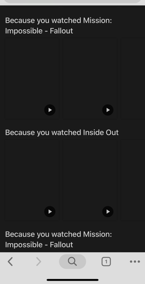

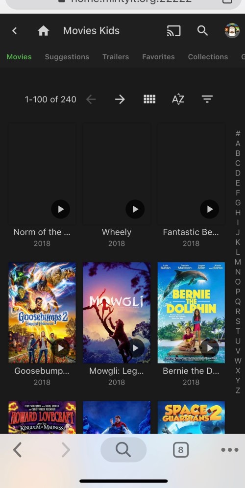

ryzilla 13 Posted January 15, 2019 Posted January 15, 2019 Hi Guys Got a weird issue with my meta data, i have it saved unto the folder of that media after a while it stops working and random images are missing. For example, as you can see no images, this is from webpage, iphone app both show same issues. I do a restart of the sever sometimes a reboot and boom its all working items i had issues with now work. Anyone seen this or got any thoughts?

Happy2Play 9806 Posted January 15, 2019 Posted January 15, 2019 (edited) Do your drives sleep? 2019-01-16 06:33:58.567 Error LibraryMonitor: Error in Directory watcher for: /mcemedia/disk4/tv_animation System.IO.IOException: Not a directory Edited January 15, 2019 by Happy2Play
ryzilla 13 Posted January 15, 2019 Author Posted January 15, 2019 will triple check im sure they are not, but as an example the tv animation some will display some wont (assuming could be a cache issue)
ryzilla 13 Posted January 16, 2019 Author Posted January 16, 2019 just run hdparm -S 0 /dev/sdd2 on all the drives see what happens thanks team
Solution Luke 42216 Posted January 16, 2019 Solution Posted January 16, 2019 I would also update to 4.0 now that it's available and then we can see if that makes any difference. thanks. 1
ryzilla 13 Posted January 16, 2019 Author Posted January 16, 2019 (edited) Will do although my emby (linux) is stuck at Version 3.5.3.0 still with no update, will try a manual update later if no auto update set if i do a full install over the top i assume everything stays config wise Edited January 16, 2019 by ryzilla
ryzilla 13 Posted January 16, 2019 Author Posted January 16, 2019 Ubuntu X64 Download emby-server-deb_4.0.0.2_amd64.deb
Luke 42216 Posted January 16, 2019 Posted January 16, 2019 Ok yes you can update, that's been posted.
ryzilla 13 Posted January 16, 2019 Author Posted January 16, 2019 (edited) done upgrade all working great work as always Luke and team. edit although now i get mix content warnings running SSL, weird never mind its gone now. Edited January 16, 2019 by ryzilla
