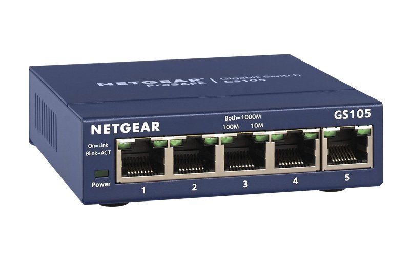

notla49285 48 Posted January 14, 2019 Author Posted January 14, 2019 I have this switch: https://www.netgear.com/business/products/switches/unmanaged/GS105.aspx#tab-techspecs My only concern was that, for example, I want to watch Live TV remotely, so there's a data stream coming from the network tuner - to the switch - to the router - to the switch - to the server - to the switch - to the router and then out to wherever I am. I thought this may end up slowing down bearing in mind the amount of data that is being shifted through it all, especially with HD channels.
BAlGaInTl 288 Posted January 14, 2019 Posted January 14, 2019 I have this switch: https://www.netgear.com/business/products/switches/unmanaged/GS105.aspx#tab-techspecs My only concern was that, for example, I want to watch Live TV remotely, so there's a data stream coming from the network tuner - to the switch - to the router - to the switch - to the server - to the switch - to the router and then out to wherever I am. I thought this may end up slowing down bearing in mind the amount of data that is being shifted through it all, especially with HD channels. A gigabit switch will handle all that no problem. Your internet connection would most likely be the limiting factor. A NAS is probably the best solution. It will combine the enclosure and the operating system. If budget is a concern... look for a used one. I see them all the time around here cheap.
