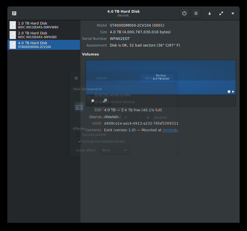

Peter Piper 0 Posted January 16, 2019 Author Posted January 16, 2019 Okay, I got this problem sorted. I simply had to change the mount point using the "Disks" program in the main menu (See pics). Everything works great now!
sfatula 208 Posted January 16, 2019 Posted January 16, 2019 Yep, that works too, as would changing perms if you did want to keep it where it was. Glad you got it working!
