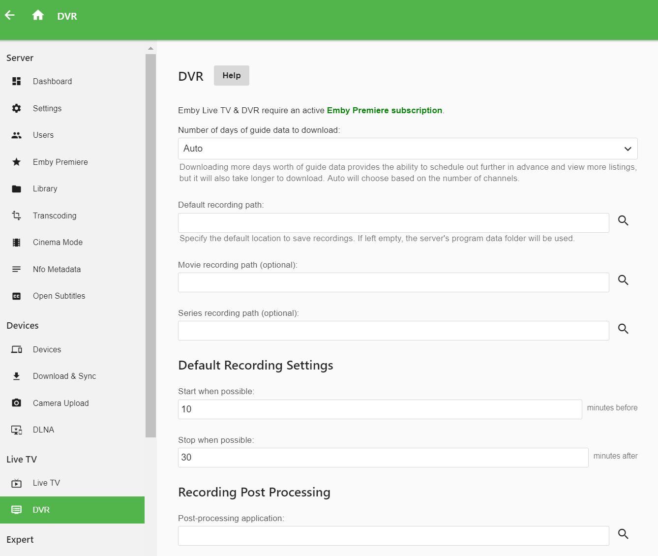

jordy 284 Posted January 7, 2019 Posted January 7, 2019 (edited) Have you added some padding times to the DVR > Default Recording Settings? - maybe that is affecting your start times. I'm wondering if you have added a "-" (minus sign) to the number in the setting, that may cause the DVR to add 18 mins to the start time instead of deducting it thus making it start later than scheduled. Other than that, make sure your pc has the correct time... Edited January 7, 2019 by jordy
