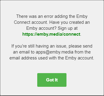

Misinthe 46 Posted January 3, 2019 Author Posted January 3, 2019 Have you went through the steps in the wiki? https://github.com/MediaBrowser/Wiki/wiki/Connectivity So when I try to follow that Wiki, I get stuck in the Emby Connect step, I get this error when trying to save it in the dashboard.

Happy2Play 9840 Posted January 3, 2019 Posted January 3, 2019 So when I try to follow that Wiki, I get stuck in the Emby Connect step, I get this error when trying to save it in the dashboard. Okay have you proceed and tested your external address? Forwarded ports? Does canyouseeme.org show the ports open?
