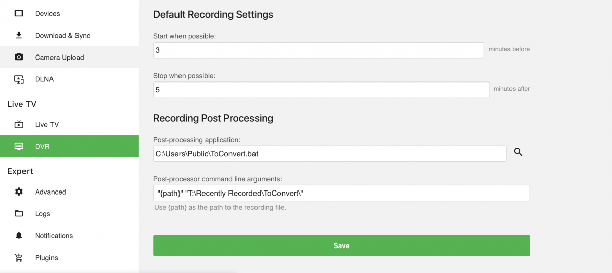

trmb 2 Posted December 30, 2018 Posted December 30, 2018 (edited) I can't find any evidence of the event firing and script starting in the log. In the snippet attached, it doesn't seem to fire. You can find the relevant entries searching for "Mother." To test, I set a recording at 10:19 for an episode of "How I Met your Mother" and let it complete at 10:30, with padding maybe 10:35. I see the Roku thumbnails event firing at 10:37 pm but no post-processing event. For testing I had replaced my more complex move and convert script with a simple batch script to try to copy the file somewhere and echo the command and date and time. No log output from that either, again indicating the postprocessing event isn't starting to run. The filename and batch code is below. C:\Users\Public\ToConvert.bat echo %date% %time% >> ToConvert.log echo copy %1 \\TIMCLOUD\Public\Recently Recorded\ToConvert >> ToConvert.log copy %1 "\\TIMCLOUD\Public\Recently Recorded\ToConvert" >> ToConvert.log echo ----- >> ToConvert.log I also included a screenshot of the DVR section with post processing command in case that is helpful. logSnippet.txt Edited December 30, 2018 by trmb

Solution Luke 43721 Posted December 30, 2018 Solution Posted December 30, 2018 Oh wait I see, you're using ServerWMC. This setting is only supported when using Emby's native recording features. What tuner do you have? 1
trmb 2 Posted December 30, 2018 Author Posted December 30, 2018 (edited) That explains it. I was about to ask if maybe DVR postprocessing didn't work with ServerWMC... I'm using a HDHomeRun Prime with a smartcard from ComCast. I'll find a different way, either foldersync/convert or MCEBuddy. I just lost my recording storage SSD to wear and wanted to move new recordings off the system SSD to my NAS. Changing the whole system around at the same time, figured I'd give postprocessing a try--to no avail. Thanks for the quick reply Luke! Edited December 30, 2018 by trmb
