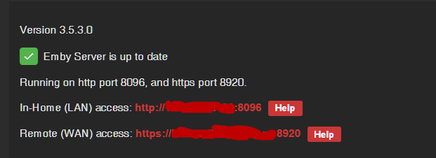

Whizard 0 Posted December 27, 2018 Author Posted December 27, 2018 Does your Emby dashboard show and Remote IP? It only shows a Remote (WAN) access: It does not have a local, which is really what I want, as if I'm understanding it correctly - I only want to watch what is on my server when I'm at home and watching through Roku.

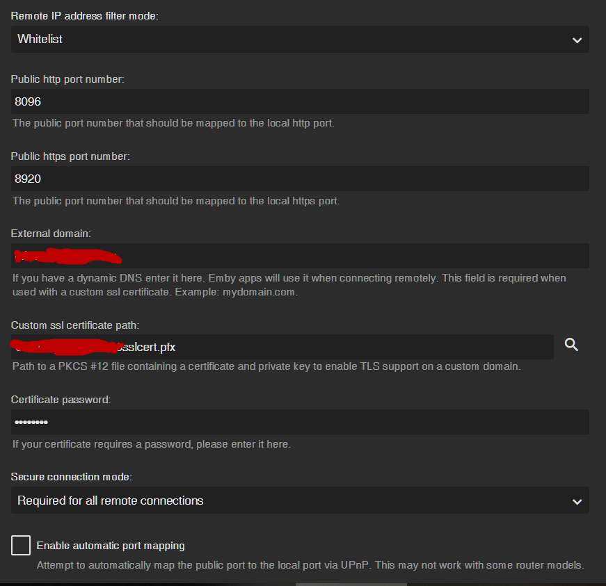

RobWayBro 28 Posted December 27, 2018 Posted December 27, 2018 Are the Roku device and the Emby server on the same IP network? If so, and you only want to watch inside your network you do not need the remote access enabled nor should you have to perform a port forward, these options are if you desire to connect to your Emby server outside your network. Attached are the screen shots of my advanced screen. You would not need and external domain and unless you have ssl enabled, you would not need an ssl certificate path/file and the allow remote connections would not need to be checked if you only desire internal access. HTH
