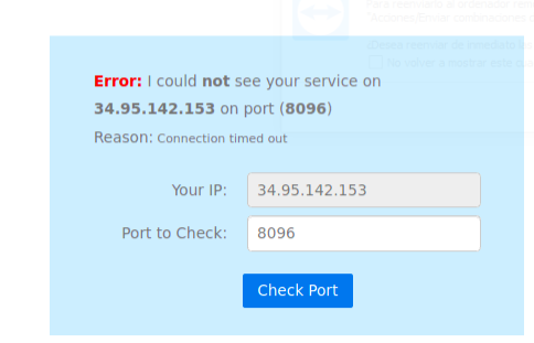

blim5001 8 Posted December 16, 2018 Posted December 16, 2018 That suggests there could be a firewall blocking the connection. If i remember correctly, (I used google cloud a while ago) there are not many ports open by default. So you will need to check the settings in google cloud and allow or create a rule for that port. if you use http://www.canyouseeme.org/ with your VM ip and port 8096 does that show that success? I guess not

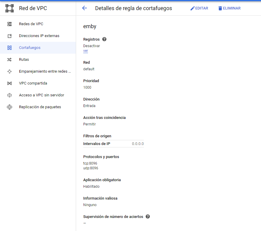

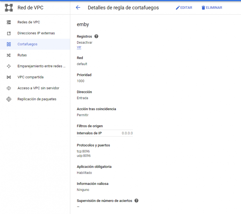

romanito 2 Posted July 25, 2020 Posted July 25, 2020 Hi, I currently have the same problem, but on a ubuntu machine, I have correctly configured the firewall, but I am still able to connect remotely, I attach a print on my google firewall settings.
Luke 42246 Posted July 27, 2020 Posted July 27, 2020 HI, did you make sure Emby Server was running when you tried that?
