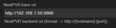

arrbee99 1836 Posted December 9, 2018 Posted December 9, 2018 Don't know if you tried NextPVR in Emby with the plugin, but if so maybe check in the NextPVR setup you have the url set to the same as that given in the dashboard Home page In-Home (LAN) access, the bit before the 8866 should be the same (or it is for me)... Maybe try restarting the Emby server and/or re-booting the server machine. After that you'll probably need to hear from someone who actually knows what they're talking about...

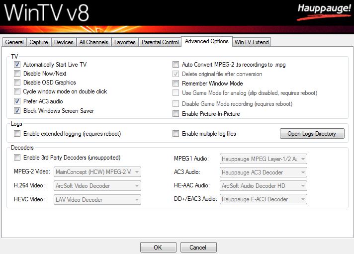

jasonwilliams 37 Posted January 10, 2019 Posted January 10, 2019 I find that most of the settings in WinTV don't actually impact the streaming to Emby (probably because Emby is using the API and those are application settings specific to WinTV). The one setting I did change was to disable buffering. The stream comes up much faster and overall seems more stable. Emby already allows you to rewind LiveTV, so no need for this feature.
SHSPVR 125 Posted January 10, 2019 Posted January 10, 2019 I find that most of the settings in WinTV don't actually impact the streaming to Emby (probably because Emby is using the API and those are application settings specific to WinTV). The one setting I did change was to disable buffering. The stream comes up much faster and overall seems more stable. Emby already allows you to rewind LiveTV, so no need for this feature. That odd all that dose for me get Playback Error No compatible streams are currently available. Please try again later or contact your system administrator for details.
SHSPVR 125 Posted January 11, 2019 Posted January 11, 2019 (edited) Server log? Here logs with it on and off note this with DualHD Tuner it should make no diff what tuner I used with WinTV I'm assuming he talk about the WinTV setting under Disk Buffering when set it to 0 so is that what refer to @@jasonwilliams ?, as I said this doesn't work with Emby but work with in WinTV buffer-off.zip buffer-on.zip Edited January 11, 2019 by SHSPVR
jasonwilliams 37 Posted January 11, 2019 Posted January 11, 2019 Yes, that is the setting. Mine is set to 0.
