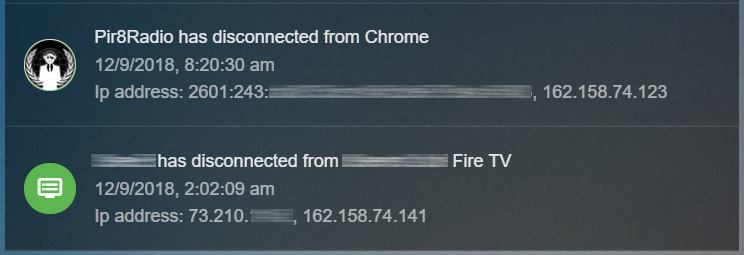

pir8radio 1313 Posted December 9, 2018 Posted December 9, 2018 (edited) i want to use pins from certain ip address like home isp public ip and passwords from other connections. this was working before i turned on the cdn network in cloudflare regards rhys If things are setup correctly you should either see the clients real IP in your emby dashboard, or BOTH the clients IP and the cloudflare edge server that handled the connection (like mine below). And you should be able to add your ISP to the "LAN Networks" field in emby. But i think this also disables bandwidth related transcoding when emby thinks you are on a LAN (someone correct me if i'm wrong) which would make it difficult to stream. As you can see in this screenshot I connected to my server using IPv6 (could be another problem of yours) and another user connected using IPv4. But either way you see the real client IP, cloudflare server ip. Edited December 9, 2018 by pir8radio
hazell20 0 Posted December 9, 2018 Author Posted December 9, 2018 If things are setup correctly you should either see the clients real IP in your emby dashboard, or BOTH the clients IP and the cloudflare edge server that handled the connection (like mine below). And you should be able to add your ISP to the "LAN Networks" field in emby. But i think this also disables bandwidth related transcoding when emby thinks you are on a LAN (someone correct me if i'm wrong) which would make it difficult to stream. As you can see in this screenshot I connected to my server using IPv6 (could be another problem of yours) and another user connected using IPv4. But either way you see the real client IP, cloudflare server ip. thanks for the reply that is how I thought it worked and tried adding both ips as well as cloudflares ipranges as that change sometimes. but still, want me to put in passwords. had not thought about the bandwidth implications might try to look it to that. Reagrds rhys
