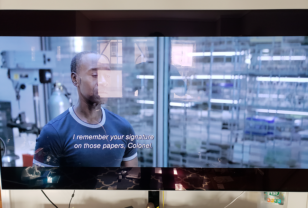

precocial 0 Posted December 5, 2018 Author Posted December 5, 2018 Will do. Also, if you can take a look at the subtitle location in the LG Emby app (I provided a screenshot). Throughout the movie, the subtitles are on the left. And the login requirement every time I start the LG Emby app. It doesn't save login information so every time I use the app, I have to enter the login/pin or server information. Thanks! Keep up the great work!
Luke 42186 Posted December 5, 2018 Posted December 5, 2018 The subtitles are resolved for the next release of the app. Thanks.
