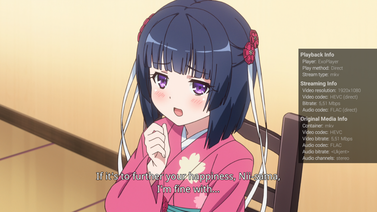

Gigaa 0 Posted December 4, 2018 Posted December 4, 2018 (edited) Hey. I recently bought an Nvidia shield tv and installed Emby Android TV, so far so good. However when playing video files with 24 bit sample flac files only loud static noise seems to be playing. Tested two files and both have been doing the exact same thing. Checking out the "stats for nerds" option shows them with "Audio bitrate: <Unknown>" but it plays perfectly on Emby with my phone or with mpv on my desktop. Here is the mediainfo for both of the files. [gigaa@gigaa-pc OVA]$ mediainfo \[animeisdead\]\ Nekopara\ -\ OVA\ \[BD\ 1080p\ h265\ 10-bit\ FLAC\].mkv General Unique ID : 244810833780211152170142419127130557648 (0xB82CD9FF19AC8022BE03EBC7343E8CD0) Complete name : [animeisdead] Nekopara - OVA [BD 1080p h265 10-bit FLAC].mkv Format : Matroska Format version : Version 4 File size : 2.24 GiB Duration : 58 min 6 s Overall bit rate mode : Variable Overall bit rate : 5 510 kb/s Encoded date : UTC 2018-02-05 10:24:15 / UTC 2018-02-05T02:14:02Z Writing application : mkvmerge v20.0.0 ('I Am The Sun') 64-bit Writing library : libebml v1.3.5 + libmatroska v1.4.8 / Lavf57.7.2 Attachments : FontinSans-Bold.ttf / FontinSans-BoldItalic.ttf Video ID : 1 Format : HEVC Format/Info : High Efficiency Video Coding Format profile : Main 10@L4@Main Codec ID : V_MPEGH/ISO/HEVC Duration : 58 min 6 s Bit rate : 3 966 kb/s Width : 1 920 pixels Height : 1 080 pixels Display aspect ratio : 16:9 Frame rate mode : Constant Frame rate : 23.976 (24000/1001) FPS Color space : YUV Chroma subsampling : 4:2:0 Bit depth : 10 bits Bits/(Pixel*Frame) : 0.080 Stream size : 1.61 GiB (72%) Title : h265 10-bit Writing library : x265 2.6:[Linux][GCC 7.2.1][64 bit] 10bit Encoding settings : cpuid=1173503 / frame-threads=2 / wpp / no-pmode / no-pme / no-psnr / no-ssim / log-level=2 / input-csp=1 / input-res=1920x1080 / interlace=0 / total-frames=0 / level-idc=0 / high-tier=1 / uhd-bd=0 / ref=3 / no-allow-non-conformance / no-repeat-headers / annexb / no-aud / no-hrd / info / hash=0 / no-temporal-layers / open-gop / min-keyint=24 / keyint=240 / bframes=4 / b-adapt=2 / b-pyramid / bframe-bias=0 / rc-lookahead=20 / lookahead-slices=6 / scenecut=40 / no-intra-refresh / ctu=64 / min-cu-size=8 / no-rect / no-amp / max-tu-size=32 / tu-inter-depth=1 / tu-intra-depth=1 / limit-tu=0 / rdoq-level=0 / dynamic-rd=0.00 / no-ssim-rd / signhide / no-tskip / nr-intra=0 / nr-inter=0 / no-constrained-intra / strong-intra-smoothing / max-merge=2 / limit-refs=3 / no-limit-modes / me=1 / subme=2 / merange=57 / temporal-mvp / weightp / no-weightb / no-analyze-src-pics / deblock=0:0 / sao / no-sao-non-deblock / rd=3 / no-early-skip / rskip / no-fast-intra / no-tskip-fast / no-cu-lossless / no-b-intra / no-splitrd-skip / rdpenalty=0 / psy-rd=2.00 / psy-rdoq=0.00 / no-rd-refine / analysis-reuse-mode=0 / no-lossless / cbqpoffs=0 / crqpoffs=0 / rc=crf / crf=16.0 / qcomp=0.60 / qpstep=4 / stats-write=0 / stats-read=0 / ipratio=1.40 / pbratio=1.30 / aq-mode=1 / aq-strength=1.00 / cutree / zone-count=0 / no-strict-cbr / qg-size=32 / no-rc-grain / qpmax=69 / qpmin=0 / no-const-vbv / sar=1 / overscan=0 / videoformat=5 / range=0 / colorprim=1 / transfer=1 / colormatrix=1 / chromaloc=0 / display-window=0 / max-cll=0,0 / min-luma=0 / max-luma=1023 / log2-max-poc-lsb=8 / vui-timing-info / vui-hrd-info / slices=1 / no-opt-qp-pps / no-opt-ref-list-length-pps / no-multi-pass-opt-rps / scenecut-bias=0.05 / no-opt-cu-delta-qp / no-aq-motion / no-hdr / no-hdr-opt / no-dhdr10-opt / analysis-reuse-level=5 / scale-factor=0 / refine-intra=0 / refine-inter=0 / refine-mv=0 / no-limit-sao / ctu-info=0 / no-lowpass-dct / refine-mv-type=0 / copy-pic=1 Language : Japanese Default : Yes Forced : No Color range : Limited Color primaries : BT.709 Transfer characteristics : BT.709 Matrix coefficients : BT.709 Audio ID : 2 Format : FLAC Format/Info : Free Lossless Audio Codec Codec ID : A_FLAC Duration : 58 min 6 s Bit rate mode : Variable Bit rate : 1 424 kb/s Channel(s) : 2 channels Channel layout : L R Sampling rate : 48.0 kHz Frame rate : 10.417 FPS (4608 SPF) Bit depth : 24 bits Compression mode : Lossless Stream size : 592 MiB (26%) Title : FLAC 2.0 Language : Japanese Default : Yes Forced : No Text #1 ID : 3 Format : ASS Codec ID : S_TEXT/ASS Codec ID/Info : Advanced Sub Station Alpha Duration : 54 min 1 s Bit rate : 128 b/s Count of elements : 817 Compression mode : Lossless Stream size : 50.9 KiB (0%) Title : English Language : English Default : Yes Forced : No Text #2 ID : 4 Format : PGS Muxing mode : zlib Codec ID : S_HDMV/PGS Codec ID/Info : Picture based subtitle format used on BDs/HD-DVDs Duration : 54 min 0 s Bit rate : 310 kb/s Count of elements : 5611 Stream size : 120 MiB (5%) Title : Japanese Language : Japanese Default : No Forced : No Menu 00:00:00.000 : :Prologue 00:00:34.076 : :OP 00:02:04.166 : :Part A 00:21:34.293 : :Part B 00:39:28.658 : :Part C 00:52:25.643 : :Part D 00:54:14.293 : :ED [gigaa@gigaa-pc Season 1]$ mediainfo \[UTW\]_Angel_Beats\!_-_01v2_\[BD\]\[h264-1080p_FLAC\]\[B448458F\].mkv General Unique ID : 239893702643211187375890717938566201277 (0xB479D8B6C8794DE091B782F6B0AA7FBD) Complete name : [UTW]_Angel_Beats!_-_01v2_[BD][h264-1080p_FLAC][B448458F].mkv Format : Matroska Format version : Version 2 File size : 1.13 GiB Duration : 26 min 1 s Overall bit rate mode : Variable Overall bit rate : 6 191 kb/s Movie name : Angel Beats! BD - Episode 01: Departure Encoded date : UTC 2011-02-28 10:17:34 Writing application : mkvmerge v3.4.0 ('Rapunzel') built on May 15 2010 09:38:20 Writing library : libebml v0.8.0 + libmatroska v0.9.0 Attachments : Adore.ttf / Angelina.TTF / AriaScriptSSK-Regular.ttf / BAKESBR_.TTF / BrittanicBold.TTF / ChopinScript.TTF / CopperplateGothicBold.TTF / EFFLORES.TTF / Michv2.ttf / TakaoPMincho.ttf / VAGRoundedStd-Light.ttf Video ID : 1 Format : AVC Format/Info : Advanced Video Codec Format profile : High@L4.1 Format settings : CABAC / 3 Ref Frames Format settings, CABAC : Yes Format settings, ReFrames : 3 frames Codec ID : V_MPEG4/ISO/AVC Duration : 26 min 1 s Nominal bit rate : 4 545 kb/s Width : 1 920 pixels Height : 1 080 pixels Display aspect ratio : 16:9 Frame rate mode : Constant Frame rate : 23.976 (24000/1001) FPS Color space : YUV Chroma subsampling : 4:2:0 Bit depth : 8 bits Scan type : Progressive Bits/(Pixel*Frame) : 0.091 Title : 01: Departure Writing library : x264 core 100 r1659 57b2e56 Encoding settings : cabac=1 / ref=4 / deblock=1:-2:-2 / analyse=0x3:0x133 / me=umh / subme=10 / psy=1 / psy_rd=0.70:0.20 / mixed_ref=1 / me_range=32 / chroma_me=1 / trellis=2 / 8x8dct=1 / cqm=0 / deadzone=21,11 / fast_pskip=0 / chroma_qp_offset=-3 / threads=6 / sliced_threads=0 / nr=65 / decimate=1 / interlaced=0 / constrained_intra=0 / bframes=4 / b_pyramid=1 / b_adapt=2 / b_bias=0 / direct=3 / weightb=1 / open_gop=0 / weightp=2 / keyint=240 / keyint_min=24 / scenecut=70 / intra_refresh=0 / rc_lookahead=72 / rc=2pass / mbtree=1 / bitrate=4545 / ratetol=1.0 / qcomp=0.70 / qpmin=10 / qpmax=51 / qpstep=4 / cplxblur=20.0 / qblur=0.5 / vbv_maxrate=50000 / vbv_bufsize=50000 / ip_ratio=1.40 / aq=1:1.20 / nal_hrd=none Language : Japanese Default : No Forced : No Color range : Limited Color primaries : BT.709 Transfer characteristics : BT.709 Matrix coefficients : BT.709 Audio #1 ID : 2 Format : FLAC Format/Info : Free Lossless Audio Codec Codec ID : A_FLAC Duration : 26 min 1 s Bit rate mode : Variable Channel(s) : 2 channels Channel layout : L R Sampling rate : 48.0 kHz Bit depth : 24 bits Compression mode : Lossless Title : FLAC 2.0 24-bit Writing library : libFLAC 1.2.1 (UTC 2007-09-17) Language : Japanese Default : Yes Forced : No Audio #2 ID : 3 Format : AC-3 Format/Info : Audio Coding 3 Commercial name : Dolby Digital Codec ID : A_AC3 Duration : 26 min 1 s Bit rate mode : Constant Bit rate : 192 kb/s Channel(s) : 2 channels Channel layout : L R Sampling rate : 48.0 kHz Frame rate : 31.250 FPS (1536 SPF) Bit depth : 16 bits Compression mode : Lossy Stream size : 35.7 MiB (3%) Title : Commentary Language : Japanese Service kind : Commentary Default : No Forced : No Text ID : 4 Format : ASS Codec ID : S_TEXT/ASS Codec ID/Info : Advanced Sub Station Alpha Compression mode : Lossless Title : Styled Subtitles Language : English Default : Yes Forced : No Menu 00:00:00.000 : en:Opening 00:01:30.090 : en:Part A 00:14:16.856 : en:Part B 00:24:14.078 : en:Part C / Ending 00:25:46.545 : en:Preview I also attached a screencap of one of the files open in Emby with nerd stats open. I also sent a log at 23:27 CET with the username Gigaa. Thanks Edited December 4, 2018 by Gigaa

ebr 16337 Posted December 5, 2018 Posted December 5, 2018 Yeah, my samples are all 16bit and play fine. if you use "Playback Corrrection..." can you get it to play properly? Can you dropbox me a sample file?
Gigaa 0 Posted December 5, 2018 Author Posted December 5, 2018 Yes, it seems to play fine with playback correction. I don't have dropbox but I can PM you a public link from my nextcloud.
