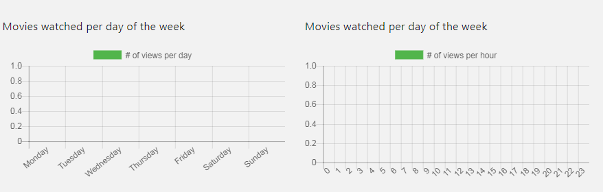

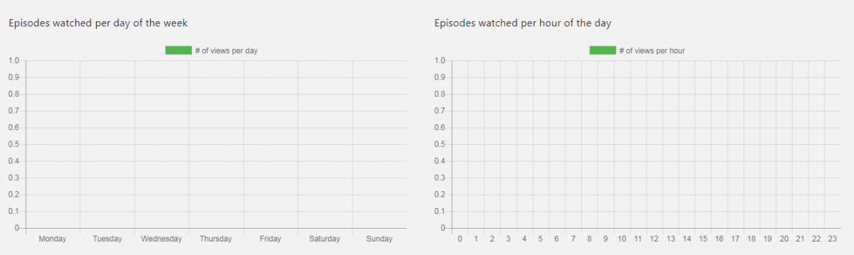

OKDaG 1 Posted August 17, 2017 Posted August 17, 2017 Hi, plugin is working so far here, but the graphs are empty?Emby: Version 3.2.27.0 (running on Ubuntu 16.04) Statistics Plugin Version: 1.1.6432.18254 How to fix this? Best Regards, Stefan 1
reggi 415 Posted August 17, 2017 Author Posted August 17, 2017 @@OKDaG Thanks for posting this bug, it has been mentioned before and I'm still working on getting data on the graphs. Normally all new movies you watch will populate the graphs.
reggi 415 Posted August 17, 2017 Author Posted August 17, 2017 I uploaded a new version for Beta servers with a new layout. Feel free to give feedback! As for the graphs, still don't know why they are empty in the beginning for some users.
PenkethBoy 2068 Posted August 17, 2017 Posted August 17, 2017 @@reggi Like the new "pictures" in the stats - will these be hyperlinks at some point to jump to the movie or show? I hope we can have movie-based statistics soon as well One minor thing "Studio" count for both movies and Shows are both zero
CBers 7558 Posted August 17, 2017 Posted August 17, 2017 I've updated to v1.1.6438.18531, reran the scheduled task, but the graphs are still blank. I'll leave you with it
