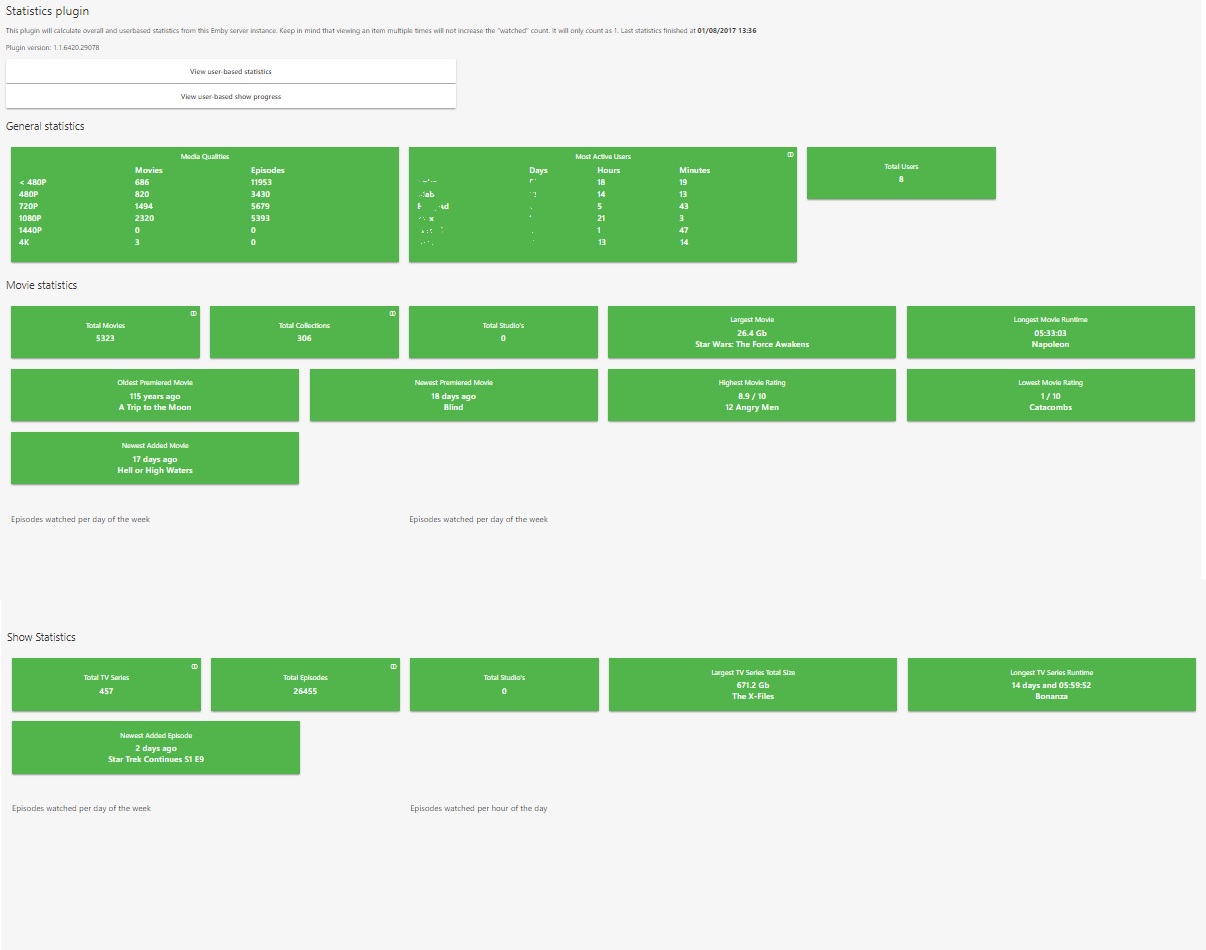

Guest Posted July 31, 2017 Posted July 31, 2017 Hello everyone, I would like to know two things: 1. Is it possible to list the selected movies by resolution? I have several movies with resolution up to 480p and would like to have print the list to delete from my library. 2. Is it possible to translate plugin titles? I could translate it into Brazilian Portuguese and share. Thank you
Dibbes 515 Posted August 1, 2017 Posted August 1, 2017 @@reggi, not sure if this was reported already, but it seems I'm missing some stats here: 1. Is it possible to list the selected movies by resolution? I have several movies with resolution up to 480p and would like to have print the list to delete from my library. I also really love this suggestion! And last, superb work here! Thanks

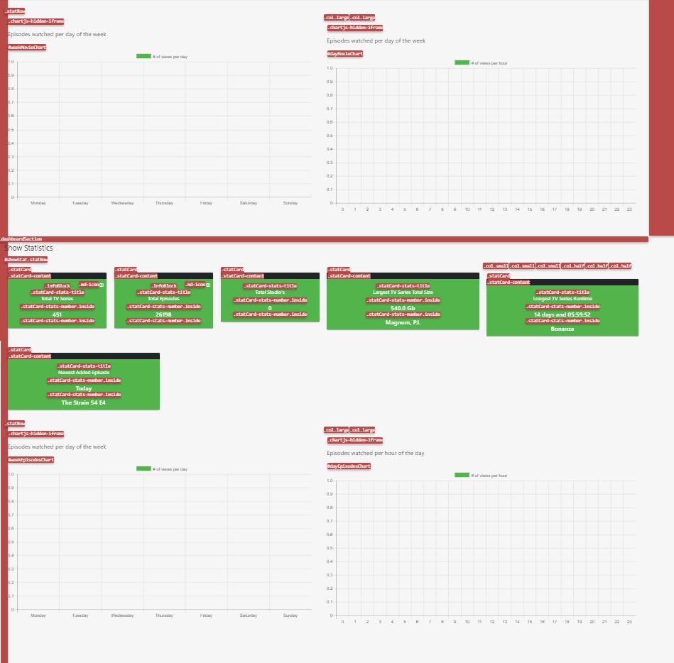

reggi 415 Posted August 6, 2017 Author Posted August 6, 2017 (edited) Thanks for all the ideas for updating the plugin with new stats, I'll do my best to include them all. But first I need to fix the graphs, my own live server is down at the moment and on my test server the graphs are working I'll keep you all posted!! EDIT @@Dibbes, @@PenkethBoy, @@CBers Can you guys check if you open the developer tools in chrome if there is an error loading a script? Maybe that's the problem. Are you guys running on http or https? Edited August 6, 2017 by reggi

Dibbes 515 Posted August 7, 2017 Posted August 7, 2017 (edited) @@reggi, with the latest version the graphs load, but aren't populated: Plugin verion: 1.1.6427.39626Server Version 3.2.26.0 A cosmetic thing, but you may want to Episodes for series only and there's an "s" missing in the version string EDIT: I'm using plain http, no certificates etc. Edited August 7, 2017 by Dibbes
