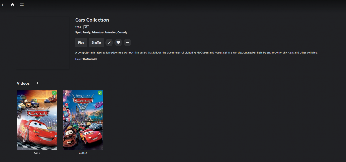

markdj 49 Posted January 3, 2019 Author Posted January 3, 2019 Well, I've updated Emby Server to the latest beta and I thought collections would be fixed but I have a lot of missing and incomplete collections still. Cars contains just Cars 1 and 2. If I add 3 to it nothing happens, nor is it automatically added in the first place (even though the data is correct). Amazing Spider-Man also doesn't have a collection. I have quite a few more and I've tried resetting, deleting the database, uninstalling and reinstalling the collections plug-in, et cetera, but nothing helps.

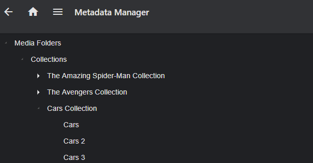

markdj 49 Posted January 3, 2019 Author Posted January 3, 2019 Ok, so I removed everything in the collections foider and let it rescan with the boxsets plug-in. Problem remains. However I do notice it's processed via the Metadata Manager, it just doesn't get added to the actual collection (see attachments).

markdj 49 Posted January 3, 2019 Author Posted January 3, 2019 I would, but it's 248MB. Sounds pretty huge, or is this normal? Also, the entry has different data (local paths instead of IP, see screenshot). It also doesn't have any indexes this way.
Luke 42216 Posted January 3, 2019 Posted January 3, 2019 What do you mean entry has different data? different data from what?
markdj 49 Posted January 3, 2019 Author Posted January 3, 2019 (edited) As you can see on the screenshot Cars 3 uses local path instead of an IP path. Also it doesn't have any external ID's, at all. To be clear: this is only with Collections in the Metadata Manager. In the regular interface (and in the Movies part of Metadata Manager) it's actually correct. Edited January 3, 2019 by markdj
