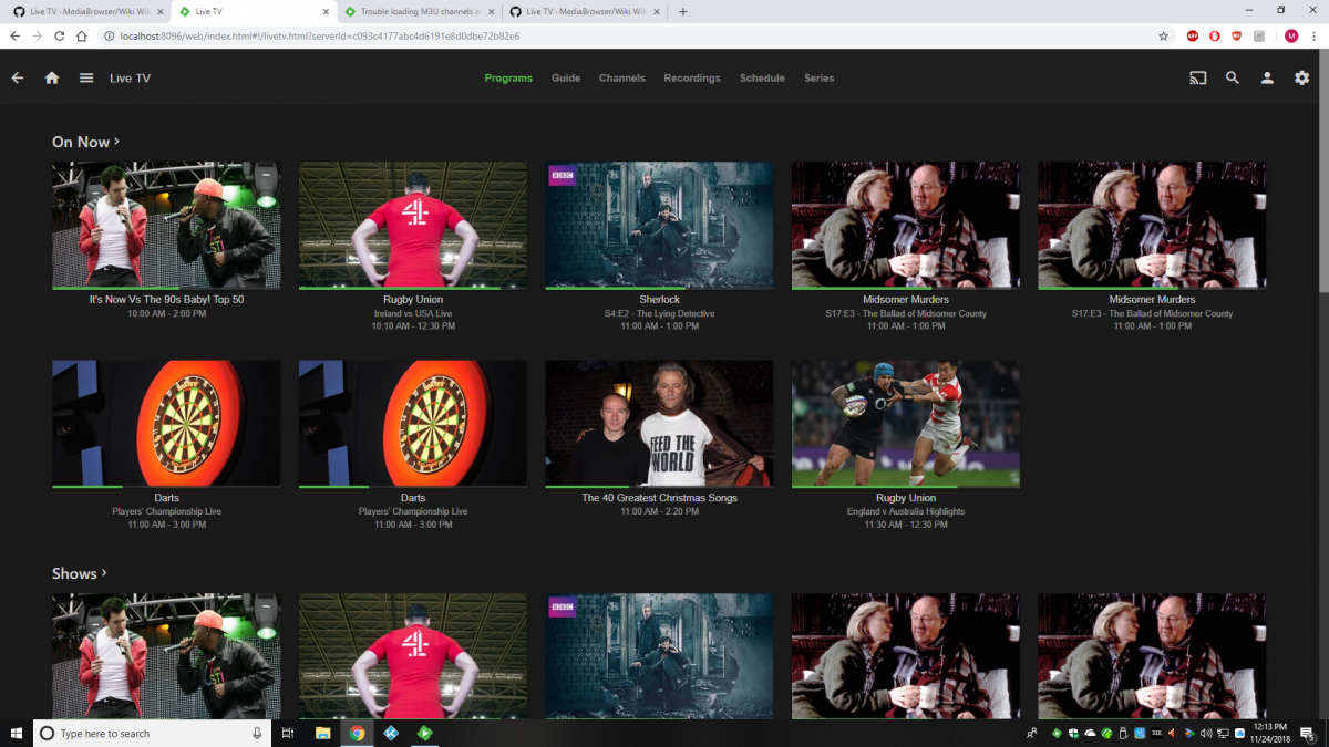

crawfordmd 0 Posted November 24, 2018 Author Posted November 24, 2018 (edited) So I was able to successfully complete the "refresh guide" task and when I click on Live TV, the "Programs" sections loads. However, none of the other sections populate. I have tried this in the Web app and Emby Theater and neither populate.Additionally, I tried it on the Emby for Nvidia Shield app and it loaded the "on Now" section; however there was an "Error loading Guide" prompt when I selected the "guide" section and no channels loaded in the "Channels" section. Is there a setting I am missing? Edited November 24, 2018 by crawfordmd

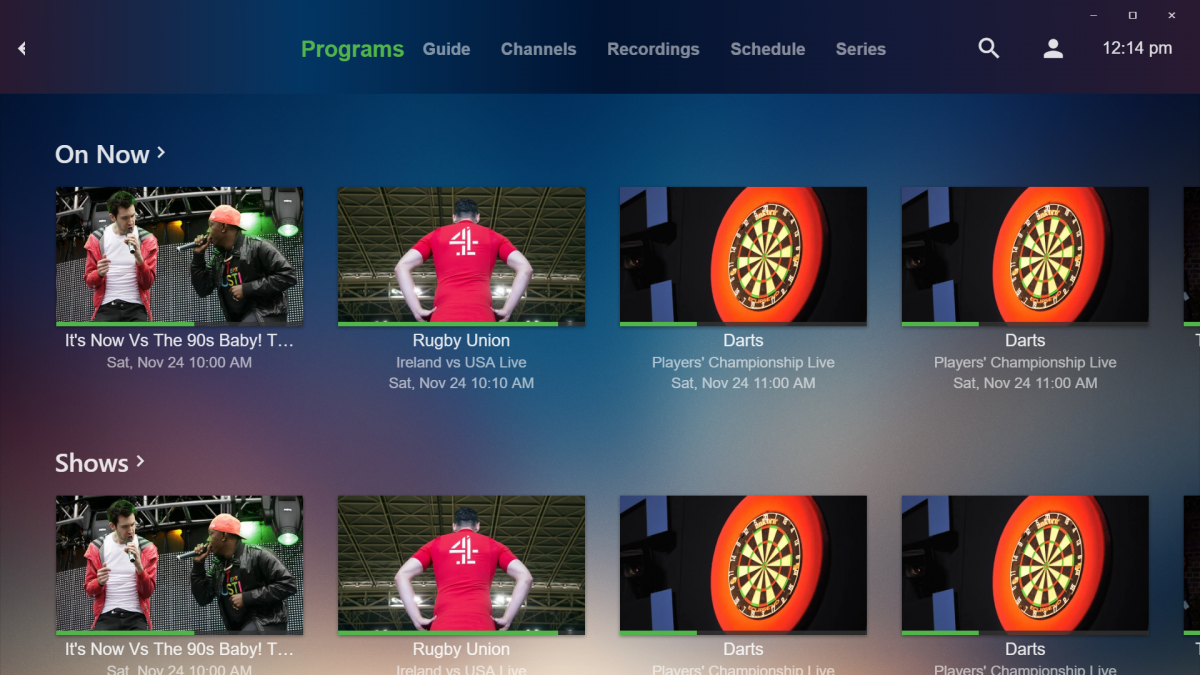

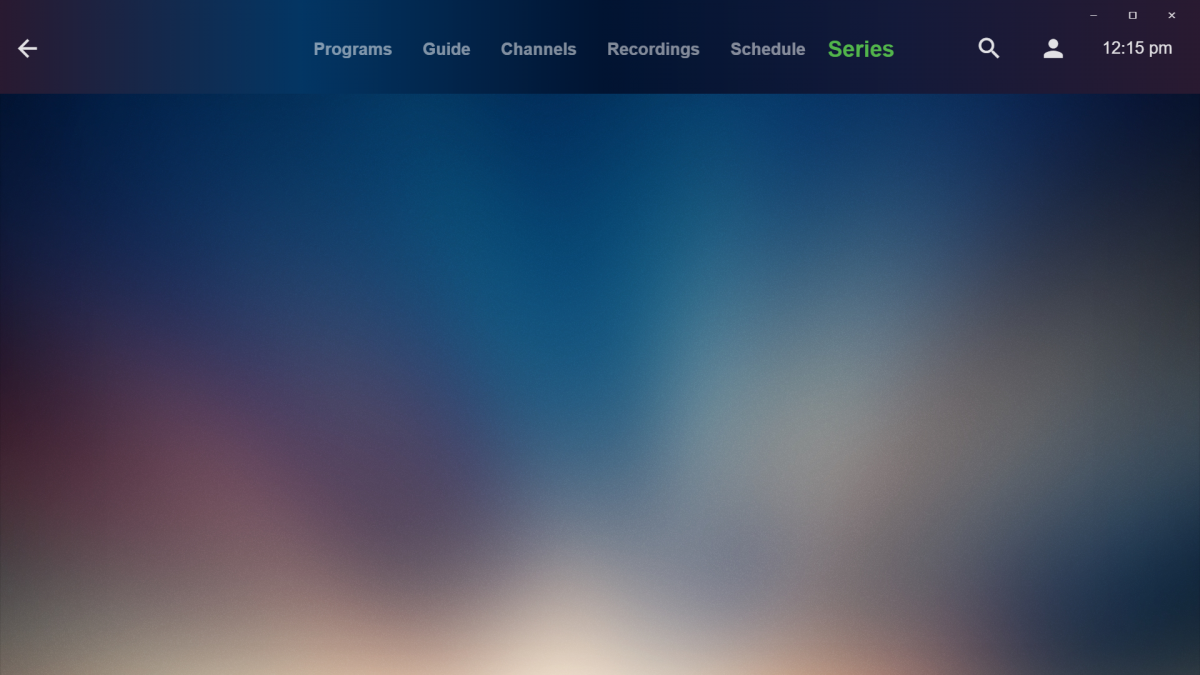

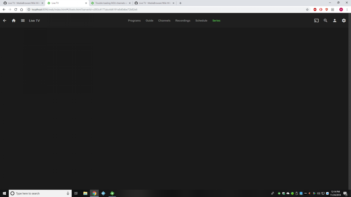

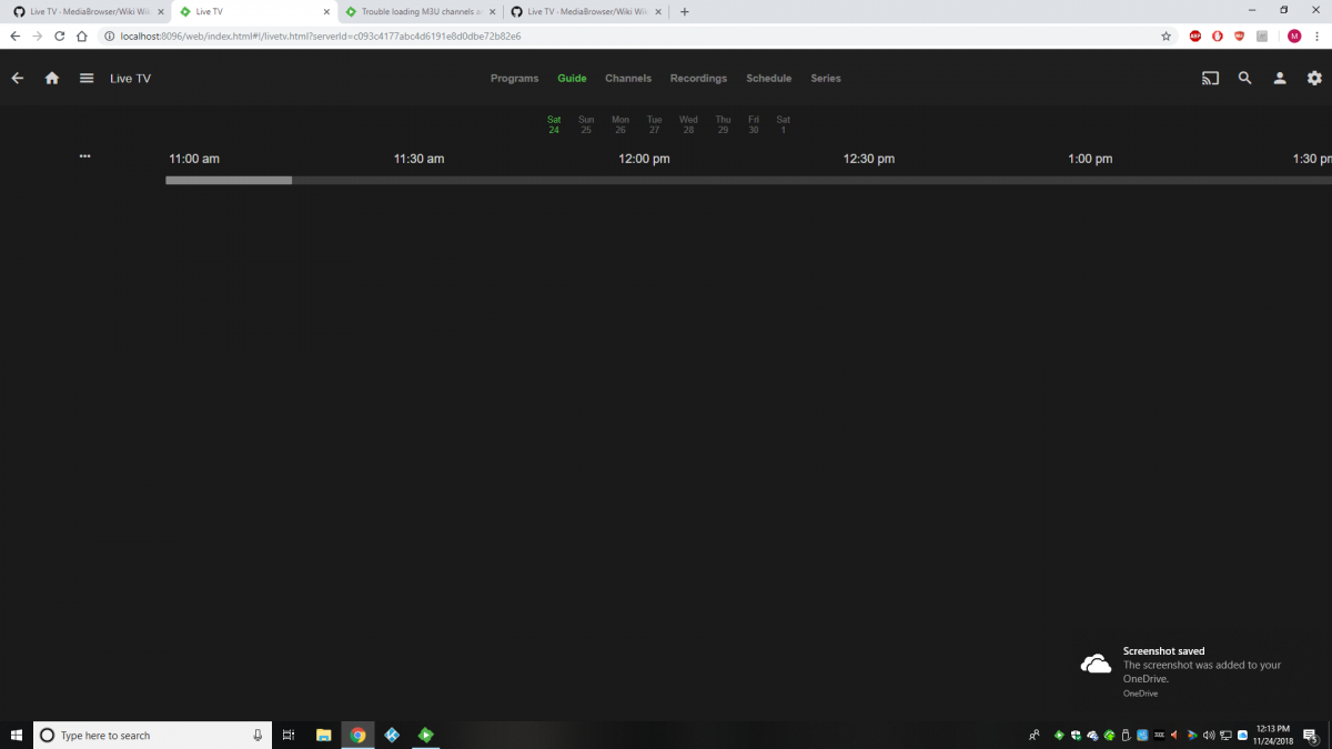

crawfordmd 0 Posted November 24, 2018 Author Posted November 24, 2018 On Emby Premier and Emby Web App: - "Programs" section loads - Guide, Channels, Schedule, and Series do not load On Emby app for Nvidia Shield: - "On Now" and "Upcoming" sections load - Guide and Channels do not load Would you like me to upload screen shots?
crawfordmd 0 Posted November 24, 2018 Author Posted November 24, 2018 Here are captures from Emby web app and Emby Theater. Are there any other screen captures or logs that you would like me to grab?
Luke 42244 Posted November 24, 2018 Posted November 24, 2018 well do you even have any recordings, schedules or series? so those should be empty, right? its' just channels and the guide that are missing.
crawfordmd 0 Posted November 24, 2018 Author Posted November 24, 2018 (edited) Correct...still in the setup phase of things here. I did not expect anything to be in the recordings, schedules or series sections and just wanted to make sure I showed you what I am seeing here. Edited November 24, 2018 by crawfordmd
Solution Luke 42244 Posted November 24, 2018 Solution Posted November 24, 2018 have you setup any parental control for this emby user? 1
crawfordmd 0 Posted November 24, 2018 Author Posted November 24, 2018 That was it! In my desire to set parental controls so my children wouldn't stumble upon content they shouldn't be seeing, it appears that it filters out all the IPTV channels. The channels and guide sections loaded properly. Is there a good guide for grouping channels from IPTV services? Thank you again for your assistance! Your support is what continues to give Emby a good reputation!
