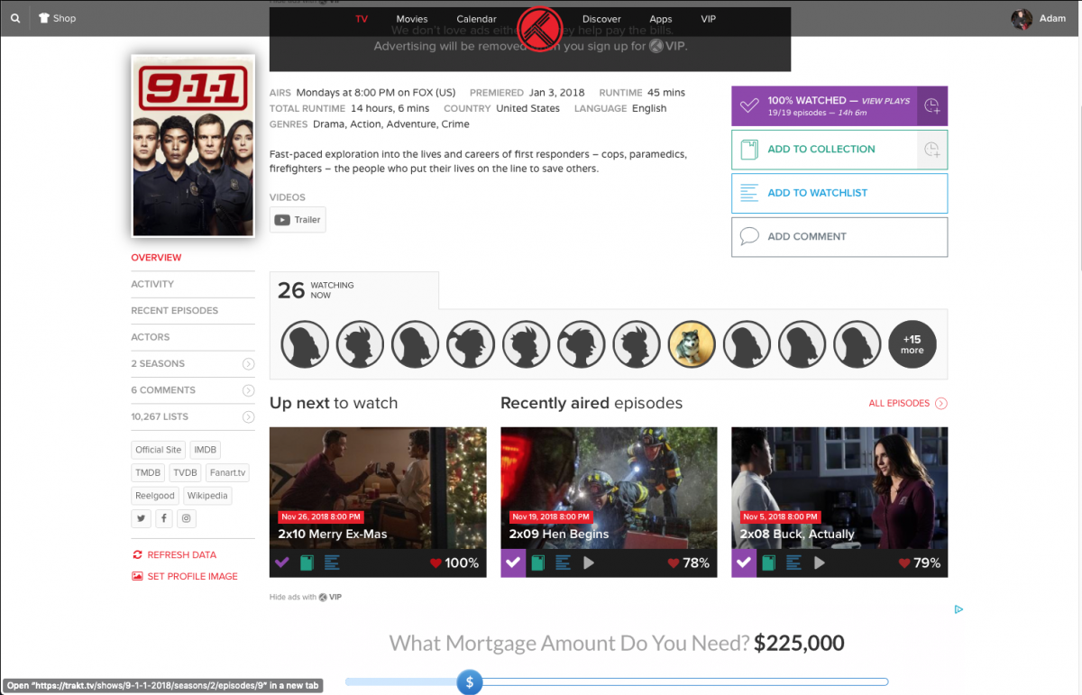

snodrog742 34 Posted November 26, 2018 Posted November 26, 2018 We're having same issue. Enabled Debugging for both as you suggested. Username same as here. Show "9-1-1" episode "Hen Begins" shows Watched on Trakt but not being imported to Emby as Watched Log-4.txt
