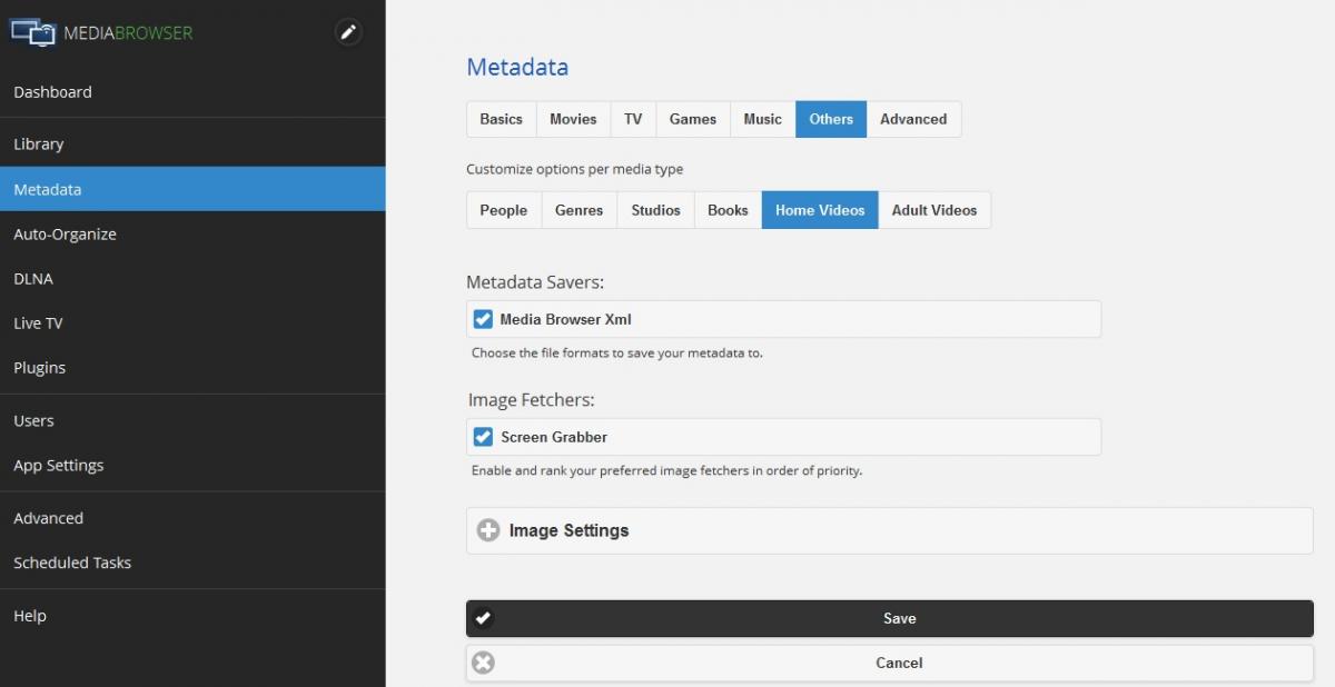

ebr 16354 Posted April 21, 2014 Posted April 21, 2014 Also would it be great to turn off fetching movies on the internet for certain mediatypes (or is that already the case?) That is already possible. Look at metadata settings.
Hedwig 1 Posted April 21, 2014 Posted April 21, 2014 Where can I find that switch? Sorry but i don't see it...
ebr 16354 Posted April 21, 2014 Posted April 21, 2014 Home Videos don't have any internet fetchers so there is nothing to turn off.
