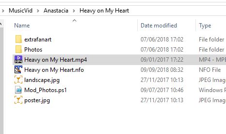

PenkethBoy 2068 Posted October 17, 2018 Posted October 17, 2018 Thats not what i see /artistname/videoname/videofile - works fine with the musicvideo library type works for stable and beta server - although the presentation has changes in beta to a more functional layout

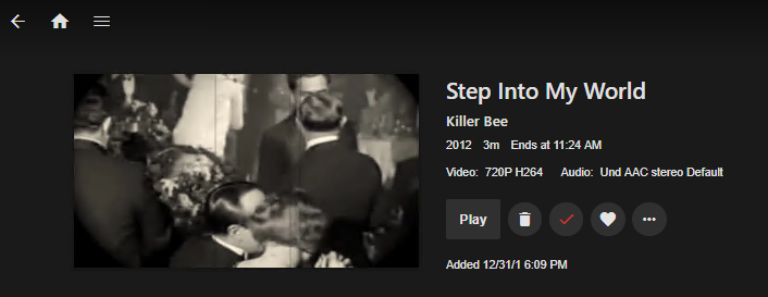

Lyfesaver 134 Posted October 17, 2018 Posted October 17, 2018 When importing: Tape Five - Step Into My Time Machine I get:
Lyfesaver 134 Posted October 17, 2018 Posted October 17, 2018 That image says the song is Killer Bee - Step Into My World, not Tape Five - Step Into My Time Machine. I was just showing my results with my naming not matching the requirements is all. It's not the right song and I would have thought there would be more metadata about the song there. Kind of like how Music does.

PenkethBoy 2068 Posted October 18, 2018 Posted October 18, 2018 been working for me for many months on both Beta and Stable I dont include the artistname in the MV file name as thats already part of the path Other ways may well work 1

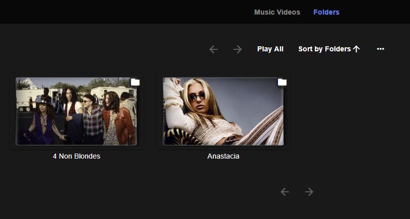

VaporTrail 66 Posted October 22, 2018 Posted October 22, 2018 @@PenkethBoy Can you please share a screenshot of your Music Videos displayed within Emby beta? I'm curious as to the more functional layout.
PenkethBoy 2068 Posted October 22, 2018 Posted October 22, 2018 MV home page has two tabs Videos - all videos - similar to movies Folders - folders view - depends how you have your videos organised as to how many levels you have both have sorting/filtering options Its not a major change but Luke has said more functionality will come in time 2
