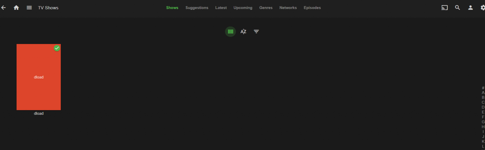

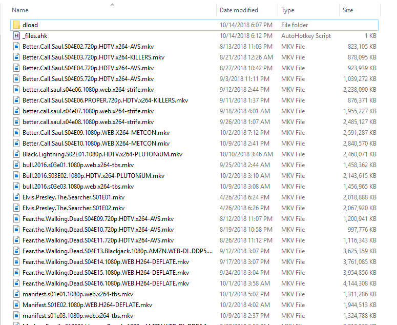

dejo78 0 Posted October 14, 2018 Author Posted October 14, 2018 OK so what am I doing wrong here? I eliminated all the subfolders and all my mkv episodes are in the main TV folder I have dload folder and that is where my new episodes will be before mkv files are transferred to the main TV folder. I've tried to Scan Library (TV folder) and then Auto Organize but all I get is this
Luke 42216 Posted October 14, 2018 Posted October 14, 2018 You can't point auto-organize to a folder that is already imported into Emby. That is not supported. The whole idea is that you point it to a folder that is not yet in Emby.

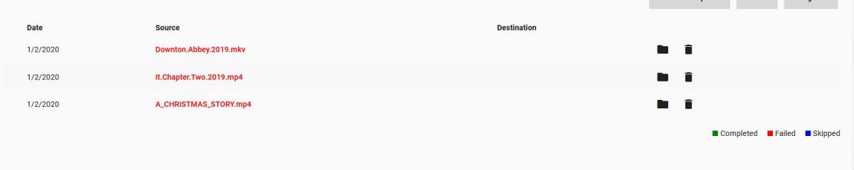

zachattack83 3 Posted January 1, 2020 Posted January 1, 2020 This plug in seems to be very unclear on how its supposed to do what its supposed to do.I created a folder called "staging", and moved one of my movies from my emby movie library folder to it.It didn't rename it, or anything. It just said it was completed, but nothing changed.I then moved another one over, and it failed to work. When I manually tried to set it to movie, it wanted me to select a movie from within my emby libraries.So I guess I am confused on how and what this app is supposed to actually do. I thought it would auto rename all my files and folders so they have some uniformity to them, but I am not seeing that happen.

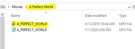

zachattack83 3 Posted January 1, 2020 Posted January 1, 2020 Photos are showing, that the Auto organize app is claiming the destination will be "/mnt/Emby/Movies/1993 A Perfect World/A Perfect World.mp4"But what the actual is showing, is that its not. It did not add the date, or rename the file.
Luke 42216 Posted January 1, 2020 Posted January 1, 2020 Photos are showing, that the Auto organize app is claiming the destination will be "/mnt/Emby/Movies/1993 A Perfect World/A Perfect World.mp4" But what the actual is showing, is that its not. It did not add the date, or rename the file. Server log?
zachattack83 3 Posted January 2, 2020 Posted January 2, 2020 I attached the one that is most current.Not only is it not updating the folders and files, its also failing on every movie in the staging folder, that is not already ALSO in the Emby movie library folder.Is it required by the plug in to have these things located in 2 places? I do not follow the logic in this if so.

zachattack83 3 Posted January 2, 2020 Posted January 2, 2020 ya sorry, forgot to click the "attach this file" button.What I mean is, The perfect world movie, that I linked earlier. If I don't have a copy of that already in the "Movies" folder, then the auto organize won't be able to recognize it in the "staging" folder, and it comes back as failed.So, if I have the movies I want organized in the staging folder, it won't organize them unless they have another copy of themselves in the movies folder. Not sure why it is doing this, but it is failing everything that I dont have a copy of in the other folder. embyserver_1949_01012020.txt
Luke 42216 Posted January 2, 2020 Posted January 2, 2020 ya sorry, forgot to click the "attach this file" button. What I mean is, The perfect world movie, that I linked earlier. If I don't have a copy of that already in the "Movies" folder, then the auto organize won't be able to recognize it in the "staging" folder, and it comes back as failed. So, if I have the movies I want organized in the staging folder, it won't organize them unless they have another copy of themselves in the movies folder. Not sure why it is doing this, but it is failing everything that I dont have a copy of in the other folder. This is your problem, server being denied write access to transfer the files: 2020-01-01 17:30:21.660 Error App: Failed to move file from /mnt/Emby/Staging/The Shawshank Redemption (1994) [1080p]/The.Shawshank.Redemption.1994.1080p.x264.YIFY.mp4 to /mnt/Emby/Movies/The.Shawshank.Redemption.1994.1080p.BluRay.x264.anoXmous/The.Shawshank.Redemption.1994.1080p.BluRay.x264.anoXmous_.mp4: Access to the path is denied. *** Error Report *** Version: 4.3.1.0 Command line: /mnt/md1/application/emby-server/system/EmbyServer.dll -programdata /home/emby -ffdetect /usr/local/emby-server/bin/ffdetect -ffmpeg /usr/local/emby-server/bin/ffmpeg -ffprobe /usr/local/emby-server/bin/ffprobe -defaultdirectory /mnt -updatepackage emby-server-terramaster_{version}_x86_64.tar.xz Operating system: Unix 4.13.16.0 64-Bit OS: True 64-Bit Process: True User Interactive: True Runtime: file:///mnt/md1/application/emby-server/system/System.Private.CoreLib.dll Processor count: 2 Program data path: /home/emby Application directory: /mnt/md1/application/emby-server/system System.UnauthorizedAccessException: System.UnauthorizedAccessException: Access to the path is denied. ---> System.IO.IOException: Operation not permitted --- End of inner exception stack trace --- at Interop.ThrowExceptionForIoErrno(ErrorInfo errorInfo, String path, Boolean isDirectory, Func`2 errorRewriter) at Interop.CheckIo(Int64 result, String path, Boolean isDirectory, Func`2 errorRewriter) at System.IO.FileSystem.CopyFile(String sourceFullPath, String destFullPath, Boolean overwrite) at System.IO.File.Copy(String sourceFileName, String destFileName, Boolean overwrite) at Emby.Server.Implementations.IO.ManagedFileSystem.CopyFile(String source, String target, Boolean overwrite)

zachattack83 3 Posted January 2, 2020 Posted January 2, 2020 (edited) ls -l /mnt/Emby/Moviesdrwxrwxrwx+ 1 emby emby 96 Jan 1 20:26 '1993 A Perfect World'It looks like it did have the ability to move it over, but it doesn't seem to want to do anything, unless a copied version of the stuff already exists within the emby folder? 2020-01-02 02:50:52.535 Info App: Sorting file /mnt/Emby/Staging/A Christmas Story/A_CHRISTMAS_STORY.mp42020-01-02 02:50:52.537 Warn App: Unable to find movie in library matching name A_CHRISTMAS_STORY.mp4Why does it need to find a movie matching the name in the library if it is going to move the movie there? Edited January 2, 2020 by zachattack83
Luke 42216 Posted January 2, 2020 Posted January 2, 2020 ls -l /mnt/Emby/Movies drwxrwxrwx+ 1 emby emby 96 Jan 1 20:26 '1993 A Perfect World' It looks like it did have the ability to move it over, but it doesn't seem to want to do anything, unless a copied version of the stuff already exists within the emby folder? 2020-01-02 02:50:52.535 Info App: Sorting file /mnt/Emby/Staging/A Christmas Story/A_CHRISTMAS_STORY.mp42020-01-02 02:50:52.537 Warn App: Unable to find movie in library matching name A_CHRISTMAS_STORY.mp4Why does it need to find a movie matching the name in the library if it is going to move the movie there? It doesn't need to be there. It looks like it has permissions to overwrite the file if it is already there, but not to create a new one. This is something you'll need to resolve.
zachattack83 3 Posted January 2, 2020 Posted January 2, 2020 In the pictures attached, you can see what weirdness is going on.It does not seem that permissions are the actual issue, despite it triggering that time.If I manually go through auto organize, and select the movie in the library that this one represents, it will do what it is supposed to do. It creates the folder and renames the movie.However, if the movie is not in the list to select from, it will not allow it to work.So, one of the issues is that the auto organize, is struggling to detect what the movie is. I am not sure how it attempts to do this, because emby itself has no issue finding out the metadata for the same movie.The other issue is, that if there is no version of the same movie existing in the library folder, it will not allow the movie to be organized.Also, when doing this, (photo 6), it does not remove the other existing movie, it just creates a copy of it into the library, and you end up with 2 of the same movie.
