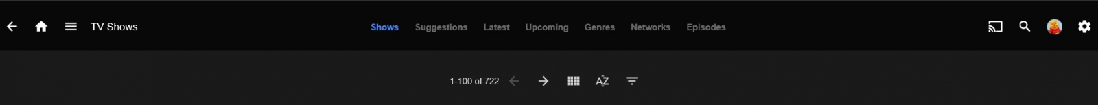

TastyPomme 7 Posted October 14, 2018 Posted October 14, 2018 Have installed Report Plugin 1.0.15 on Version 3.5.3.0 But it seems to be broken and not displaying properly See attached file 1

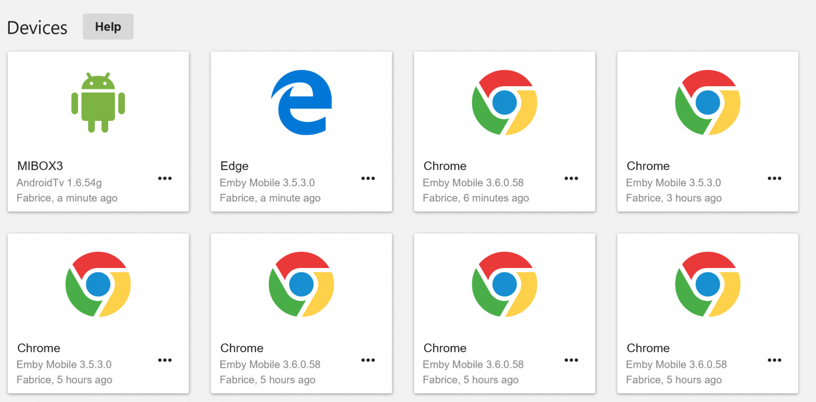

TastyPomme 7 Posted November 1, 2018 Author Posted November 1, 2018 (edited) So the issue is because at some point I moved to Emby Beta and then moved back to a stable release Chrome still considers I am on the beta version and can't display properly the reports page Have uninstalled Chrome, cleared its cache, Incognito mode, signed out and deleted the servers but nothing helps Any solution at Chrome or Emby level? Edited November 1, 2018 by Fabrice1973
Happy2Play 9814 Posted November 1, 2018 Posted November 1, 2018 So the issue is because at some point I moved to Emby Beta and then moved back to a stable release Chrome still considers I am on the beta version and can't display properly the reports page Have uninstalled Chrome, cleared its cache but nothing helps Any solution at Chrome or Emby level? If you are signing in to app.emby.media you always see this as the online web app is 99% of the time ahead of the stable release.

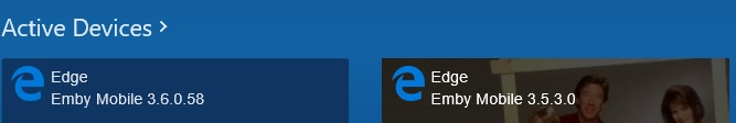

Happy2Play 9814 Posted November 1, 2018 Posted November 1, 2018 (edited) Yes I read... but I have reasons to believe this is not the issue. On Edge, it does show the current version whenever I use it. Once it displays the Beta server on Chrome, I have the report bug from my first post. How are you connecting to your server in Edge and Chrome? Everyone gets the same thing, first one is via app.emby.media and second is via wanip/ddns. Also the Devices list really means nothing when you are talking about a browser. It just means at some point you connected to the version number. Edited November 1, 2018 by Happy2Play
TastyPomme 7 Posted November 1, 2018 Author Posted November 1, 2018 Thanks - Now that makes sense So whenever I log to the server through the app.emby.media URL the report display is broken But is fine if I fill in the server IP in the URL bar of Chrome
Happy2Play 9814 Posted November 1, 2018 Posted November 1, 2018 (edited) Thanks - Now that makes sense So whenever I log to the server through the app.emby.media URL the report display is broken But is fine if I fill in the server IP in the URL bar of Chrome No it is not broken, as the online version is using updated code passing through to your server. So you will see differences in ui and settings. Edited November 1, 2018 by Happy2Play

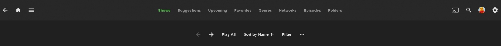

Happy2Play 9814 Posted November 1, 2018 Posted November 1, 2018 (edited) Some differences local/ip app.emby.media (changes coming in next release) Edited November 1, 2018 by Happy2Play
TastyPomme 7 Posted November 1, 2018 Author Posted November 1, 2018 But then Report shouldn't be available in the app version if it doesn't work Or is it only broken for me?
Luke 42254 Posted November 1, 2018 Posted November 1, 2018 The online web app is a little ahead of your server version. This will be resolved following the next release of the server. Workaround for now would be to use your local web app. Thanks.
